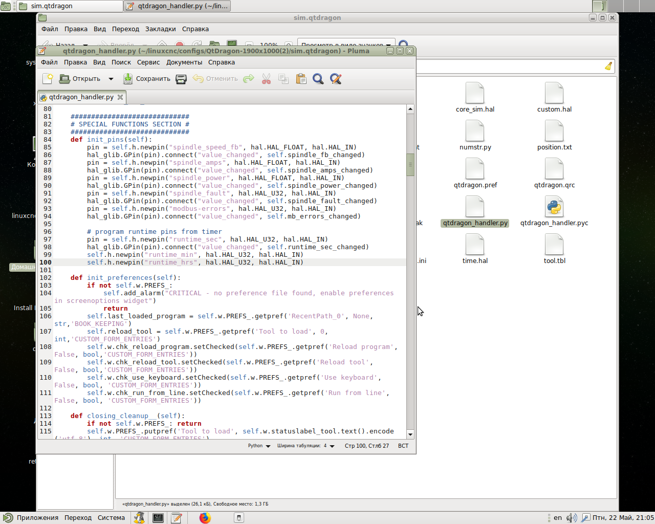

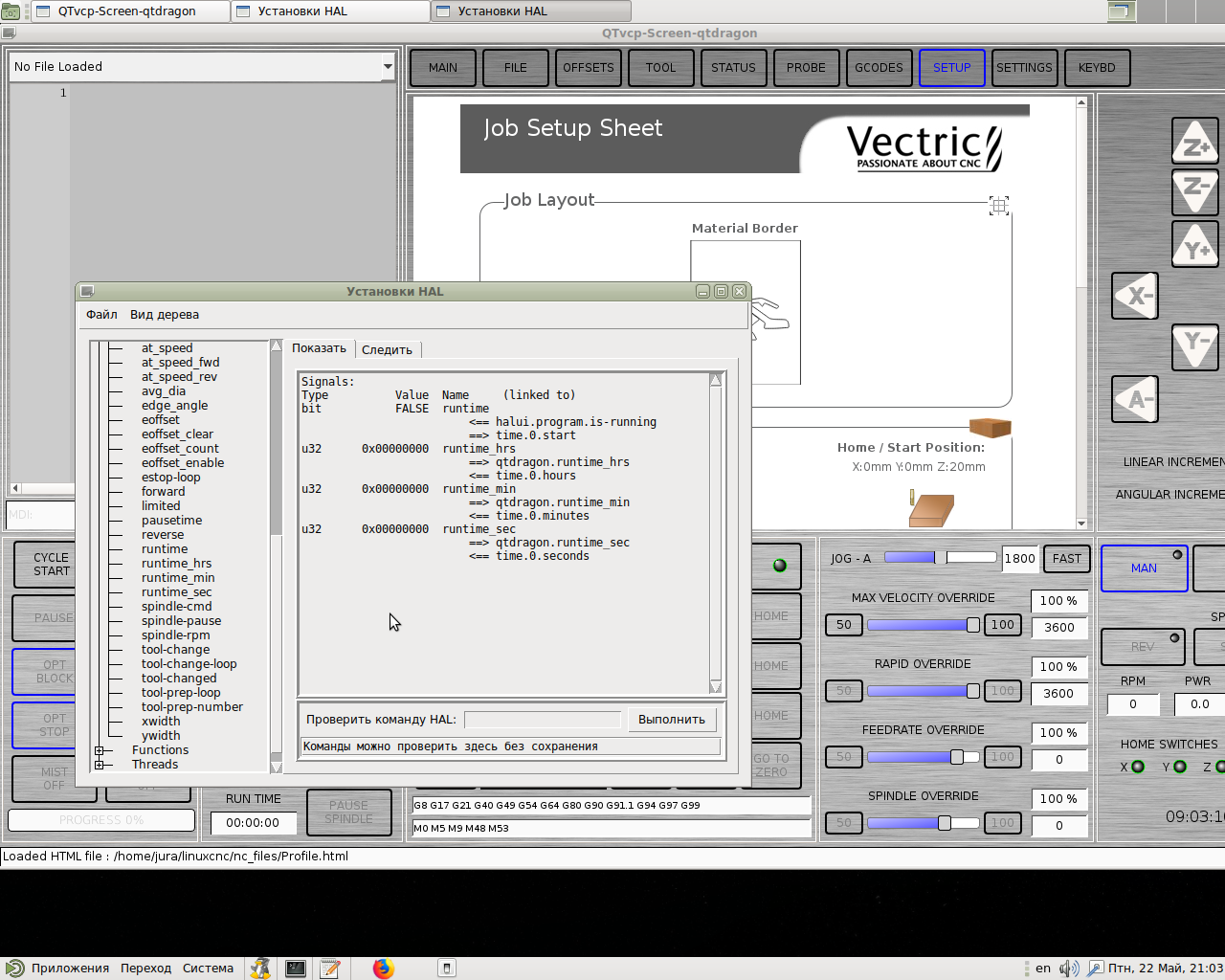

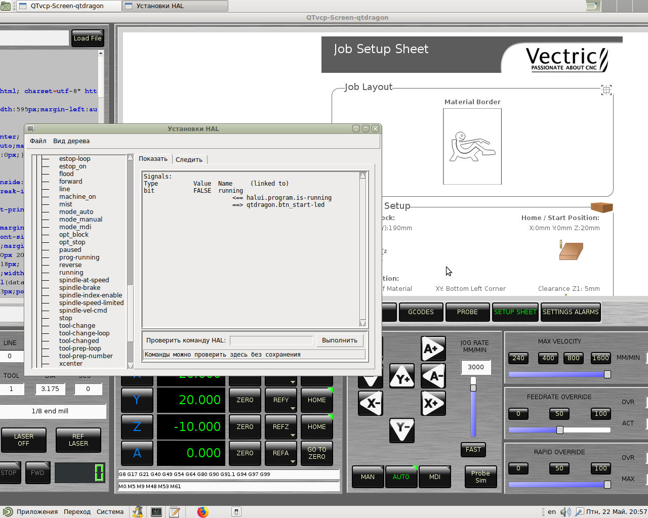

With html all ok! Help please connect Run Time. I can not get signal how in
QtDragon master.
QtDragon master.
- persei8
- Posts: 399
- Thank you received: 133
22 May 2020 17:38 #168609
by persei8
Replied by persei8 on topic Preference File
In your postgui hal file, you need:
loadrt time
addf time.0 servo-thread
then connect the signals:
#program runtime
net runtime time.0.start <= halui.program.is-running
net pausetime time.0.pause <= halui.program.is-paused
net runtime_sec qtdragon.runtime_sec <= time.0.seconds
net runtime_min qtdragon.runtime_min <= time.0.minutes
net runtime_hrs qtdragon.runtime_hrs <= time.0.hours
loadrt time
#program runtime
- hottabich
- Posts: 574
- Thank you received: 96
23 May 2020 10:24 #168691
by hottabich
Replied by hottabich on topic Preference File
I did this and got an error. Start and pause have been already linked to start led and pause led. With your help, I understood, fixed it and now everything works. Thank you and my respect to you!

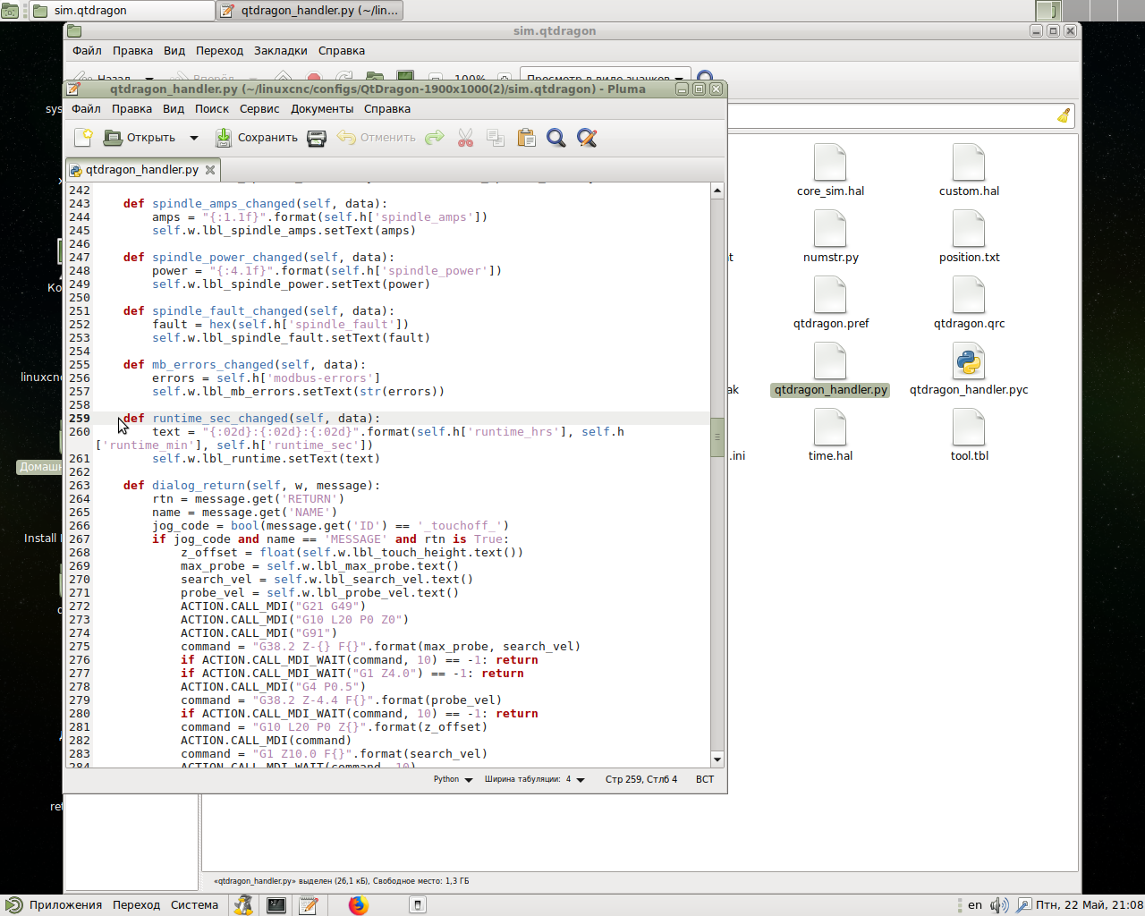

- Posts: 7368
- Thank you received: 2181
23 May 2020 16:56 #168726
I think this is something you should consider programming into the handler file rather then make users connect HAL pins for.
using STATUS to catch running and pausing and STATUS update to cause the time display widget to update.
Replied by cmorley on topic Preference File
loadrt time
#program runtime
- persei8
- Posts: 399
23 May 2020 20:10 #168753
by persei8
I guess I can't see the forest for the trees. By 'time display widget' do you mean the timestamp statuslabel? I already have one for displaying the clock. What is the exact signal name for STATUS update? There's no such thing as :
STATUS.connect('update', etc)
