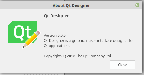

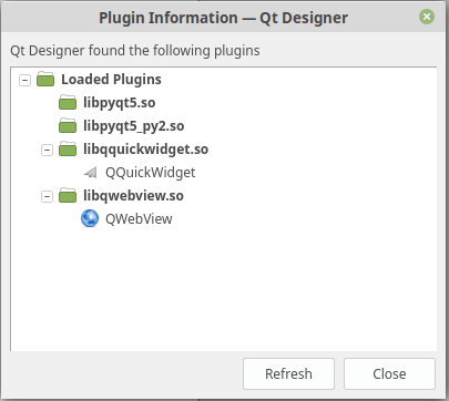

19 Apr 2020 05:31 #164589
Replied by cmorley on topic Installing QtVCP
open designer.
click help, click plugins.
see if something close to libpyqt5.so is there. Might be libpyqt5_py2.so

19 Apr 2020 06:44 #164601
by Bruedney
Replied by Bruedney on topic Installing QtVCP
- Posts: 7368
- Thank you received: 2181
19 Apr 2020 08:13 #164607
ok run from a terminal:
designer -qt=5
See if it prints anything interesting (post it here please)
designer -qt=5
