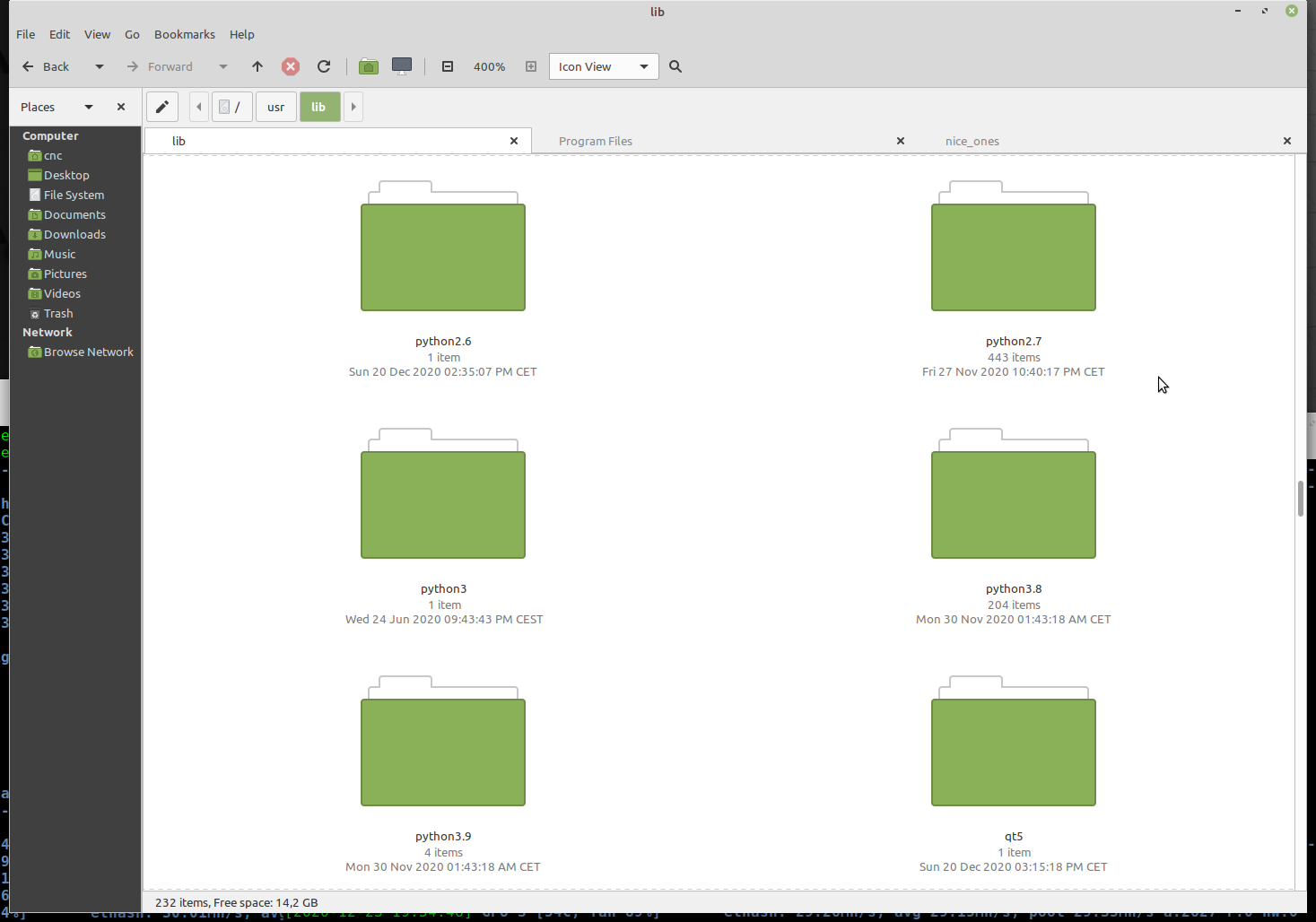

Replied by tommylight on topic Jerky Jogging (QTPlasmaC)
Yup, had a run at it also, but to no avail. This is the state of Python on my main PC after a night of trying to get thins going:I have found that different distros may install qt in directories different from what pyqt expects. Sometimes, you need to figure out where python is searching for it's libraries. No doubt a huge PITA but not necessarily qt's fault.
