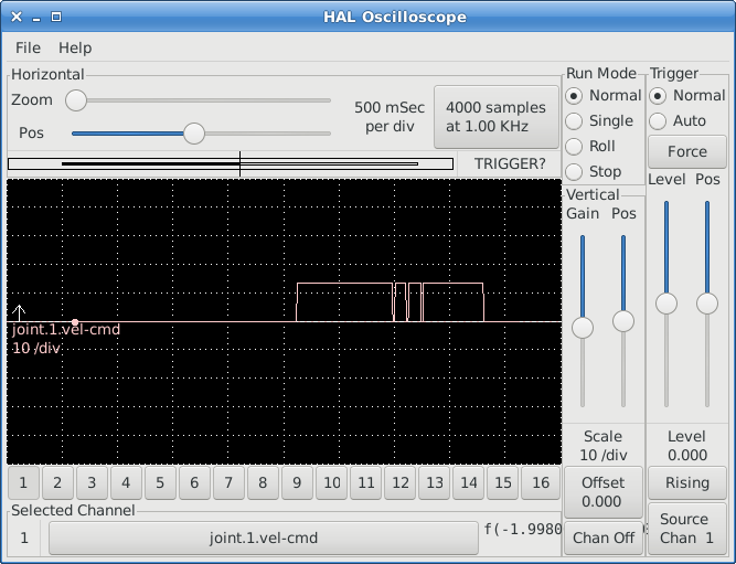

if the problem shows in screen jogging and keyboard jogging, then I would be surprised if repeat was the real problem.

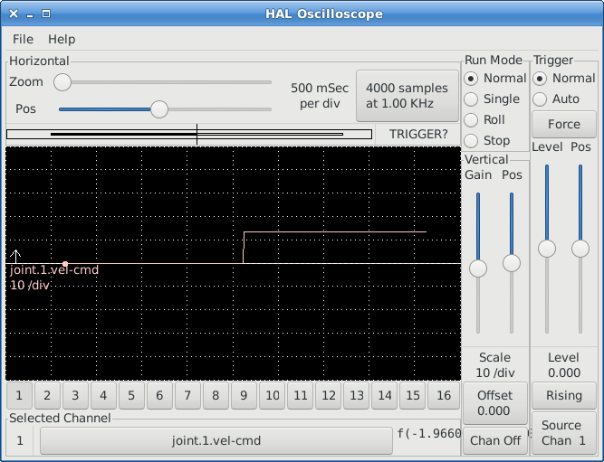

I am not 100% sure but I am fairly certain it is only keyboard. I haven't used it on a real machine, only a sim. Greg mentioned it to me after he tried it on his machine. The two plots are from a sim.

This is sounding like what we are seeing:
stackoverflow.com/questions/38102221/qke...torepeat-not-working
I haven't tried their fix yet

Yes, that ldoes look very similar. I did some plots on qtaxis and it is the same, then I added a few prints in qt_makegui.py and it does seem that the issue is with Qt's isAutoRepeat function.

Yes that is correct, only keyboard jog is wonky (I believe you guys got there just wanted to confirm).
The thing that makes me think the link Chris posted is on to something about something taking over keyboard focus is the fact that keyboard jogging on the parameters tab seems to work fine.
It’s only when the main tab is active does keyboard jogging go crazy.
