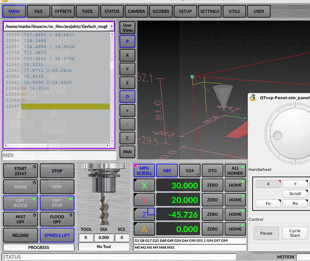

I had to copy the files to /usr/share because it was starting with errors in the machine's directory.
In /usr/share it works fine.
A very cool functionality could be with MPG. I currently don't have physical MPG.
I wanted to run the virtual MPG sim_panel but it doesn't want to work, so I haven't tested how it works yet.

What didn't work with sim_panel?
I used thwsw command after qtdragon started in another terminal:
qtvcp sim_panel &
halcmd net MPG qtdragon.mpg-in sim_panel.MPG-s
qtvcp sim_panel &

ok, I missed this "halcmd net MPG qtdragon.mpg-in sim_panel.MPG-s"

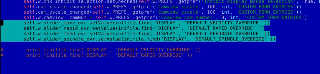

I like the "max velocity slider" slider, but it should immediately limit all speeds, including manual movements, but it does not limit manual movements.
I added 4 lines to the handler file, as in the screenshot. Only the first slider setting "MAX_VELOCITY_OVERRIDE" works, I don't know why the other slider settings don't work.
ps. I'm working on a more extensible qtdragon. I will upload the file soon.
It will be possible to stretch it to 4K (3840x3840), it doesn't look very nice at such a high resolution, but it is possible.

Try adding this function:
def before_loop__(self):
# set defaults lower then max if wanted
DEFAULT_RAPID_OVERRIDE = float(INFO.get_error_safe_setting("DISPLAY", "DEFAULT_RAPID_OVERRIDE", .5)) * 100
ACTION.SET_RAPID_RATE(DEFAULT_RAPID_OVERRIDE)
DEFAULT_VELOCITY_OVERRIDE = float(INFO.get_error_safe_setting("DISPLAY", "DEFAULT_MAX_VELOCITY", 1800))
ACTION.SET_MAX_VELOCITY_RATE(DEFAULT_VELOCITY_OVERRIDE)

Thanks, it works fine this way.
I only changed the settings for "max_velocity_override" so that it took the max speed from the "MAX_LINEAR_VELOCITY" value
FACTOR_VELOCITY_OVERRIDE = float(INFO.get_error_safe_setting("DISPLAY", "DEFAULT_VELOCITY_OVERRIDE"))
DEFAULT_VELOCITY_OVERRIDE = float(INFO.get_error_safe_setting("DISPLAY", "MAX_LINEAR_VELOCITY", )) * FACTOR_VELOCITY_OVERRIDE * 60

It's v e r y stretchy! I see what you mean about the look of the controls for instance when stretched.
try my rough changes to your changes

It's hard to find a perfect solution, these empty spaces aren't the best either. I only have a 2560 screen, if anyone has a 4K screen, please try it, I'd love to see such a screenshot. In fact, I don't think anyone uses 4K screens for the machine. I don't see any side effects, so such a high resolution is not a problem.
