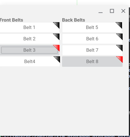

24 Apr 2023 21:49 #269800
Replied by rodw on topic how to make my own custom page for qtdragon_hd?
So I have taken your simple_hal example and modified it to suit my needs. Thanks. It was great to have a working example to modify.
I've used two groups of buttons so the columns are mutually exclusive but I need to ensure that if a button is selected, the one beside it is disabled. I'm assuming a handler is required to do this so a simple template would be great! I've only ever modified handlers before, its not clear to me how to lay it out. The current examples seem too complicated for a hello world example that simple_hal provides.
then styling to qtdragon and sort out the original problem of loading it into qtdragon.
I've attached the panel I'm working on if its of interest.
- Posts: 7368
- Thank you received: 2181
24 Apr 2023 23:45 #269807
Replied by cmorley on topic how to make my own custom page for qtdragon_hd?
Ok Rod please pull again.
Problem was on my end - I guess I never tested custom panels as embeds.
make a folder as such (custompanel can be any name you like):
INI_FOLDER/qtvcp/panels/custompanel/
add custompanel.ui
add custompanel_handler.py if needed
for exclusive toggle buttons set the exclusive and checkable properties on both buttons.
There is away to make groups so you can have separate groups of exclusive toggle buttons but I forget at the moment how to do it.
Thanks for sticking with this
Chris
