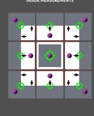

Replied by cmorley on topic qtdragon - probing issues
Though 1mm edge distance is really small - what diameter probe do you use?
- Posts: 12159
- Thank you received: 4151
17 May 2023 02:14 #271496
Replied by rodw on topic qtdragon - probing issues
So last time you said to position the start position where the purple dot is on the image.
This was counterintuitive to me becasue I would have started on the inside of the corner and above the part.
So this time I started on the purple dot (say X-5, Y +5) but I was a lot closer in reality.
If it needs to start on the inside corner, the images are wrong.
I'll test again in the inside position and report back when I get a chance.
What is the edge width? the context sensitive help was not helpful...
- Posts: 7368
- Thank you received: 2181
17 May 2023 02:33 #271497
I don't think I ever said purple dot - always the green marker.
I agree - I don't know what the purple dot was to represent and it should be removed.
edge width - is the distance to move _along_ the edge, away from the corner.
You don't want to probe the corner you want to probe edge width distance from the corner.
- y edge width away, then after probing that, +X edge distance away.
Contrast this to xy clearance, which is the distance _away_ from the wall to give room to clear and search for the wall.
The first move combines these two moves of course to speed things up.

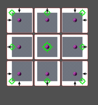

17 May 2023 03:29 #271500
Ok I updated edge to be 10mm
That image of yours is different to mine
It makes no sense for the start point to be the green dot. It has an alignment sight mark which indicates the target we are probing for. You can't be expected to accurately jog to be over the target!
If I start the inside probe where your purple dot is, it works.
If I position near the purple dot for a side probe it works
So the corner images are wrong. They need to be like yours...
If we look at the outside corners (top left),
I position the probe over the purple dot and probe for height.
Then I probe for the corner and it works.
Clearly the purple dot is the start position (except on inside corners where the image is wrong.)

17 May 2023 03:45 #271501
Yes I just made the image to help with the discussion.
I am sure if you play with the numbers you can start the probing from almost anywhere, but by design its from the edge.
Maybe basic probe did do it differently and that is why the images are wrong but now versa and basic probe pretty much use the same routines.
I'm sure the edge is used because it's easy to eyeball the start point.
I can not see how starting where the purple dot is works without it doing some weird moves.
Did you try it starting over the green cross hairs like I asked?
Yes I did try the green corner and it works,
You just need to be somewhere in the ballpark inside the green dot but not on the outside. I think the purple dots should be moved to where you show them just for the 4 inside corner probes so the images are consistent for all probes.
EDIT: Start somewhere between the green dot and the purple dot. Wherever that elusive purple dot is.
