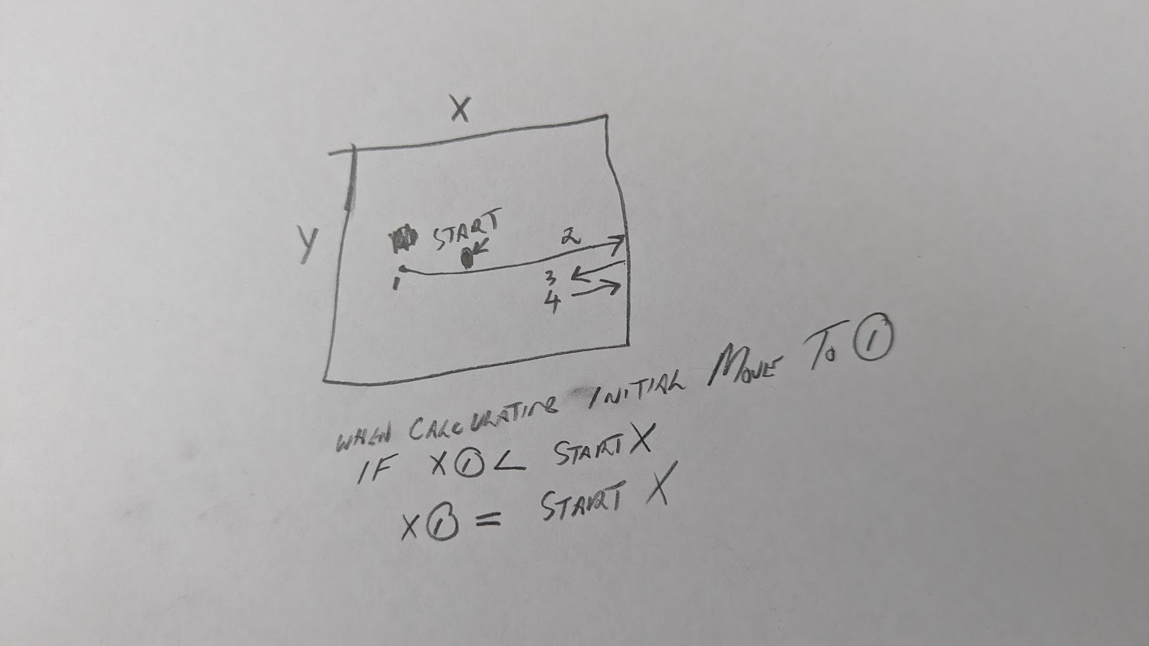

11 May 2023 23:21 - 11 May 2023 23:22 #271186
Replied by rodw on topic qtdragon - probing issues
Chris,
On Basic Probe.
Inside corners
Fails with identical behaviour to my video. There is no provision to add hints on this scrren. Should not need them.
Inside Pockets.
Works but.
Error message with no hints is not very clear. Says probe is too big.(0 diameter pocket would explain that)
With the probe centred roughly in the centro of a 50mm x 50mm pocket, It goes the wrong way before descending.
I think the conditional in the sketch woul ddo part of it but you would also need to alter the direction to move at the end...
On Basic Probe.
Inside corners
Inside Pockets.
Works but.

12 May 2023 05:53 #271202
The 'wrong way' move is probably explained by this. The green symbol is on the edge of the part, so it needs to back away from the edge before dropping down and probing.
I set up my probe on my test mill. So far I found versa probe more straight forward.
More testing to do.
Replied by cmorley on topic qtdragon - probing issues
You need to put the probe where the green symbol of the probe button dictates.With the probe centred roughly in the centro of a 50mm x 50mm pocket, It goes the wrong way before descending.
More testing to do.

12 May 2023 06:02 #271203
I found the downside of versa is the top surface probe is on a different tab.
Sorry, I did not draw the descent which happens at 1.
The inside corner still sounds wrong. Going the wrong way is the very first move it makes. Even if I had of put it closer to the corner it has no idea where the corner is so it would still go the wrong way before descending.
There is not really any reason for it ever to go the wrong way on start in any probing mode.

12 May 2023 06:20 #271206
Please pick a specific probe button for discussion.
Your diagram is for edge probing, then you just talked about corner probing.
Either one of them need to back away from the edge (or corner) before moving the probe down. If this is what you mean by 'wrong way' it is expected behavior. If the probe immediately went down it would trip on the edge.
The probe routine knows approximately where the corner is because they is where you are supposed to jog the probe to before starting the routine.
in you diagram, you used the X+ probe button (center right), then you shouldn't start the probe in the middle of the pocket. It should start with the probe in line with the right edge a few mm above it.

12 May 2023 08:00 #271209
Sorry,
When I look at what I said above, the diagram related to inside corners.
OK, I see your point with the start move.
But it does not excuse the probe going the wrong way after the second touch off and causing a probe error while not probing.
It does this when its found the first edge.
