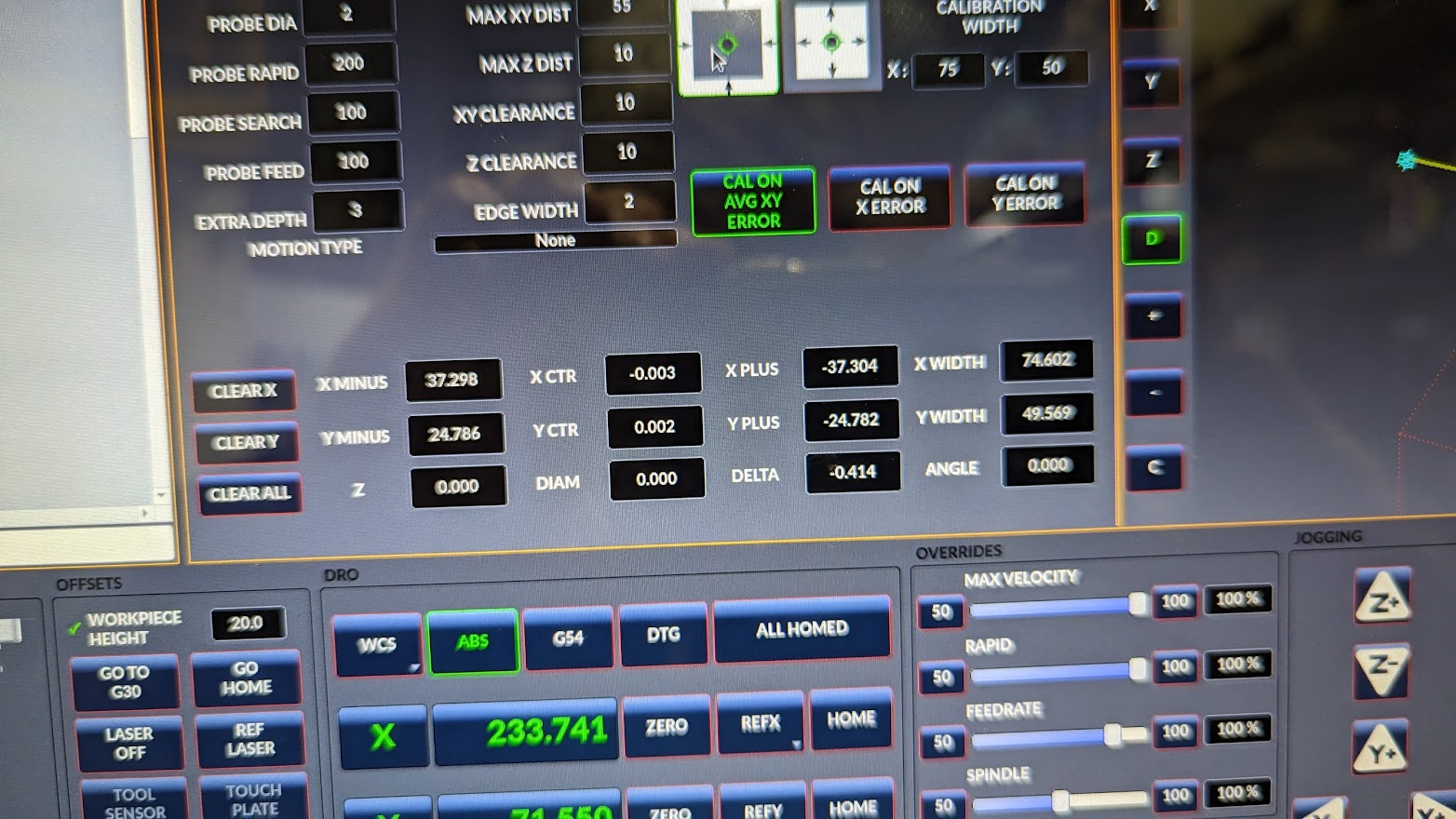

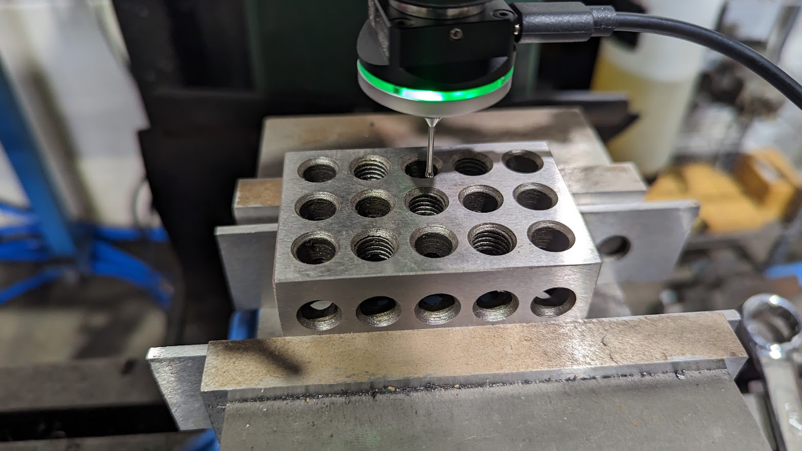

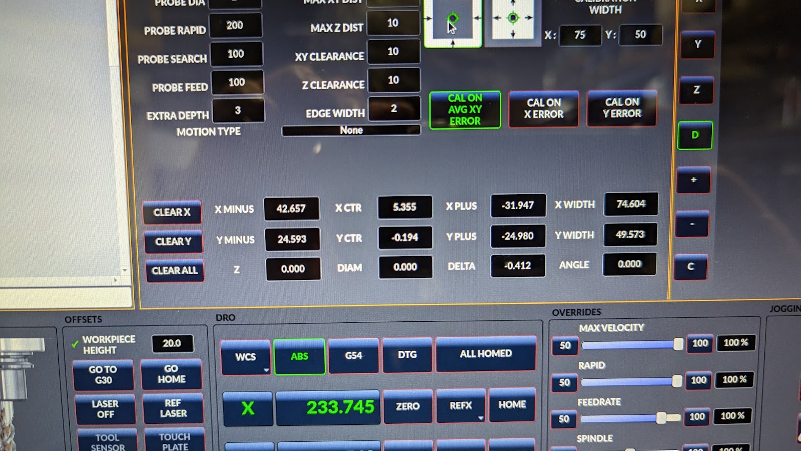

The calibration seems OK. I probed a metric 123 block (50mm x 75mm)
First probe
Second probe from exact centre
It seems you need to probe twice to centre the probe first. But the delta is close to the difference from the X & Y widths.
Looking at the second probe, the measurements are consistent but out by about 0.2mm. I wonder if this is the latching distance/switch hysteresis? It would be intresting to see it with G38.4 becasue I seem to remember it was about 0.2mm difference.
First probe

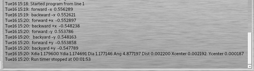

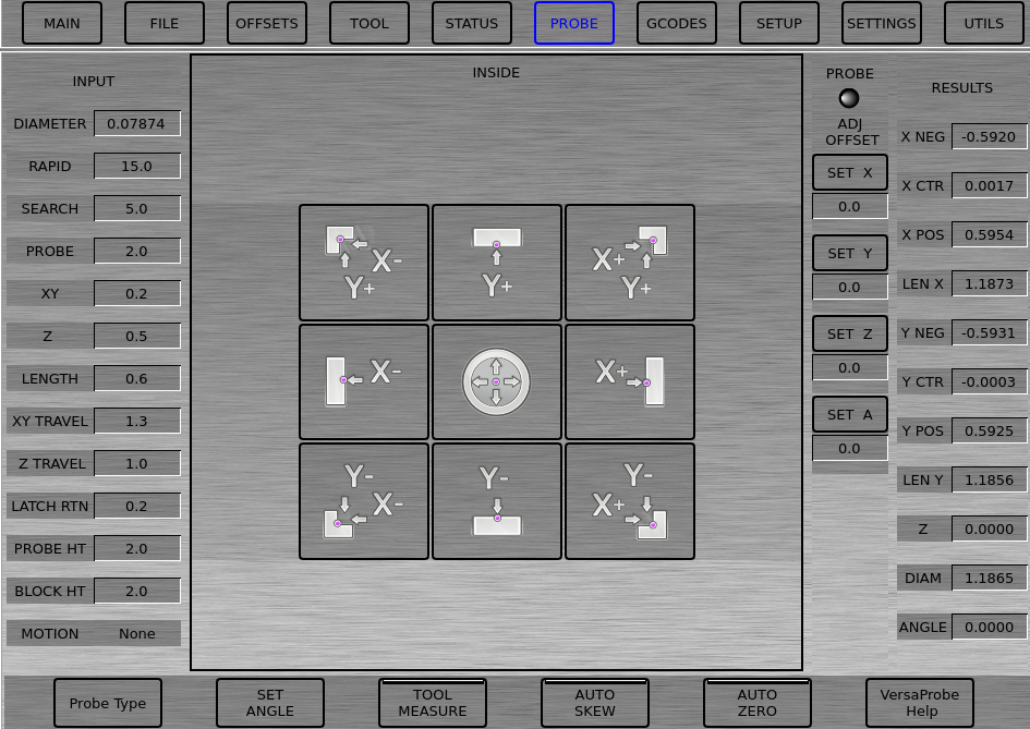

rodw, thanks. I modified the probe_hole6.ncg (attached here) to include a g38.4 (reverse probe) following the forward slow probe.\
after each touch, I included a debug statement so it'd write out to status the data of both probes.
interesting. all 4 probes, +y,-y,+x,-x, show about 0.004 inch difference.......that's significant.
see the file and pictures.
and it's a 30mm ID bearing
the file is set to be used in ncggui, even in qtdragon. very handy.
. and here's the regular VersaProbe ID.
