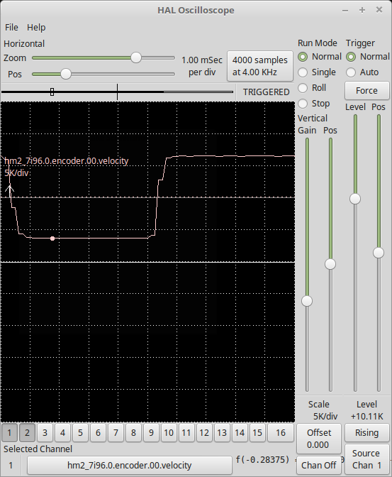

This is what is what the external offsets simulated torch works on (because of that statement). Of course it varies from torch to torch.The other parameter we discovered in testing is that the THCAD board has a rise time of 5 ms which in the sim equates to a lowpass of 70 Hz (I'm just quoting what Dewey told me after looking at some plots I did for him as I don't really understand that).
So after getting the lowpass component docs revised by BigJohnT so they are understandable, I've reconfigured the eoffsets simulated torch to be as close to my torch as possible. based on these two bits of empirical data we've uncovered. I did find that in real cutting the resulting tuning did not crash my torch.
The THCADs rise time is less then 0.5 ms. A 5 ms risetime would be detrimental to loop tuning. Of course any post direct data
filtering will affect the loop bandwidth.
