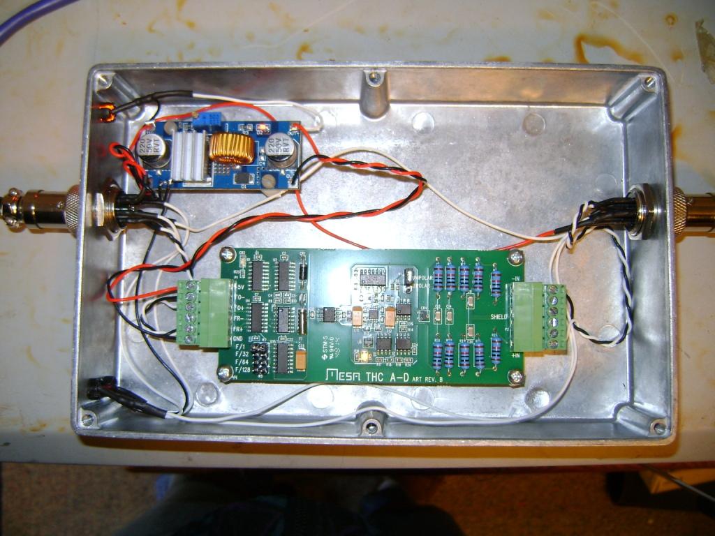

My A60 doesn't have the factory divider so the I mounted my DIY voltage divider there. My THCad is mounted in a shielded box that is either on top or under my A60 and connects to the rest of my controls through a shielded Ethernet cable with Chinese circular connectors.
What I have for ohmic sensing. I have an isolated power supply (wall wart) that only powers the ohmic sensing. The power supply is protected with 1N4007 diodes so the arc voltage can't get there. I have a DPST relay to switch both sides of the circuit to disconnect it from the work and the torch shield when I am not actually measuring. I then use an Opto22 dc input module to sense when the circuit is complete. Every thing is series connected. Now with all that if you aren't going to cut sheet thinner than about 5mm you will have no need for ohmic sensing, your float switch should work fine. Look in zones 2, B & C.

Thanks for the feedback guys. I've managed to reassemble my table with the new torch. The bigger torch lead was a bit of a squeeze in the drag chains but it worked! I also got a decent air supply to it. Tomorrow, I should be able to get the interconnect cable wired in.
