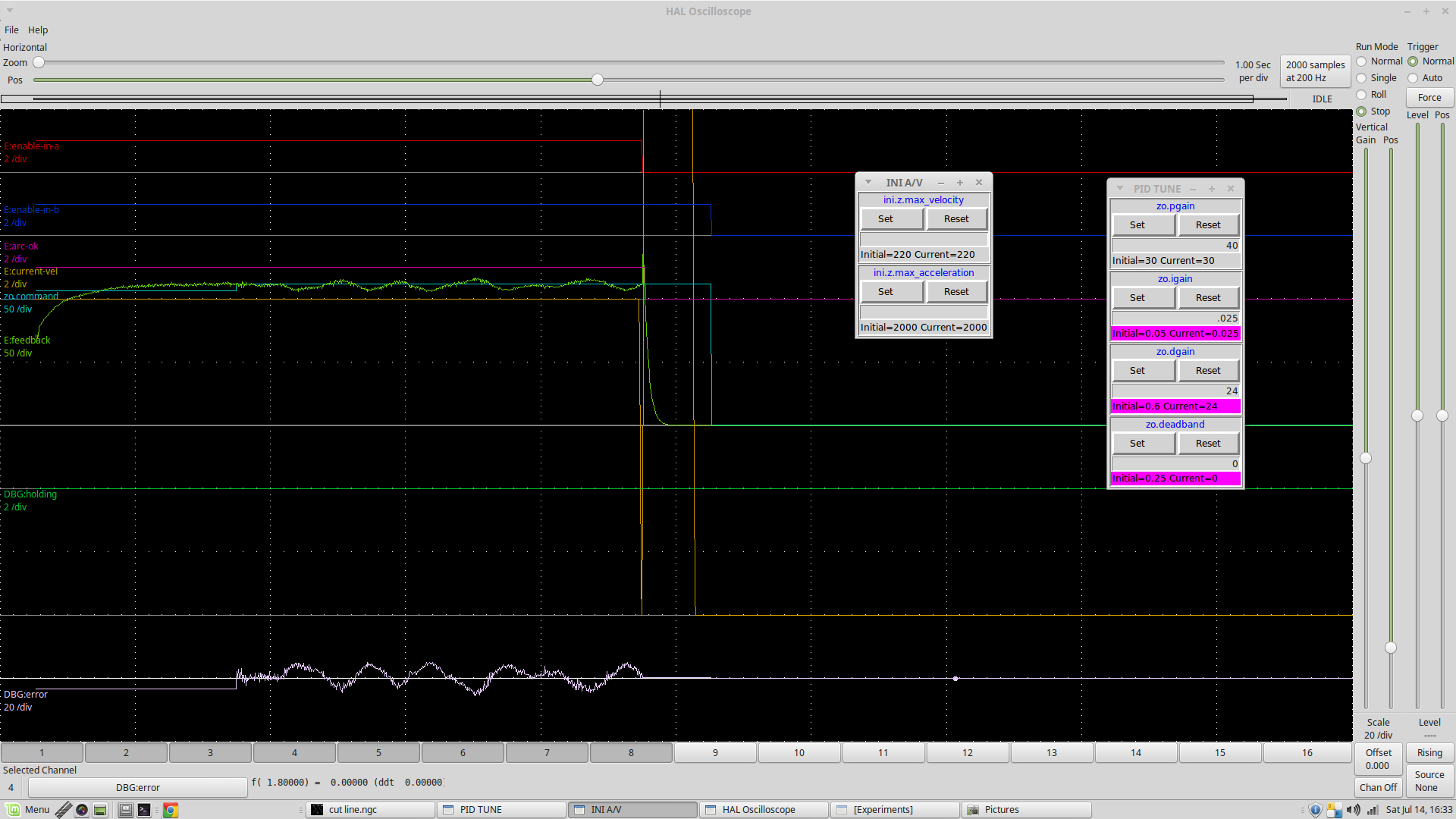

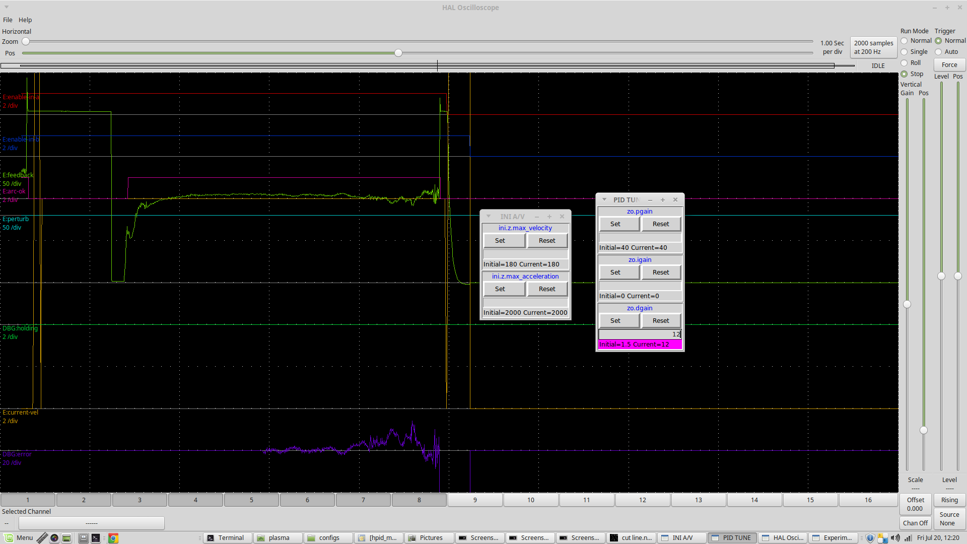

Peter that is awesome thanks. You have no idea how long I spent trying to test this and capture a plot like that for Dewey in a very crude way. Looks like we should have just asked you!
In Dewey's simulated torch (hal file) in his HPID sim, he uses a lowpass filter with a cutoff frequency. Based on 5ms he said it should be around 70 Hz (you've already helped me with that. Now I just need to know what to change it to now to simulate the torch.
github.com/LinuxCNC/linuxcnc/blob/dgarr/...et_pid/sim_torch.hal
Any input would be appreciated.
With relation to the voltage range, the THCAD range can be scaled using an external resistor. Initially I scaled it to cover a 20 volt range, What I found is that the THCAD sees the Everlast's resistor divider network as part of this external resistance. From memory, this changes the scaling by a factor of 1.5x so it becomes a 24:1 divider (240 volts) so there is heaps of headroom so I removed the external resistor.The only time I've seen the volts go past about 130 is when I deliberately engineered a kerf crossing test off the edge of a sheet.... One more headache I had to find and deal with during this build.
I did some more test cutting yesterday but would you believe a prox sensor on the Z axis home switch failed? Should they be protected with a current limiting diode? If so what value for a 24v system?
I think I have a spare here and I've ordered some more. This is the second I've had fail.
I think the new coupling made a bit of a difference but the changed velocity means retuning. Here's a couple of plots with similar PID settings
The other day (old coupling)
Yesterday (new coupling)
I wanted to play with the eoffset scaling factor but my home switch said that was not to be!

The THCADs rise time is less then 0.5 ms. A 5 ms risetime would be detrimental to loop tuning. Of course any post direct data
filtering will affect the loop bandwidth.
