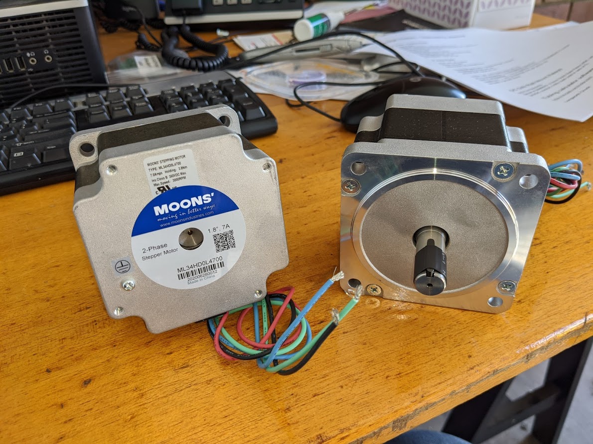

Yeh but NEMA24 does not normally have a 50mm bolt hole pitch. The NEMA24 ones I looked at had the same pitch as the Nema 23 but a different diameter locating flange.
I can't wait to get this turning!
Replied by rodw on topic Rods "Spaceship" Scratch built Plasma Cutter build
Nema 23 = 56mm frame, Nema 24 = 60mm frame !

I am not that lucky, all the Nema 24 i have have different pitch, just enough to not fit at all !

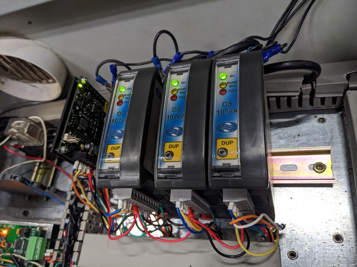

Finally this afternoon, I got the wiring pretty much done and I'm hoping my mate Chris will have time to give me a hand to refit the control box to the table tomorrow.
This box weighs about 17kg now. The wiring is just temporary and I'll have to disassemble it before it all comes together.
But finally, we have power lights on the Lam drivers! 90 volts wow!
A little bit tidier now
Just in time to becasue these arrived today as well
A NEMA 24 mounting bracket is also here so I can upgrade my Z axis with a Sanyo Denki motor. But to do that, I need my table back working again as I have to design and cut a mount for it.

What are the blue spade connectors on the back of the drives for? Earthing?
- Posts: 12135
- Thank you received: 4141
02 Jul 2020 09:13 #173387
Yeh, originally, I used 5 pin connectors for the stepper cabling so I could pass the shield through on one pin and then I folded the shield back and added a male spade connector right at the stepper motors. Then they go up to an earth point just out of frame at the top right.
As it turned out, it was the right thing to do becasue the LAM's have a connector for the shield. Its a bit messy where the connectors are because I added piggy back spade connectors so I could terminate the shield on the driver and the enclosure. I'll try and remember to take a pic tomorow.
