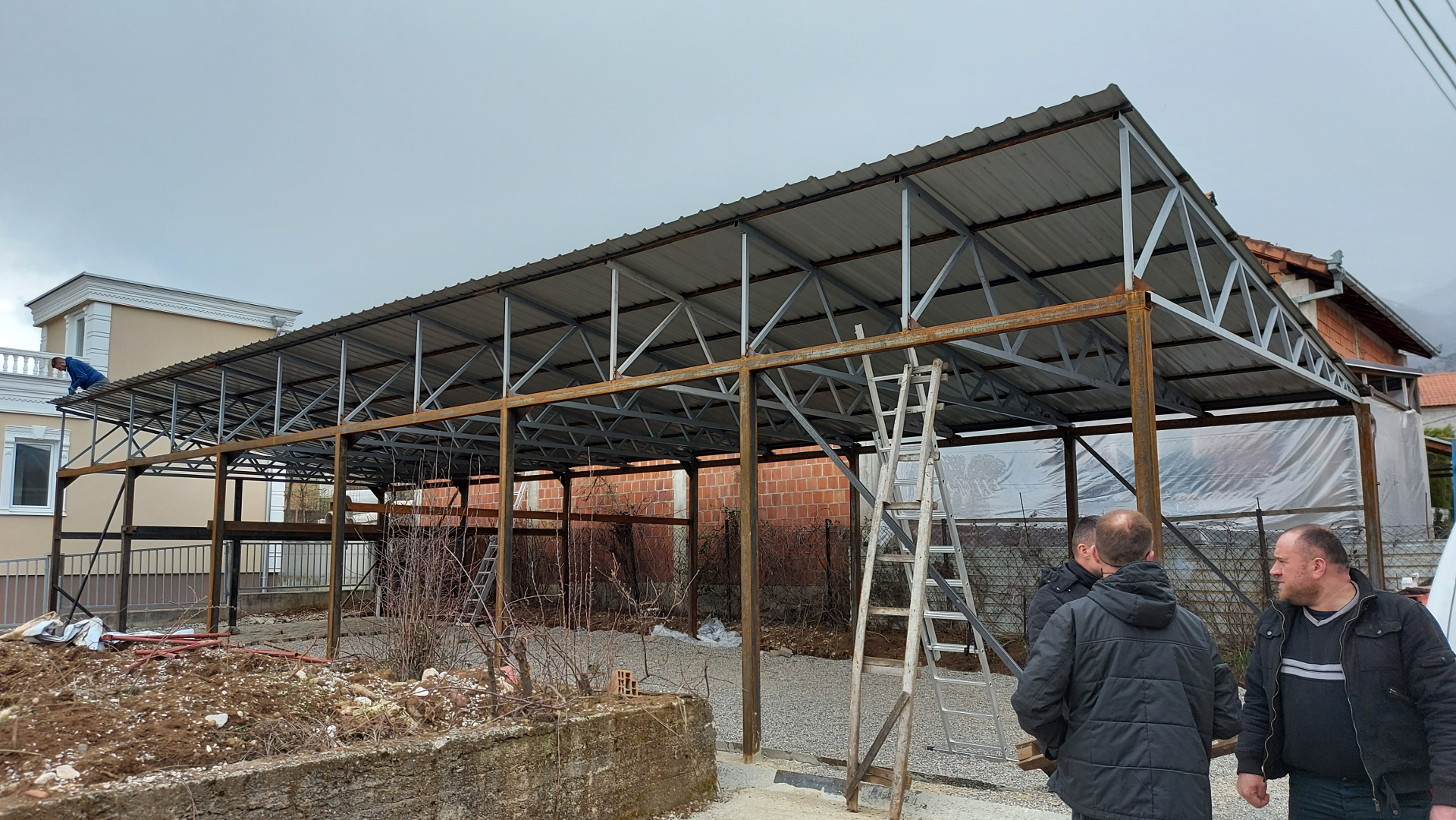

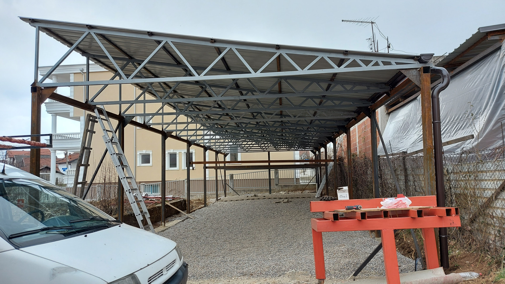

... not to worry since i am all out of finances chances are i will win this one ! :)
They won ! :S
Got some 25 sq meters free from a friend and another friend found 50 sq meters for 130 euro plus transport. Still 35 sq/m short ! :(
But it is slowly coming together, tomorrow (if it does not snow or rain) gutters and roofing should be done. :)
Thank you all for your continued support, and PhillC, ChrisM, AndyP, et al, sorry for not helping much lately, i am frantically trying to finish the backlog of work. As an added bonus, got a 3d printer (shame on me, have all the parts in the shop to build one or two of them) but i need to design and print a box and the friend that needs it did not want to wait, so now i have to learn to use it = took about an hour plus another hour when i switched to PETG, measure the electronics and screen and sensors and batteries and chargers and .... and design and print the box, meaning i have a few days to also learn 3d design.
Oh hell, at least i am not bored, ever! :)

Looking good Tom,
In your country what do you call that profile of cladding? Here we call it Trimdeck and its a pain to install because it dents easily when you walk on it. We use it but not very often, 90% of our sheds used corrugated iron we call CustomOrb.

18 Mar 2021 21:56 #202776 by shpatb
there is some kind of primer that applies over the rust, my uncle brought from Ger , worked marvelous . :)
nice truss design old man :)

19 Mar 2021 09:48 #202815 by tommylight
"Llamarin per kulm" or roofing sheet metal, translated. Yes it does dent easily, so just look for the screws and step on those, the trusess are 95cm appart so skipping through them is quite easy.

19 Mar 2021 09:53 #202816 by tommylight
@Shpatb,
I had some of that paint but it's gone so now i will have to use the crappy one and use elbows to clean the metal a bit. Not worried to much about rust as i do not know how long will that be standing there, a neighbour plans to build residential building nearby so my house and shop will most probably be gone if that happens.
