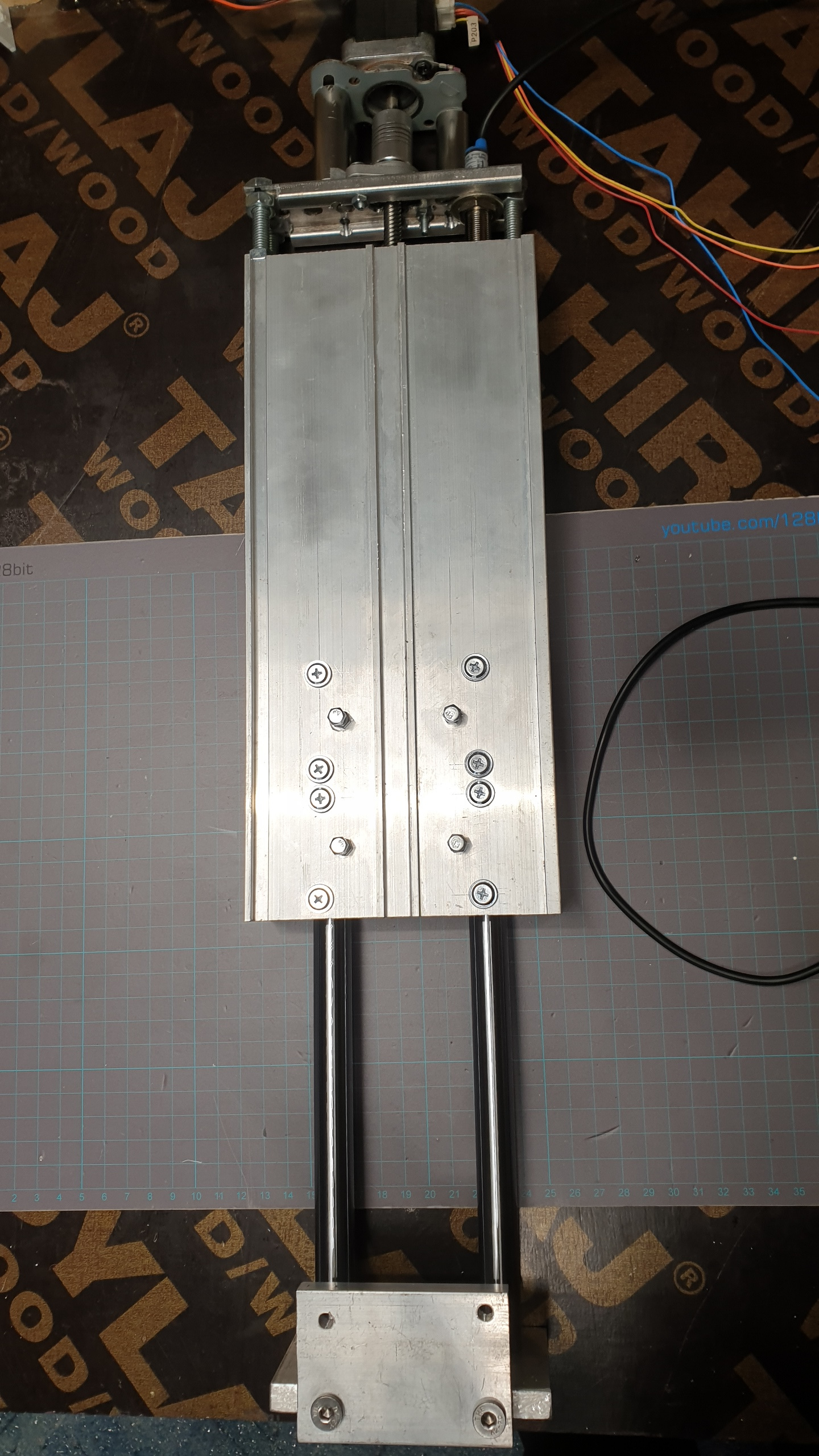

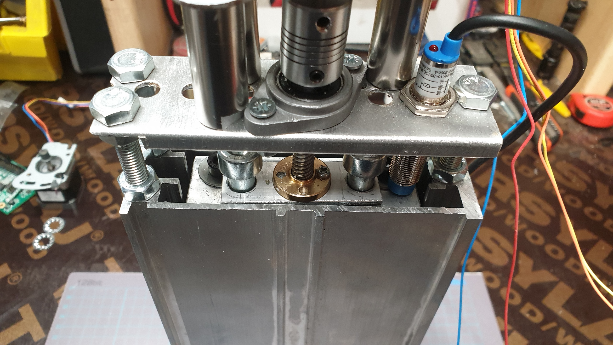

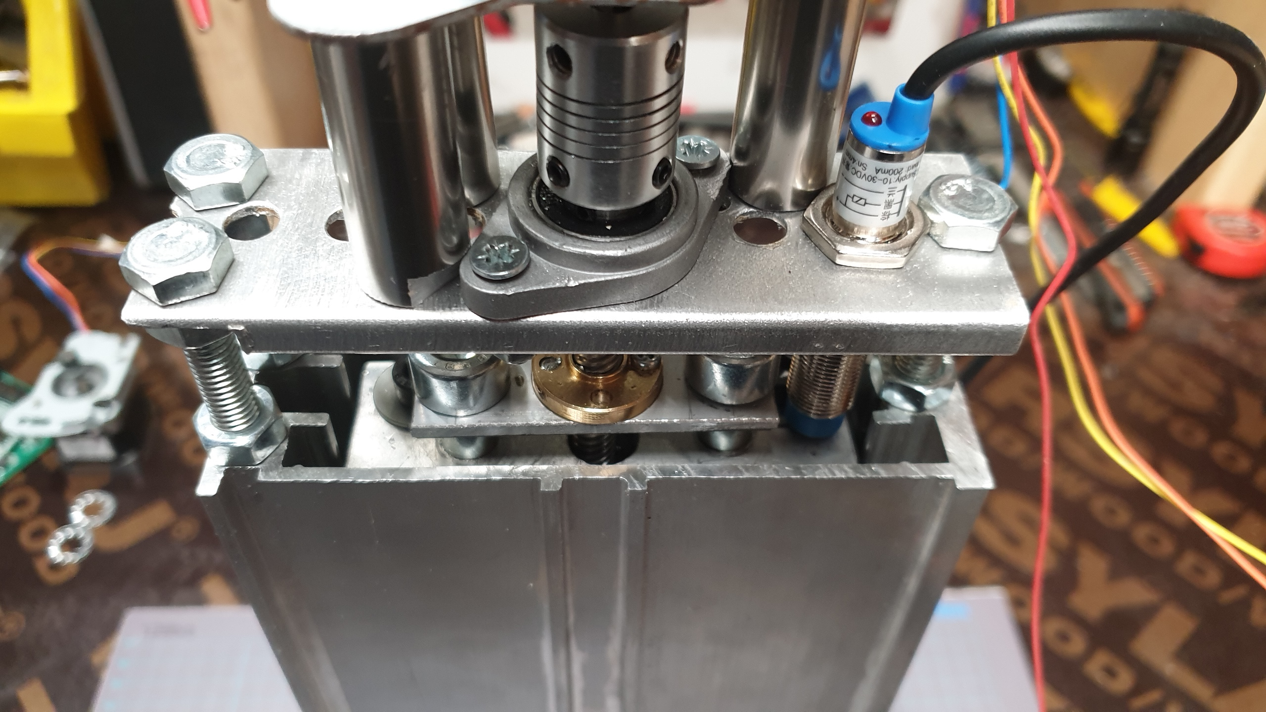

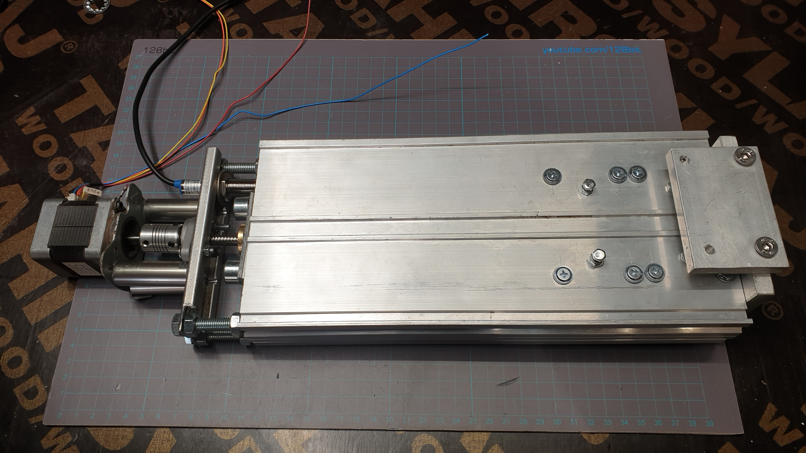

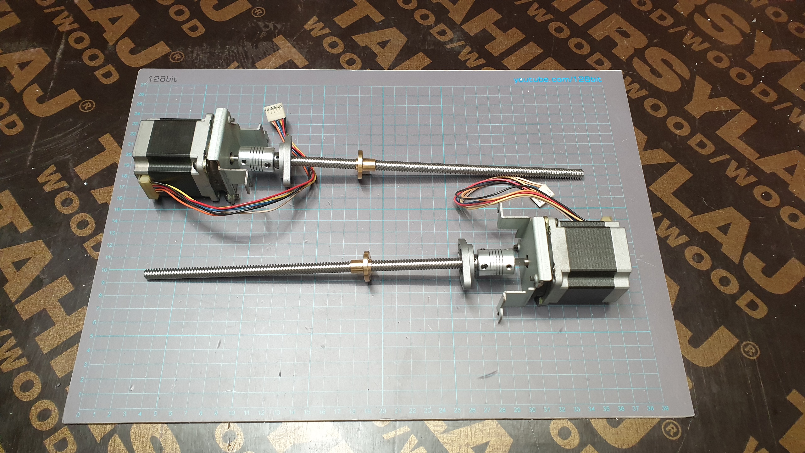

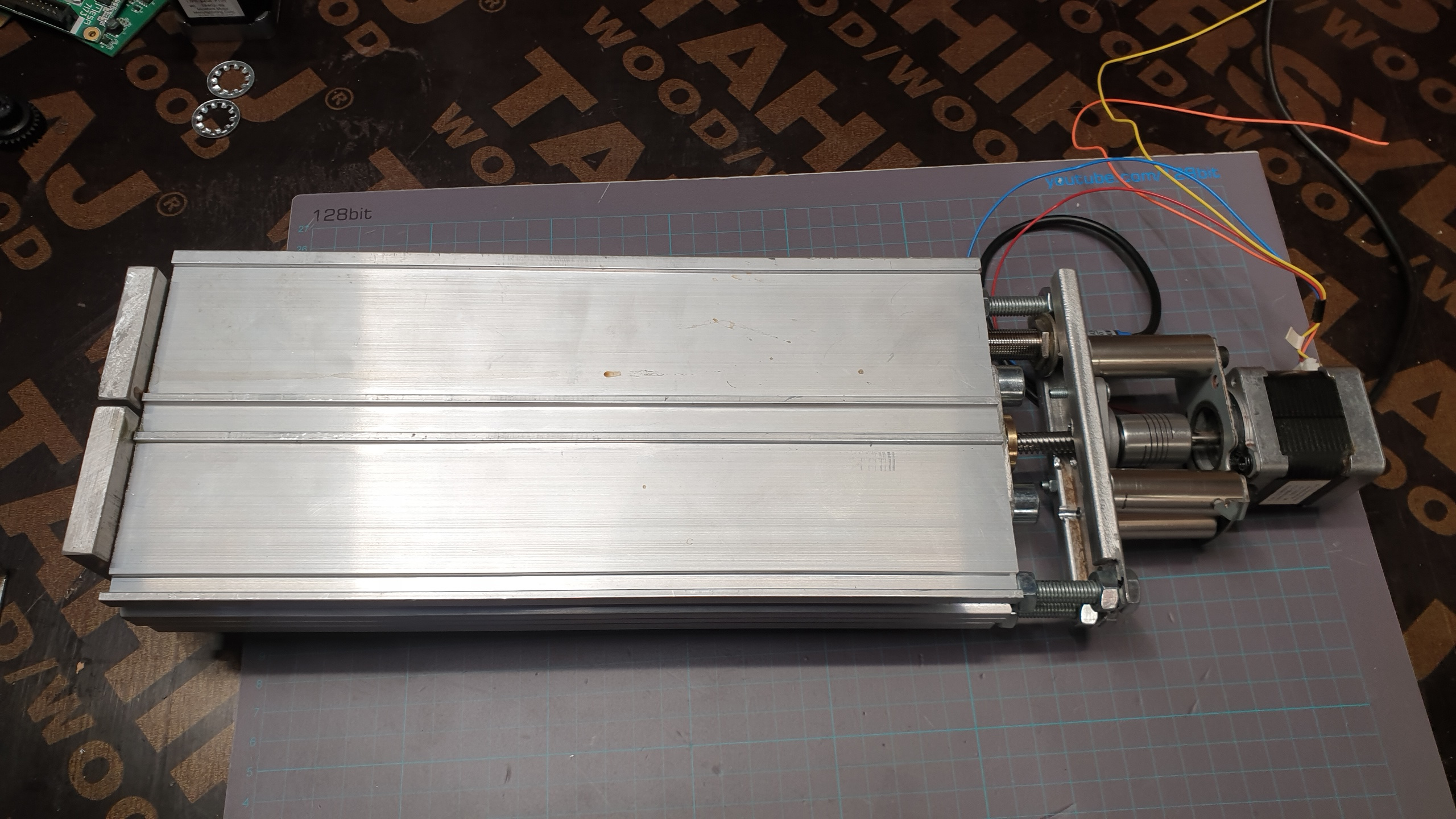

30 Apr 2020 16:23 #166228
Replied by tommylight on topic 2+2+3 More Plasma builds, double the joy ! 3X2M and 2.5X1.5M cnc plasma build.
This was tough, i sure know how to complicate everything !
This is the final implementation of the Z axis, after many, many others i tried and discarded them for being to heavy/bulky/ugly. :
The profile is 28.5cm long and 34mm wide inside so not much space there for all the stuff that i had to put inside
Travel is 165mm, screw can do 220mm, but the bearing took 100mm inside, so i got left with only 185mm to work with.
I might get rid of those screws on the top, but that would limit travel by 15mm, so that would leave 150mm of usable travel. Do keep in mind that there is another 10mm travel for the floating part of it, so the only unused space inside is 10mm used by an alu plate connecting the rods inside and holding floating stuff and leadscrew nut, here is a picture of the floating part in the UP position:
And in the DOWN position, notice there is no sensor/switch there, will have to put that in when i dismantle it to make another one, and maybe take some pictures, :
Here is the back side, plain and clean ( well not cleaned yet, but there is nothing there ) :
And here it is extended to the bottom limit :
Took two full days to make, several injuries to the left hand ( the one holding down the stuff while the right hand does the damage
), had to use a bit smaller motors (Nema 17), the leadscrew is 8mm pitch and 8mm thick by some miracle of very nice quality, 16mm round rails on the inside with 4 linear bearings, total weight just under 3KG and 128mm wide. The mounting on the machine will have to be done on the sides as there is no place for anything on the back side, any screws there will interfere with the movement.
More on the way.....
