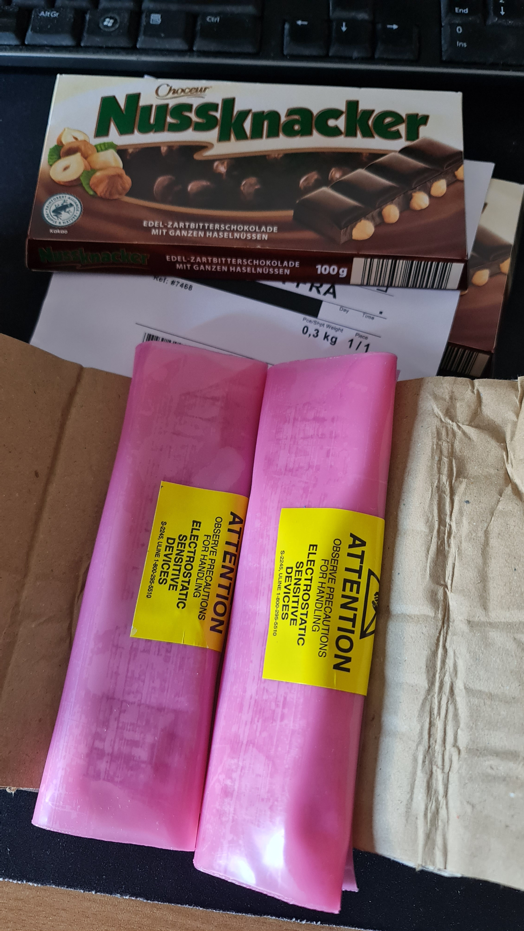

02 Jun 2023 11:35 #272709
Replied by tommylight on topic 2+2+3 More Plasma builds, double the joy ! 3X2M and 2.5X1.5M cnc plasma build.
Got 2 more THCAD10 today, with bonus chocolates !
Thank you to Filipe at www.eusurplus.com by now i owe him a lot of coffee's !
