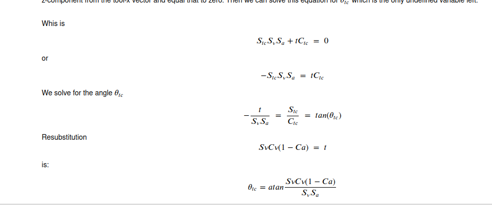

Maybe I was a little unclear in my description. How it's shown in the image is correct. The B rotary table rotates around the Y axis (green arrow). The nutating A,C head has the nutating A joint rotating around the X axis (red arrow). However, because it's nutating, I said the A axis lies on the XZ plane.
Based on your original config, I've implemented both TCP and TOOL kinematics on my real machine and they behave correctly/the same on my real machine and in Vismach. I do understand what you mean about the difference between the kinematics and the Vismach model. I saw this initially with my real machines C axis rotating the opposite of my Vismach model. And it's pretty obvious something is wrong when in TCP mode.
Then based on your updated config (and because it's very similar to my real machine), I went through the Juypter file and redid the kinematics to set up a simulation machine in order to get the TWPs working. The kinematics seem to work correctly. Both TCP and TOOL work as expected in Vismach. And it does correctly jog along the tool-Z axis in TOOL mode. After working through your original config and implementing the kinematics on my real machine, I think I have an ok understanding of Vismach, the kinematics, and their relation to my real machine.
With all that said, my math skills are lacking. And I'm not sure if what I have done is correct when it comes to rearranging the equations I need to get the tilted work planes working. I posted what I have done in my previous post. Any help would be appreciated as I'm sure what I have done is wrong.

The tool vectors 'Kz = (Kzx, Kzy, Kzz)' and 'Kx=(Kxx, Kxy, Kxz)' you use in the TWP-angle-calculations you posted are those from the transformation matrix you use in the 'Inverse TOOL kinematics' ?
Next question:
- Paul01
- Posts: 25
- Thank you received: 5
12 Jan 2024 09:17 #290484
by Paul01
Replied by Paul01 on topic Kinematic model for a 5axis mill with universal (nutating) head
Yes they are. From the Inverse Tool kinematics I've taken the third column to calculate the spindle rotary joint positions for the tool orientation vector, and then taken the first column for the Tool-X vector.

Likely a problem with the quadrant handling so get going change lines 64 and 65 like this:
And see what you get. Don't worry about the tool-x vector until you get the tool-z orientation worked out.
Also I think you have an error in the calculation of angle 'tc', here is what I get:
Just out of curiosity, it this for a home built machine or a retrofit of a commercial one?
if True: #Kwx >= 0:
if True: #Kwy >= 0:
A_j = acos((Kwz-Cv*Cv)/(1-Cv*Cv))
Sa_j = sin(A_j)
Ca_j = cos(A_j)
t = Sv*Cv*(1-Ca_j)
p = Sv * Sa_j
C_j = acos((t*Kwx-p*Kwy)/(p*p+t*t))
print('C_j new: ', C_j*180/pi)
quad = 111 #Done

Amazing! Thank you so much. Changing to if True worked. I was really unsure how to rearrange the equation for angle 'tc', but what you've posted works too.
I'll go through your modified sim config and use that instead of what I've done. And with it I should have my machine properly up and running.
So this is for a home built machine. I use a Biesse Rover B at my job, and wanted something similar to use at home for myself. It's about what you'd expect for a home built machine and isn't at the level of a commercial machine. But my 2 axis head is loosely based on the HSD nutating head found on the Biesse CNC. Being very ignorant to the kinematics required at the time of designing and building it, I decided to go with a similar style of nutating head. I think that without finding the work you've posted in this thread I would have had a difficult time getting my machine up and running. And I've found the Jupyter file extremely invaluable. So I'm very grateful for the work you've put into these sim configs.
I work in furniture manufacturing, and a lot of what I do on a CNC involves pretty basic 2D toolpaths, often on angled faces. And because of the advantages TWPs offer, I'll be pretty happy to get that side of things up and running. And in the future when I have my machine fully working I'll post some of my stuff on this forum. The last thing I have to do to finish off my real machine is to purchase all the required hardware for the rotary table. Currently that's just something that I have working on my sim config, but I wanted to make sure I had everything sorted in my config so the addition of a B rotary unit would be easy.
