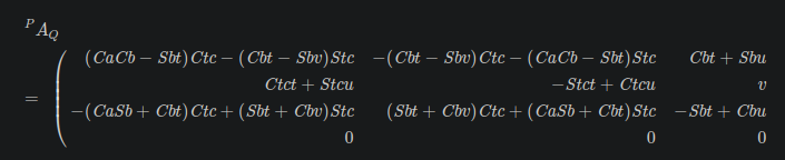

To calculate the joint angles (which is done in the function 'kins_calc_jnt_angles' in 'remap.py' ) we use the rotation matrix part (ie disregard the fourth row with all the zeros ) of the transformation matrix as derived for the inverse tool kinematic:
the columns of this matrix represent the tool orientation vectors [tx, ty, tz] and hence the 3rd column represents the tool-z orientation vector we are trying to orient the spindle head to.
So using the variable names from the remap we get:
Kwx = Cb*t + Sb * u
Kwy = v
Kwz = -Sb*t + Cb*u
with the substitution for 'v' we can then solve for Sa and thus for the angle of joint A
Then we use the two remaining equations to solve for Sb and thus for the angle of Joint B
The output of this calculation needs to conditioned so the correct angle values are output for the machine rotary joints.

in the function ' kins_calc_tool_rot_c_for_horizontal_x' of remap.py there is  this comment:
    # Mathematically we take the symbolic formula found in row 3, column 1 of the transformation
    # matrix from the inverse tool-kinematics, equal that to zero and solve for 'tc'.
    # ie: -(tctc-vstc)cb-(cactc-tstc)sb=0
  Note that the formula given in the comment may not be readily recognizable in the matrix shown above yet it is indeed identical to the third row of the first column. It seems that in the final version of the documentation 'Ctc' and 'Stc' were factored out instead of 'Cb' and 'Sb'.
