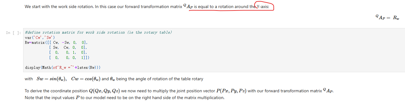

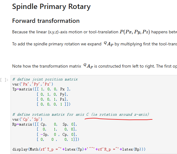

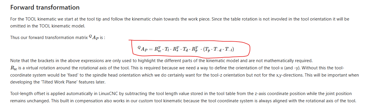

Hi Aciera. Thank you for your contribution.Now I have some mathematical problems with the tool kinematic model,about forward transformation.
Why do all rotation matrices need to be transposed or inverted?I don't really understand the physics of what this means.

For the TOOL kinematic model we start at the tool and work backwards to the work coordinates. A backwards rotation is the transposed rotation matrix.
