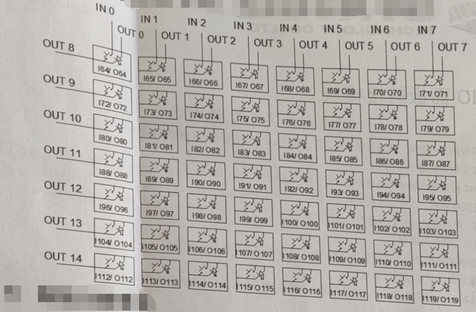

hello,I'm trying to drive this matrix keyboard, which has LED lights in parallel, similar to matrix keyboards and matrix LEDs in one, and scan lines are common.
I tried to write the Arduino code following the example you gave, but I didn't know anything about programming, worked hard for a long time, and almost gave up.
Below is its schematic

If i understand correctly, besides the matrix keyboard, there are also multiplexed LEDs in the Keyboard.
The LEDs Light up, when OUT0 is HIGH and OUT8 is Low, right? Are resistors already in place for the LEDs?
What kind of hardware do you have? I'd be interested to learn more about it.
I'll try to help you and see how i can implement the LEDs for you.
How do you want the keys to behave?

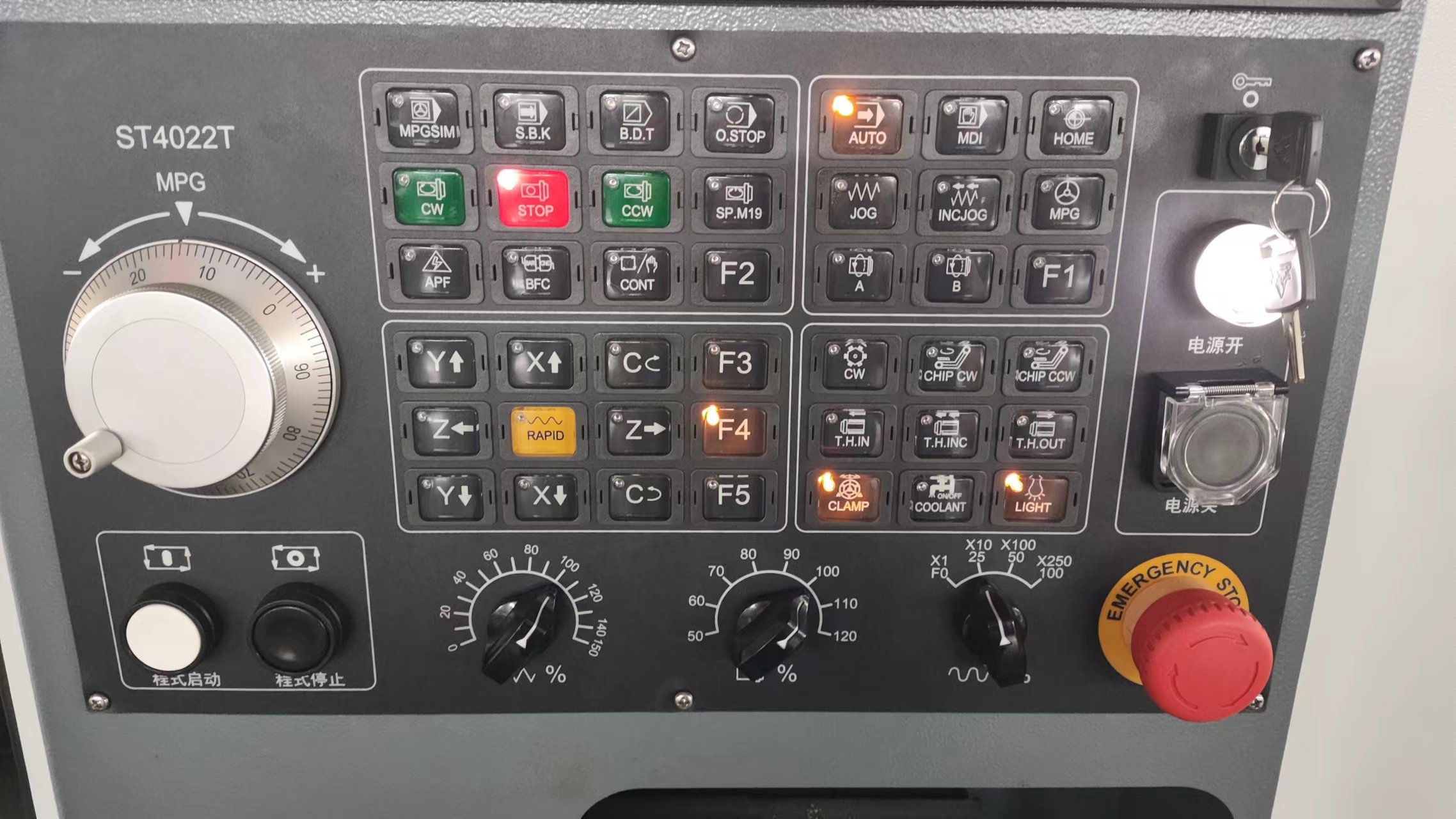

Yes.When OUT0 is high and OUT8 is low,the LED named O64 will be on. When OUT8 is low and the button named I64 is pressed,Arduino will get the signal.BTW,With my knowledge of electronics, LEDs have two functions here, the first indicates some kind of signal from the linuxcnc, and the second is to prevent the fourth case from being misidentified when three keys are pressed at the same time.
I'm using arduino mega 2560.
This panel is from SYNTEC, a CNC controller manufacturer from Taiwan.
Add in the photos of it at work, and maybe you will know the specific use.

I want linuxcnc to have input and output pins corresponding to the number of buttons, so that I can control each LED and button independently. For example, when the spindle is turned on in the virtual panel or MDI or some other way, the LED under the spindle button will light up.

ah i see. The Matrix keyboard should already work.
Currently you can choose between modes for each key,
1. Input Pin in LinuxCNC
2. emulated Keypress. -> for example Numbers, Letters, Enter, Shift, delete and so on like an "normal" Keyboard"
3. typing of text. For example you can go to MDI and select the command field. Then press a button, which would enter a string, for example "M6 G43 T". You could then enter a number with number keys in mode 2. and Enter with another Key.
I started implementing another mode for multiplexed LEDs. I can't really test it. Would you be open to test it for me?

check out this Code: github.com/AlexmagToast/LinuxCNC_Arduino...or/tree/keyboard_dev
I've added a function to drive multiplexed LEDs. I think it might work.
Around line 286 there are two settings:
const int LedVccPins[] = {0,1,2,3,4,5,6,7};
const int LedGndPins[] = {8,9,10,11,12,13,14};
The numbers correspond to the OUT pins on your drawing. please change them to how you connect the keyboard to the arduino.
I've implemented the python part also, but never tested it. Might work, but propably not
I guess it makes sence to test the arduino first.
To test could you please wire the arduino up with the keyboard,
connect it to ArduinoIDE and open Serial Monitor.
Send E0:0
After that by sending M0:1 the first LED should turn on.
Each LED is identified by a number, from 0- (rows*columns in your case 55).
You can adress it with the number behind M. The number behind : defines the State. So M5:1 turns on LED the 6. Led in the matrix.
M5:0 should turn it off.
If this works you can try if by chance the python part works too.
