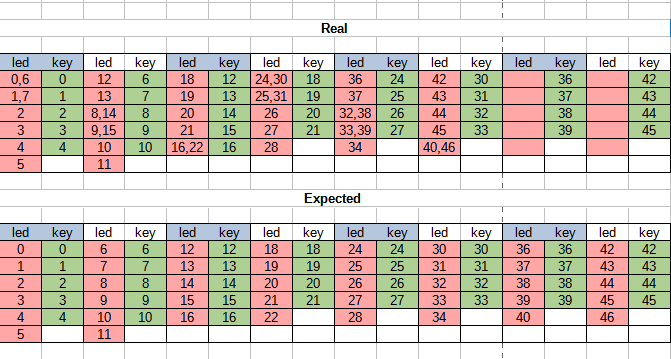

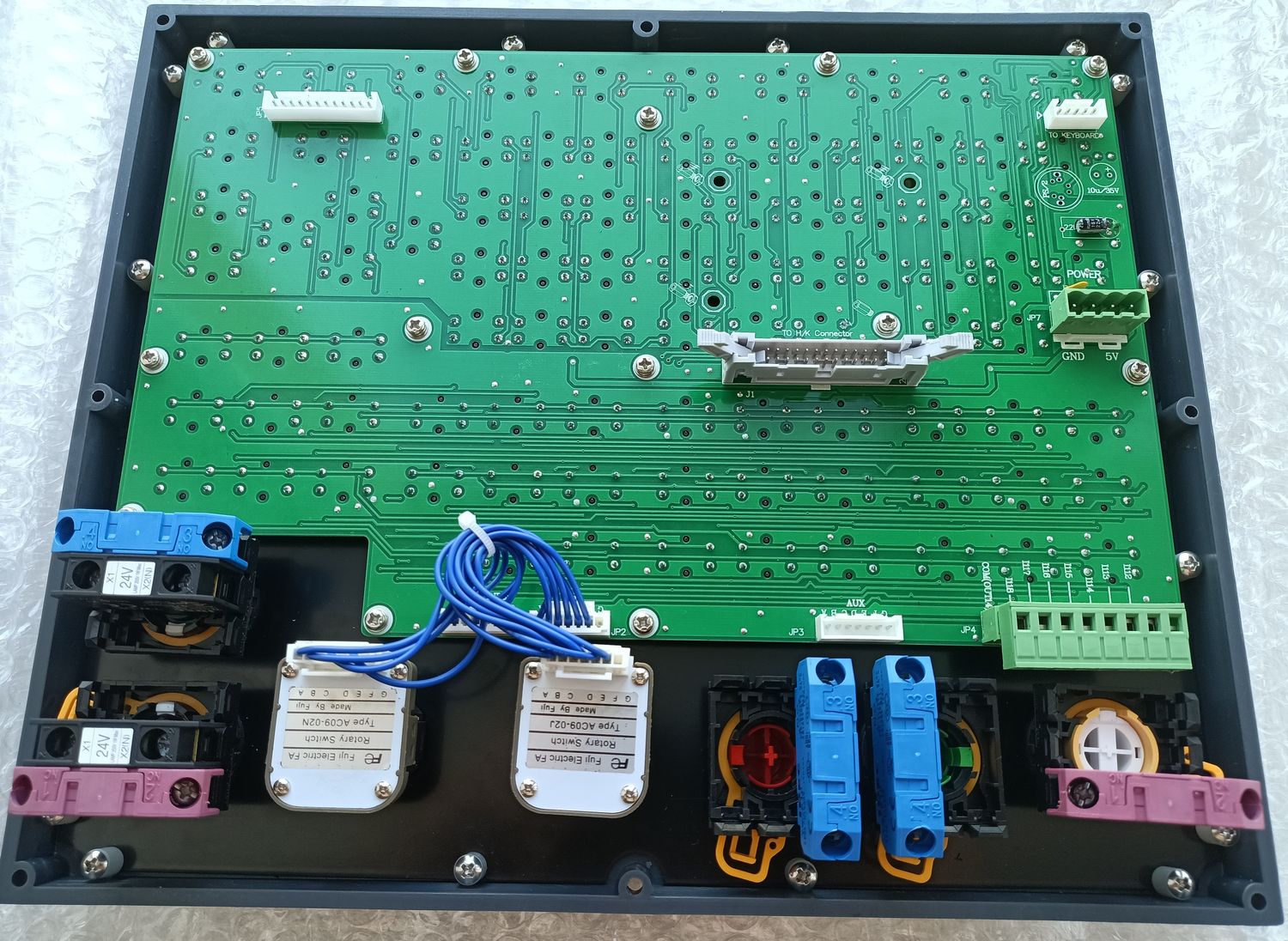

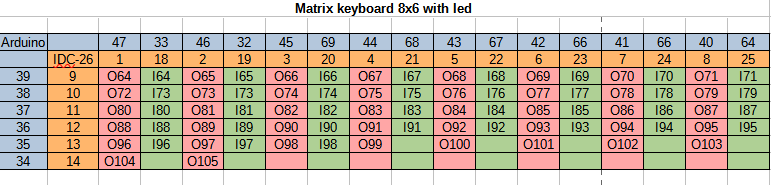

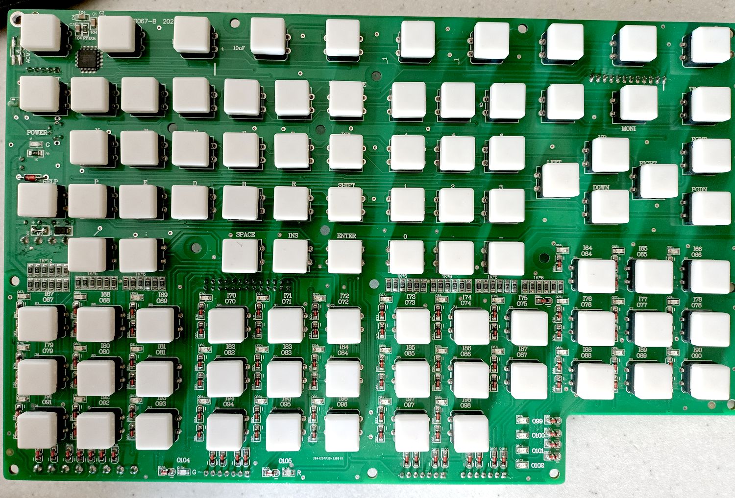

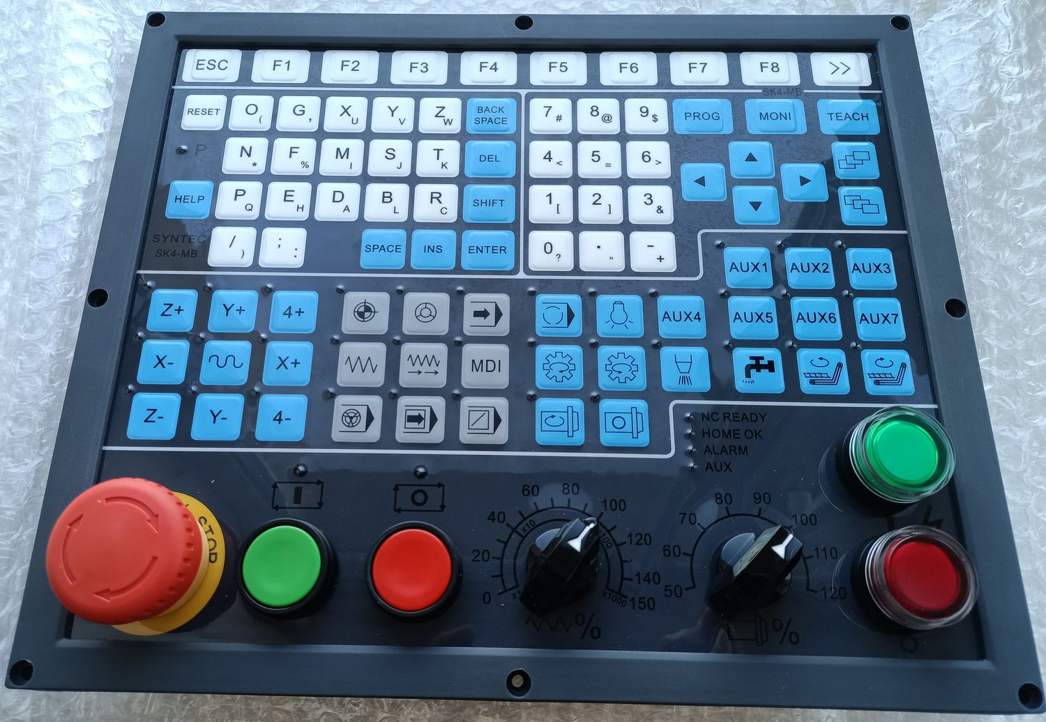

17 Feb 2025 09:36 #321818 by Mr. Mass
Replied by Mr. Mass on topic Matrix Keyboard controlling LinuxCNC
Trying to figure out a similar industrial keyboard from SYNTEC. The upper part is a regular PS/2 keyboard, and the lower part is a matrix keyboard with combined LEDs. The buttons on the matrix worked fine, only they are rotated 90 degrees. But there is a strange problem with the LEDs. They are shifted and some of them double. For example, button 0 and LED also 0, work normally. But if we try to light up LED 6, it lights up again 0. And to light up the LED on button 6, it is 12. I checked the wiring several times, everything seems to be correct. Maybe someone can see with fresh eyes what I'm wrong because I'm out of ideas.
