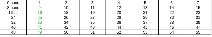

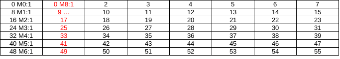

17 Sep 2023 10:32 - 17 Sep 2023 10:40 #280991
by panming
Replied by panming on topic Matrix Keyboard controlling LinuxCNC
It still looks like something is wrong, when I set LedGndPins and rowPins to be the same and send M1:1, the panel looks like this(first attachment)
The number is the name I gave them, if normal he should be numbered this way. After the number is the feedback value of the button, the green unit represents the LED flashing, and the red represents normal brightness.
when I set LedGndPins and colPins to be the same and send M1:1, the panel looks like this(second attachment )I don't know what causes it, which two arrays should I set to be the same. Or do I have a problem wiring.

17 Sep 2023 11:45 #280992
by AlexMagToast
Replied by AlexMagToast on topic Matrix Keyboard controlling LinuxCNC
can you please post the settings you use in the second configuration?
The rowPins are Pullup Inputs, so they should not be used twice.
The ColPins are GND Pins for the Matrix Keyboard and the LEDs.
so set colPins und ledGndPins to be the Out0-8 Pins.
When you wire it like this and send M1:1 the all red numbers light up simultaneously?

17 Sep 2023 12:00 - 17 Sep 2023 12:02 #280993
by panming
yes,Yes, they lit up at the same time. And, when I type M1:0, they don't turn off, but when I type M2:1, several LEDs of M1 turn off.At the same time the third column began to light up, i.e. 2, 10, 18...

17 Sep 2023 12:28 #280995
by AlexMagToast
get the latest Code from Github.
It works in my test.
Also i think you misunderstand the use of the command.
the Number after M represents one LED. So looking at your table, each Number is one LED and can be written by one M code.
So only type M0:1 it should only turn on LED 0. (top left corner).
Also the way your keyboard is wired, i think it might be numbered differently.
ive changed the code to cycle through all the LEDs once / loop, therefore it should work better now, without the flashing.
