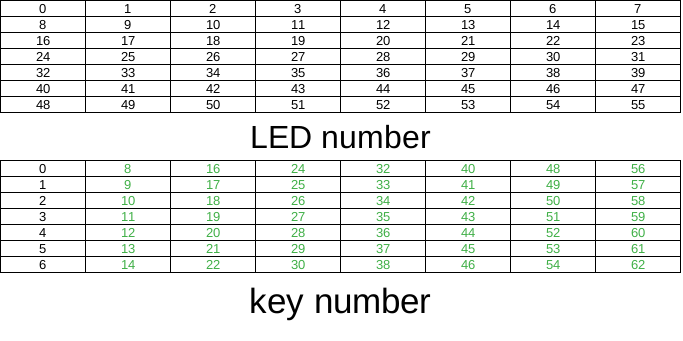

Ah yes, so when you press a button, it also sends M(number of Key):(State).
It is a bit confusing, sorry. It uses the same Letter, but is different Signal, but good to see, it working.
I've changed the code again. Now it works on my test setup without flickering.

The LED and the keys can work normally, the only problem is that the numbers do not correspond, although it does not affect the use, but I think it will be very confusing when installing the machine, if you are free, can you help me fix this bug? thanks.
Below is a numbered table.

so it works?
Yes i was expecting the numbers to be different.
I turned them by 90° to fit your setup.
Does it work with LinuxCNC too?

Yes, they all work, and when I type M:1, the first row and second column LEDs light up. When I pressed the buttons in the first row and second column, Arduino's serial debugging tool showed M8:1.

I don't know if I understand the program correctly, but I found that the names of the pins are in an array called CHARS, and the 56 keys mean that I have to use almost all capitals and lower case letters and numbers, which I think can be a bit confusing.

There are 2 Arrays you need to set up. Chars and Destination.
The Keyboard implementation is made to fit hopefully all kinds of matrix keyboard usecases. So there are 3 modes for each Key you can specify in the Destination array.
I think in your case you want to set it all to 0, this will create LinuxCNC hal pins for each key. You have to create 56 entrys with 0.
In Chars you can name your keys. As you want hal pins you can name them the key numbers aka ["0","1","2",......"54","55"] or something which helps you identify your key aka ["on","off","sp_left",sp_on","sp_right","sp_off", .... ] or whatever name you want to give your keys. Again you have to set 56 entrys. These will be used when creating the LinuxCNC hal pins by the software.
