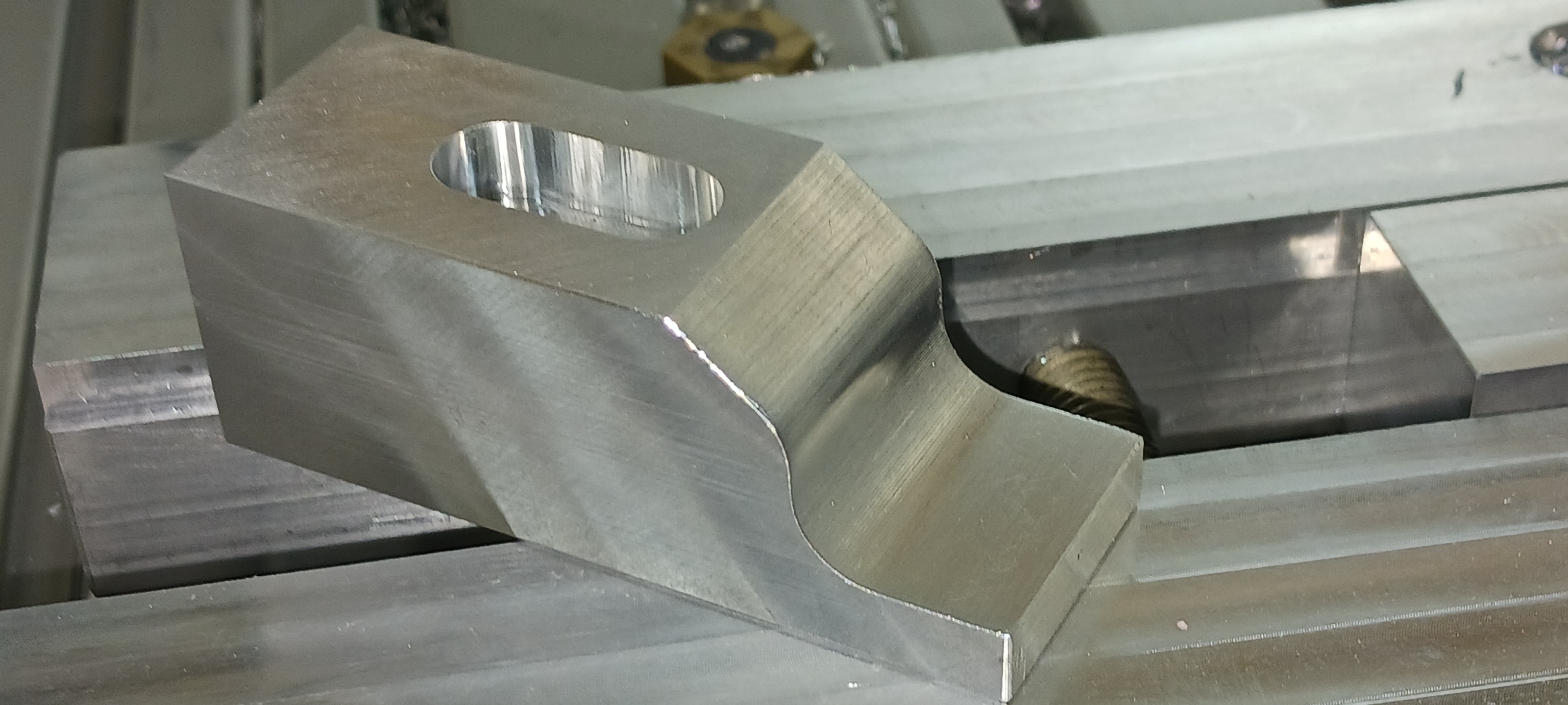

starting my first real project with this machine to give it a real test actually making something. i would probably go about doing these different if i had more to work with but it was a good test on what i think will be a strong point with this machine. A picture of the end result and a video link if you want to see how the machine did.

05 Apr 2024 20:39 #297667
by machinedude
Replied by machinedude on topic What do you really get for a $350 desk top engraver ?
i came into about 200 lbs of random off cuts and have to square a lot of material so it's not so random in size. did another test with a 1/2 3 flute to see how the bigger cutter would do. The machine did fine but my homemade work holding is the weak link
the parts are starting to lift up so not very practical but fun to watch
.03 DOC @ 625IPM with almost full width of the tool for a stepover.

30 Apr 2024 04:35 #299371
by machinedude
I had some time to try out some new work holding, and it does open up ways to go about secondary operations. But what i noticed is working holding factors into these little machines quite a bit. when you start getting into thicker pieces. radial cutting becomes a pain when you want a good finish. one other thing i don't care for with the new clamps is the fact that you have to count on aluminum threads. over time they will fail due to wear and since it is part of the clamp that will become a problem at some point. So i think i will try a new approach with a 3 part clamp that uses the steel T nuts for the clamping force. once I thought of it i was like stupid simple is a Plus sometimes
one other thing i was working with was the uses of work offsets. and came into the issue of table variation on the Z axis. i wanted to try not skimming the table top but i think if i do it will make things much more simple in the long run.
i actually am waiting for some solid carbide High-feed mills to try too. I think they might work well with this machine they are not cheap but if they work well it is what it is and you just suck it up
