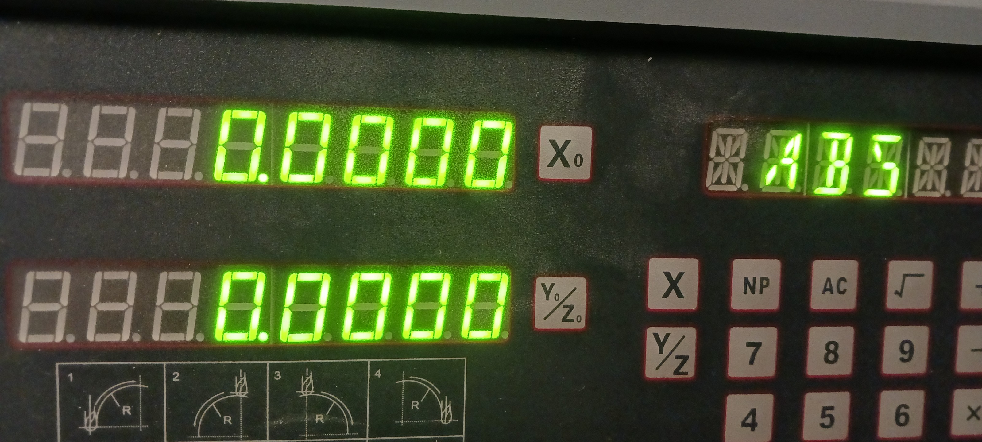

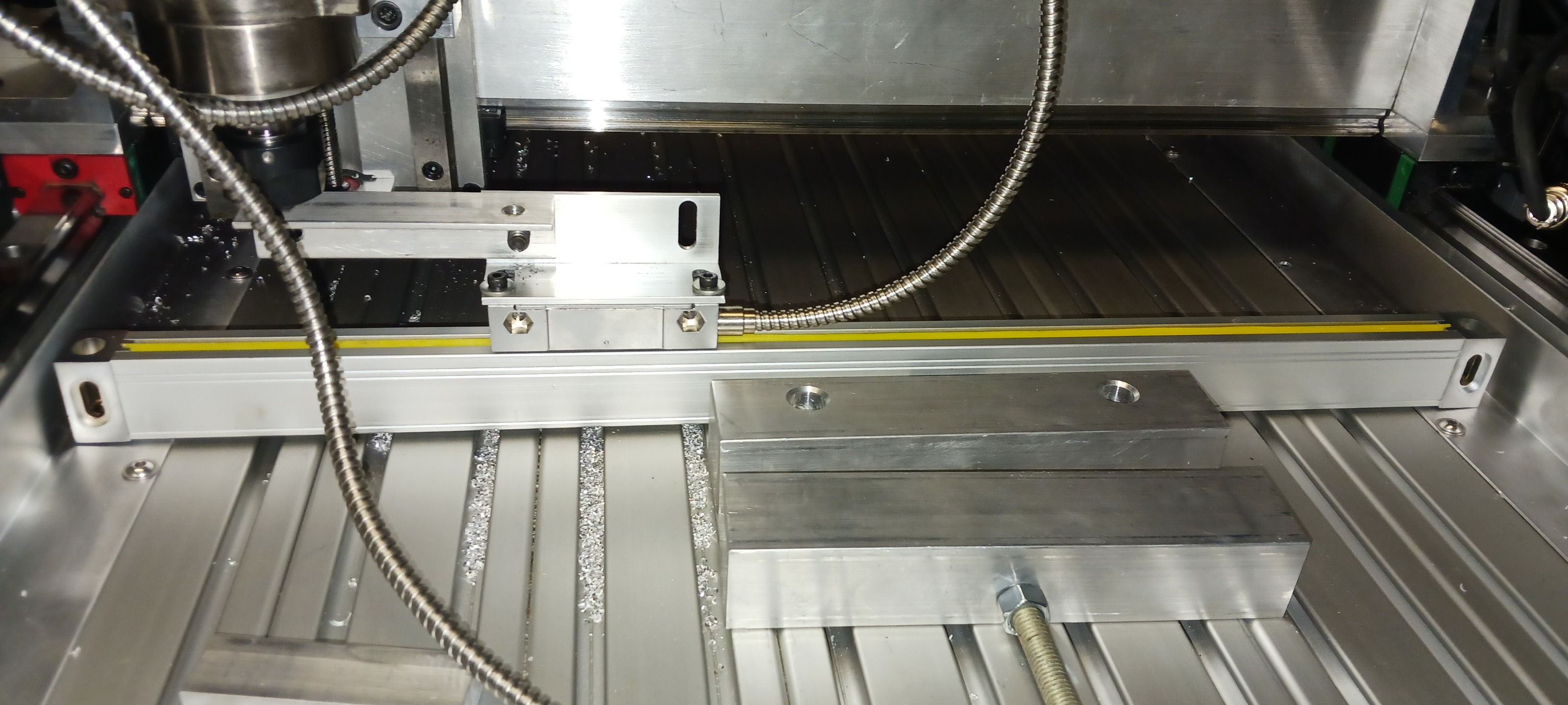

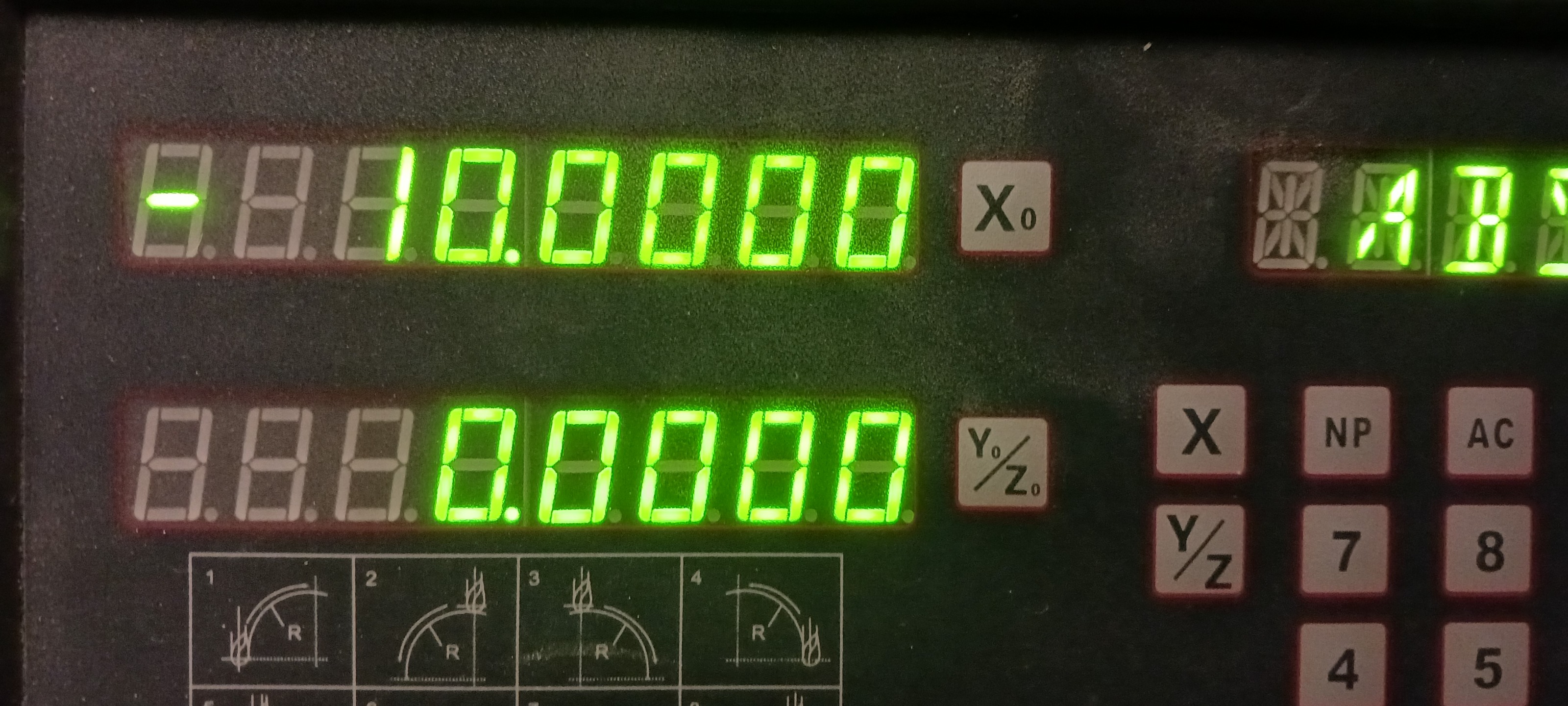

13 Mar 2024 11:17 #295819
by machinedude
Replied by machinedude on topic What do you really get for a $350 desk top engraver ?
since i have linear scales around and a spare DRO i wanted to try this opposed to a dial indicator reading over a small distance. it worked really well. i was really curious about how accurate a belt is over the rolled ball screws everyone uses. over a 10" distance i was able to dial things in really close and test to see what is going on in the middle as well. i think if memory serves me well a rolled ball screw are only accurate to .003 to ,007 per foot as far as lead accuracy goes. these belts float around between 0.000 to .002 over 10" and i don't need any backlash comp either. the glass scales worked well for all this.
