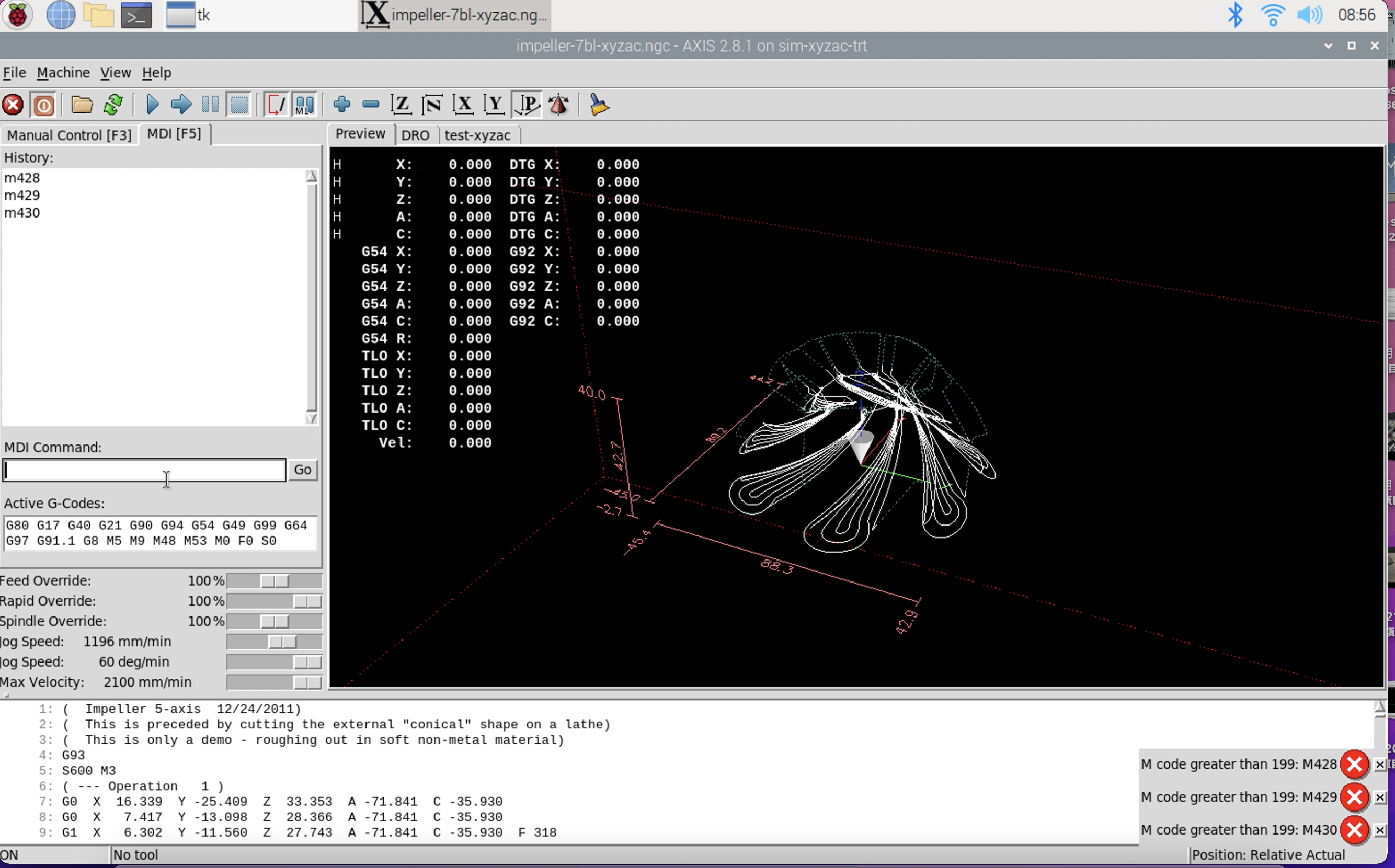

Thank you all for your responses.
I did some test based on your responses.
But M428,M429,M430 are not working.
I am wondering if Mr mydani's comments on this issue could solve this problem.
But due to my lack of knowledge, I do not know what to do with this useful information.
Please let me know exactly what I should do.
Actually, I have a configuration I would like to use.
It work, but M428,M429,M430 do not work.
I am attaching a picture to more accurately convey my problem.
Last edit: 26 Mar 2022 01:46 by daidai.
29 Mar 2022 20:48 #238651
Replied by andypugh on topic TCP 5-axis kinematics
What are M428 (etc) meant to do? Those are not standard G-codes as far as I know.

02 Apr 2022 03:50 #239046
by daidai
Replied by daidai on topic TCP 5-axis kinematics
I'm sorry. My explanation was bad.
What I want to use is switchable kinematics.
github.com/LinuxCNC/linuxcnc/commit/135b0ce52
I'm not very good at using Github and programming, so I'm not understand how I can get the latest switchable kinematics to work.
If possible, please let me know the specifics method.
02 Apr 2022 16:58 #239084
Which LinuxCNC version are you using?

- daidai
- Posts: 14
- Thank you received: 3
02 Apr 2022 22:27 #239111
by daidai
The current version of linuxcnc is 2.8.0.
Are you saying I need to upgrade to 2.9.0?
