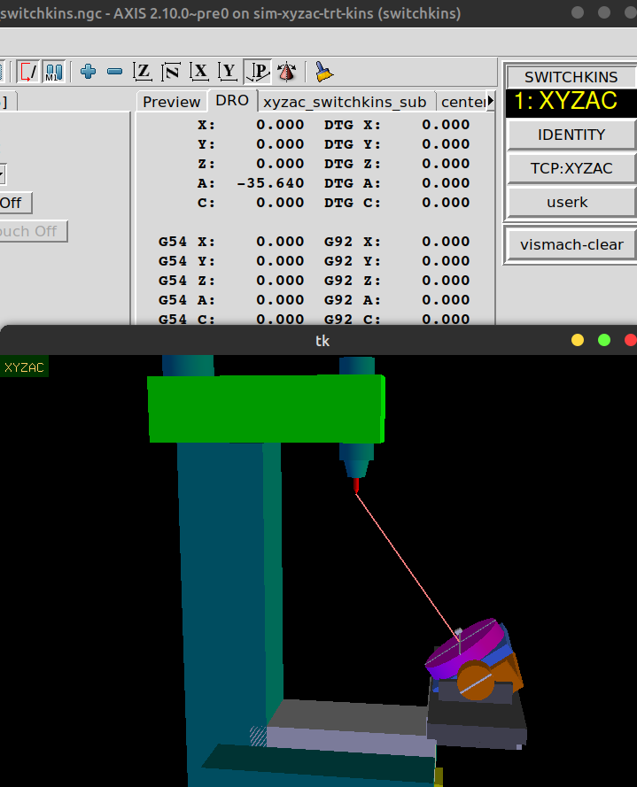

08 Feb 2023 03:32 #264016 by Aciera
Replied by Aciera on topic TCP 5-axis kinematics
Ah, yes that is what I suspected. Since your '(x,y,z)-rot-point' values are all zero you are telling the kinematic that the the machine reference point is also the face center of your c axis table.
This is from the file xyzac-trt.txt as found in the folder 'configs/sim/axis/vismach/5axis/table-rotary-tilting':
Hal Input pins:
  xyzac-trt-kins.x-rot-point
  xyzac-trt-kins.y-rot-point
  xyzac-trt-kins.z-rot-point
X, Y and Z rot-point pins represent the
offsets of the center of rotation of the C axis
relative to the machine absolute zero
So in your case you would need to set 'xyzac-trt-kins-z-rot-point' to -215. Really I would suggest to put a dial indicator in the spindle and probe the face center of your rotary c and put the found absolute coordinates into the (x,y,z)-rot-point settings.

08 Feb 2023 04:10 - 08 Feb 2023 04:46 #264020 by Aciera
Hmm, that doesn't look right. Maybe try 'z-rot-point' value the other way around (ie 215 instead of -215).
[edit]
I just changed the 'xyzac-trt' sim config to a machine that homes 215mm above the center of the rotary c table and it seems to be working fine with these settings in the ini file:
HALCMD = sets :y-offset     0
HALCMD = sets :z-offset     -29.70
# not currently supported by xyzac-trt-gui:
HALCMD = setp xyzac-trt-kins.x-rot-point 0
HALCMD = setp xyzac-trt-kins.y-rot-point 0
HALCMD = setp xyzac-trt-kins.z-rot-point -215
So I'm not sure what's going on in your configuration.
