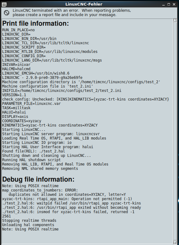

04 Jun 2022 07:26 #244560 by mittim
Replied by mittim on topic TCP 5-axis kinematics
Has no one an idea, what´s the issue here?
04 Jun 2022 08:16 #244564 by jurod
Replied by jurod on topic TCP 5-axis kinematics
You send the entire configuration file. (.hal, .ini, .....)
04 Jun 2022 09:28 - 04 Jun 2022 09:31 #244566 by mittim

[KINS]
JOINTS = 6
KINEMATICS = xyzac-trt-kins coordinates=XYYZAC
[TRAJ]
COORDINATES =  xyyzac

04 Jun 2022 11:39 #244570 by jurod
I have the Y2 axis in my HAL as JOINT 6.
Compare my configuration file. ()
From example .ini:
# complex example (duplicate coord letters for y, 7 joints):
# type0:5axiskins, type1:identity, type2:userk
# x:joint0
# y:joint1 AND joint6
# z:joint2
# b:joint3
# c:joint4
# w:joint5
JOINTS = 7
KINEMATICS = 5axiskins coordinates=xyzbcwy
04 Jun 2022 16:38 #244577 by mittim
Still getting the same error message from LinuxCNC when changing
coordinates=xyyzac to coordinates=xyzacy.
05 Jun 2022 06:21 #244599 by jurod
have you reworked the entire HAL?  AxisX=joint0=stepgen00=coordinates=x
                                                           AxisY=joint1=stepgen01=coordinates=y
                                                           AxisZ=joint2=stepgen03=coordinates=z
                                                           AxisY2=joint6=stepgen02=coordinates=y
05 Jun 2022 07:44 - 05 Jun 2022 07:45 #244602 by mittim
Thanks for the reply. I changed the joint numbers in my HAL and INI according to xyzacy. Still getting the same error message.

[HMOT]
# **** This is for info only ****
CARD0=hm2_7i95.0
[HAL]
HALUI = halui
HALFILE = test_2.hal
HALFILE = custom.hal
POSTGUI_HALFILE = postgui_call_list.hal
SHUTDOWN = shutdown.hal
POSTGUI_HALFILE = spindle_to_pyvcp.hal
[HALUI]
[KINS]
JOINTS = 6
KINEMATICS = xyzac-trt-kins coordinates=XYZACY
[TRAJ]
COORDINATES =  xyzacy
MAX_ANGULAR_VELOCITY = 360.00
DEFAULT_ANGULAR_VELOCITY = 36.00
LINEAR_UNITS = mm
ANGULAR_UNITS = degree
DEFAULT_LINEAR_VELOCITY = 2.50
MAX_LINEAR_VELOCITY = 25.00
[EMCIO]
EMCIO = io
CYCLE_TIME = 0.100
TOOL_TABLE = tool.tbl

05 Jun 2022 17:36 #244633 by mittim
It looks like my LinuxCNC 2.9 Version is too old to support duplicate digits. I will have to upgrade.
