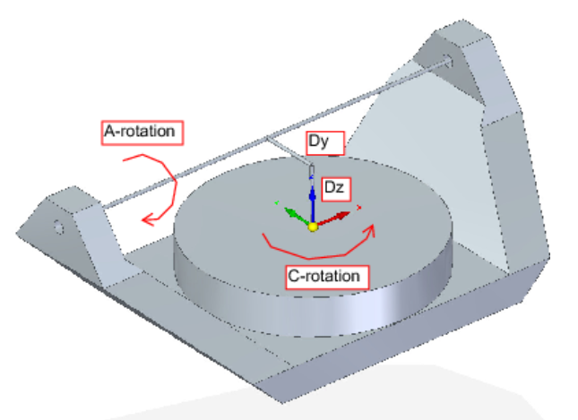

Isn´t the W axis for a head-head configuration? I have a table-table configuration.

I reinstalled buster 2.8.2 and updated to the buster master-rtpreempt. Now it is working

I am trying to understand TCP in combination with G28. While staying in TCP mode for the whole program, is the G28 position in space bound to the moving coordinate system? I am asking because of safe retracts. In joint mode, a safe retract with G28 could be considerd a safe position in machine space, but with TCP on, G28 position could move in machine space?

I think that G28 happens in joint space, but I wouldn't want to assume that without testing.
So... Load one of the 5-axis simulators with a graphical machine model and see what happens there?
sim/axis/vismach/5-axis is the place to look, in the sample configs.

I was wondering, is it possible to use
in trivkins? It should be I guess, otherwise switching between two kinematic modules, which do not both support these offsets, the coordinate system would be displaced in space?
setp xyzac-trt-kins.y-offset
and
setp xyzac-trt-kins.z-offsetin trivkins? It should be I guess, otherwise switching between two kinematic modules, which do not both support these offsets, the coordinate system would be displaced in space?

No, trivkins has no idea about those offsets and does not create those pins.

Is there an existing kinematics module, which takes these two offsets into account without using TCP?
