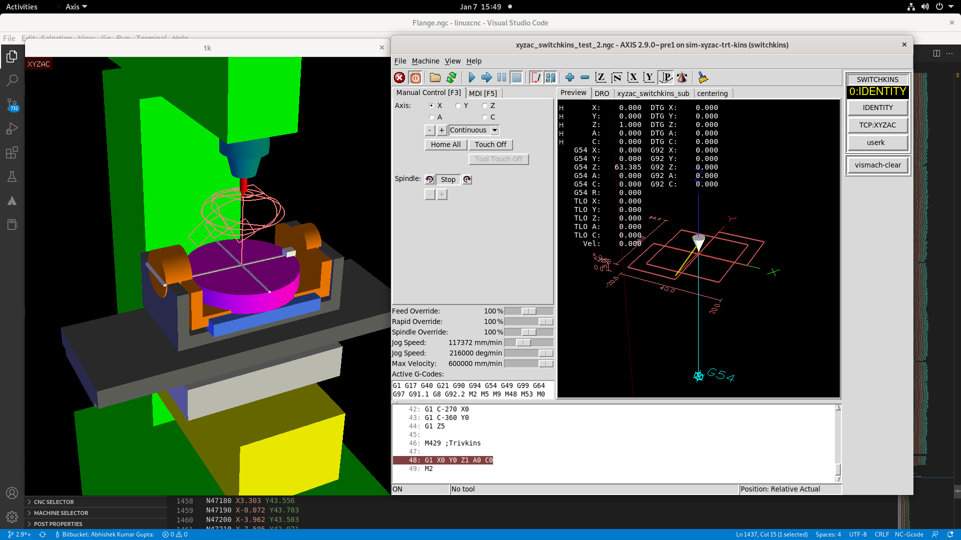

I got my 5-axis up and running but when I run a 5-axis demo the simulator shows some bizarre figure which does not match our demo figure at all.
Now i don't know what might have gone wrong
Does anyone have any idea why it is showing like this?

Replied by Aciera on topic TCP 5-axis kinematics
I'm not quite clear what you have there, it doesn't look like the regular simulation config that comes with the installation. So what did you change? the kinematics, the vismach model of the machine, the gcode?
[edit]
Just a stab in the dark, but for the simulation to work you must not change these values in the ini file:
# not currently supported by xyzac-trt-gui:
HALCMD = setp xyzac-trt-kins.x-rot-point 0
HALCMD = setp xyzac-trt-kins.y-rot-point 0
HALCMD = setp xyzac-trt-kins.z-rot-point 0
Last edit: 07 Jan 2023 17:04 by Aciera.

I haven't change anything apart from velocity and acceleration.
I don't think it should have any impact on the shape of the simulation

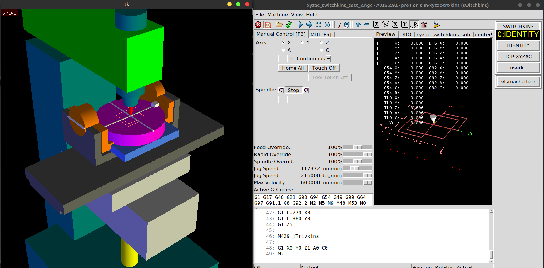

09 Jan 2023 07:40 #261336 by Aciera
I just tried your ini on my 2.9.0 and it works fine for me. However the colors on your vismach model are different that makes me think that it may have been modified. I'm not positive but i think the offsets do not correspond to what you have in your ini. Just compare with this using your ini file:

09 Jan 2023 12:35 - 09 Jan 2023 12:37 #261347 by Aciera
I built my 2.9.0 directly from the git repository but I don't think it matters really where you get it from.
One way to troubleshoot is to start the HAL configuration tool in the linuxcnc menu and check the pin values for "table-x" and "saddle-y" for the gui and the kins modules.
I just checked the vismach model code you posted and it's identical to the one in my installation.
If that is the actual file you are using I have no explanation for what you are seeing. It's rather unlikely to be due to some tkinter error as I would expect that in that case the config would not run at all.
I'll attach the compessed sim folder here so you can unzip and drop that into your installation tree. Note that the vismach model and the kinematics are not included but I doubt that those are the root of the problem if you haven't change them.
