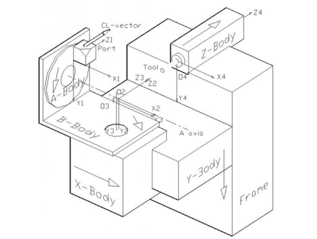

I suspect there is a fair bit of turning done on the machine with the spindle treated as a live tool which would explain their choice of kinematics.
Can anyone help me bring them on board with Linuxcnc?

Shouldn't be more complicated than the kinematics for the existing XYZBC- or XYZAC-trt kinematics. Maybe this helps:
forum.linuxcnc.org/media/kunena/attachme...5-axis-machines2.pdf
Don't let the matrix syntax scare you off, behind the scenes it's just a lot of trigonometry (sine/cosine). It's not as bad as it looks but it's tedious work to do by hand.

Do you need help creating the vismach model or the kinematics?
It would help to get a bit more information on the actual machine eg. the sense of positive direction of the A and B axis. It's just nice to get the model right the first time.
[edit]
Note that it is not just the Z axis that differs between the diagram and your image in the first post. In the image the B axis rotates with the A axis while in the diagram its the other way around. That kind of detail is important since the kinematic model will not be the same for both of those setups. So identifying the correct arrangement of the actual machine in question is the first step or you will be redoing the same work all over again.

You are right. I had not noticed the different orientation.
The machine is mostly used for jewelery molds cut from wax. It uses a 50000 rpm spindle with 4mm dia tooling. Because there are no cutting forces it just uses open loop NEMA 24 steppers and they reckon a tool could last 12 months!
I'll find out a bit more in terms of the dimensions. I think the A & B would be positive in the direction of the arrows.
They are not happy with their current Windows solutions as they can't get all axes moving smoothly at the one time. They'd like to migrate to Linuxcnc with a Mesa card and have asked for help. Initially I made the same mistake as Tommy, then I realised we don't yet have a Linuxcnc kinematics for XYZAB.
On the other 5 axis thread I linked to, Dewey Garrett said he'd be happy to merge other kinematics models into the core code so it would be good if we could use this opportunity to build an XYZAB-trt module.
But I have no clue about matrix algebra. I figure once the formulas were resolved I could code it in C.
I have not looked at Vismach yet but there is a a good start in the bridgemill sim and I thought I could manage that side of it for a proof of concept.. Long term, I wanted to build a model using STL's of the actual machine.
So in answer to your question, I need help with the maths to start with.

You then have to swap both X-Y and A-B on the diagram to have the correct representation of the machine.
Replied by JPL on topic Kinematics for XYZAB mill
@rodw: Also note that the machine X and Y and inverted on the diagram. The picture on the machine show that the X axis is front-back, not the usual left-right depicted on the diagram. The whole (half) trunnion then rotate around the A axis, while the rotary table (B axis) rotate around the Y axis.... Note that it is not just the Z axis that differs between the diagram and your image in the first post. In the image the B axis rotates with the A axis while in the diagram its the other way around...
