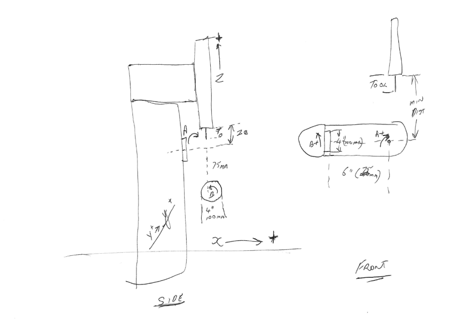

Replied by rodw on topic Kinematics for XYZAB mill
Thanks, its slowly sinking in. That was very helpful.
For our XYZAB mill, I think we should be looking for
WAT = WAB . BAY. AAP. PAT
Does that sound right?
I need to redo Figure 3 for our new model.
And yes, the tedious part is yet to come..

For the image in the opening post I would say :
WAT = WAB * BAA * AAP * PAT
(which is probably what you meant)
for the diagram you posted later:
WAT = WAA * AAB * BAP * PAT
This is under the presumption that the rotary axes A and B intersect.

Grotius, I will look further at your work. I really want to keep it in bounds of linuxcnc
Yeh, this is what I meant.
A&B have to intersect
I did up a bit of a sketch of how I see the machine from the public specs (from the first post) Note 6" should be 3"
I'll keep plodding away
