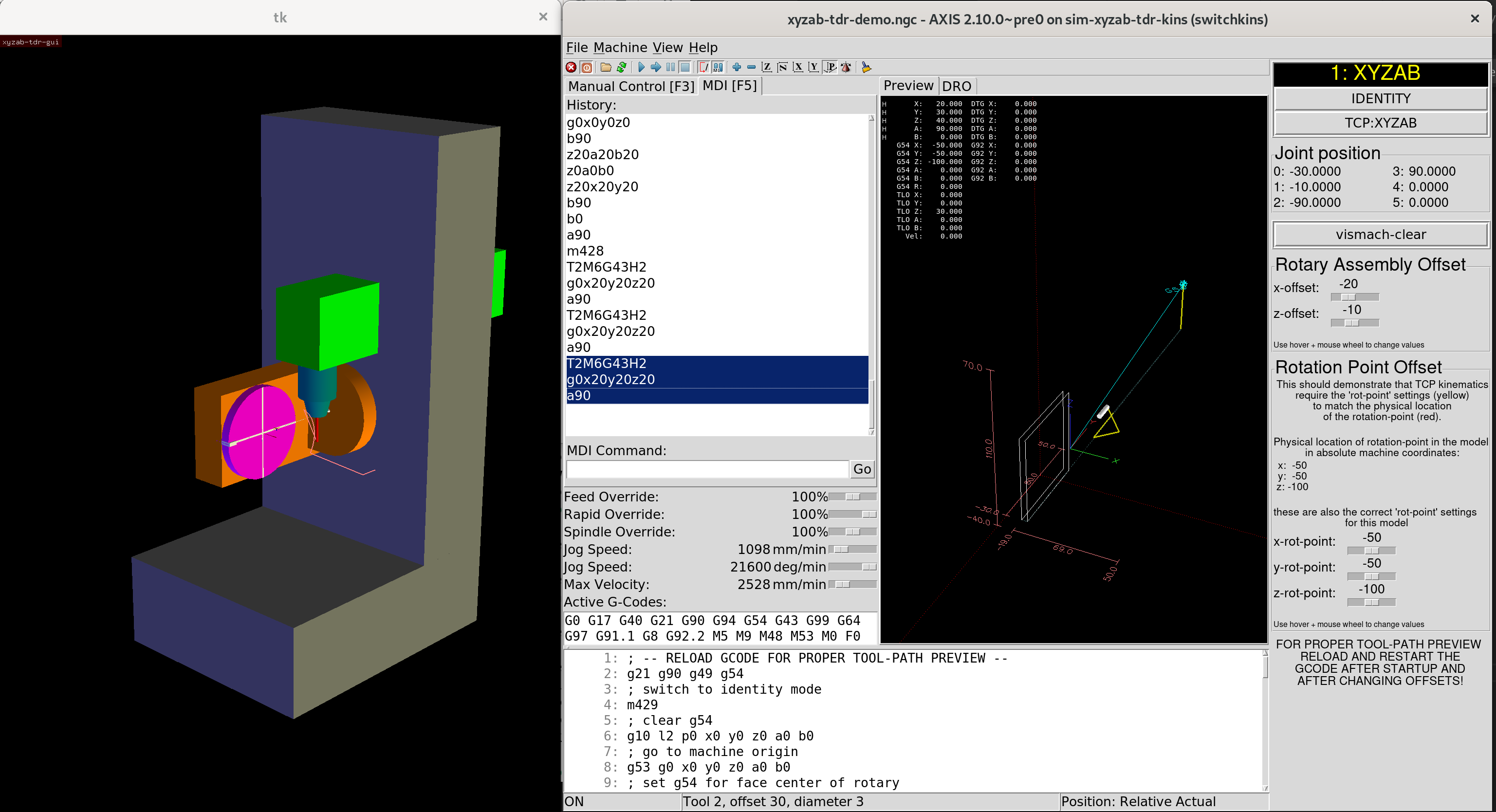

Hi Aceria,
These seems to be some problem with the kinematics when using the x-ioffset and z-offset and I am not able to pinpoint it and propose a solution.
I am the original author of switchkins and the idea behind switchable kinematics was that you could switch between machine kinematics without any physical motion of the machine.
Doing the following sequence of actions results in machine motion during kinematics switching
1. Start the xyzab-tdr config
2. x-offset = -20, z-offset= -10, rotation center point = (-50,-50,100)
3. home the machine and switch to MDI mode - still with identity kinematics
4. T2M6G43H2 - this will add a tool with length of 30mm to the Z axis
5. G0x20y20z20
6. G0a90
7. Switch the kniematics to XYZAB kins using the pyvcp button OR M428 and then switch back to identity and watch the machine go for a ride in the vismach window. This can also be observed in the machine coordinates
Now if the x-offset and z-offset are kept to 0, this movement does not happen.
In the forward kinematics, dz seems to be taken into account but dx does not seem to be.
While in the inverse kinematics, dx and dz both are taken into account.
Can you help me take dx and dz correctly into account in the formulas?

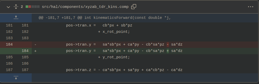

Automata, thanks for reporting this!
I totally agree, looks like I got a bit overzealous when i cleaned up the math in the comp and just ran the demo code to test. I just quickly tested with an earlier version and it works fine there. I'm just headed out the door for a repair job but will be back later with the patch.
[edit2]
On closer inspection it seems that I only got a sign in the forward kinematic wrong when I manually cleaned up the math. The fix has just been committed to the source.
Thanks again for the report.
