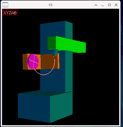

Thanks Dewey, I just cobbled a comp together.
I got all enthusiastic and made a sim-config too (requires 2.9 as it uses switchable kinematics):
[Superceded by forum.linuxcnc.org/10-advanced-configura...mill?start=60#258432]
To install the kinematic comp:
$ halcompile --install halcompile --install <yourpathhere>/xyzab_trt.comp
I also whipped up a vismach model called 'xyzab-trt-gui.py' which you might need to set as executable.
All very good, only that the kinematics don't seem to be right or the vismach model isn't or both.
Anyway I'm out of time again...

Turns out all those sin² and cos² might cancel out.
Would be great if somebody could look that over (still doesn't fix the kinematic though):
Andy, my motivation is to understand how those kinematics were derived in the first place. Would be nice to be able to create a proper kinematic instead of trying to fiddle around with something that doesn't quite fit the requirements.
Although I have to admit I'm not exactly crushing this, yet.

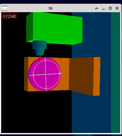

Awesome thank you. Your interpretation of the machine is perfect!
It looks like the A axis is rotating the wrong way as shown here. I bet thats just not as easy to fix as changing the sign!
I started with the B axis at the bottom (eg arm vertical) with the spindle touching one of the white lines on the B axis table.
Jogging A generated the current tool path.
I think the B axis is OK as I can scribe a circle when the arm is horizontal.
@Dewey, thanks for the succinct summary. I was thinking more along the lines of having this included in KINS so it could be installed in the same way as XYZAC-trt et al but I guess that can be discussed after its debugged.
Its been very awesome work by a great team

So from what I can see the error is in the original term AAP because the signs of the sines have not been inverted as mentioned in the original model at the top of page 5
- Posts: 12156
- Thank you received: 4149
02 Dec 2022 22:58 #258385
I went through this all for my own benefit. (25) changes some signs around and becomesI think that makes sense because any term that includes Sa inverts the sign
I don't yet understand how to get to 26 but you could follow the same logic and chane the sign of terms containing Sa I guess.
Replied by rodw on topic Kinematics for XYZAB mill
Cb.Px - Sa.Sb.(Px-Dy) + Ca.Sb.Pz
Ca(Py-Dy) - Sa.Pz + Dy
Sb.Px + Sa.Cb.(Py-Dy) + Ca.Cb.Pz
1I don't yet understand how to get to 26 but you could follow the same logic and chane the sign of terms containing Sa I guess.
- Posts: 12156
03 Dec 2022 00:30 #258389
Got it!
It was just the matter of inverting the signs for any term in the kinematics model containing
revised comp attached.
sin(A)revised comp attached.

For those of you following along and don't have 2.9 installed, here is a quick video of Aceria's amazing simulation with revised A axis rotation...
A big thanks to all.
EDIT: Replaced video followig kinematics revisions.
