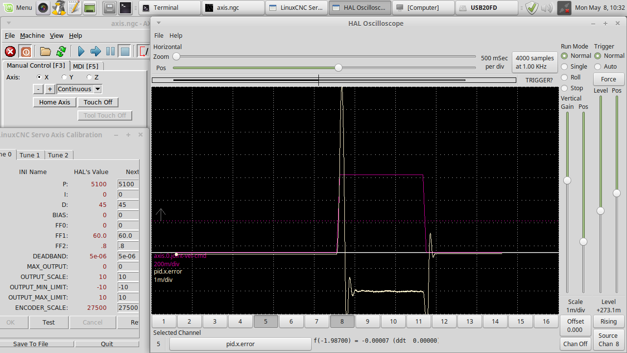

Replied by Todd Zuercher on topic Prototrak Plus Retrofit with Mesa 7i77 & 5i25 cards

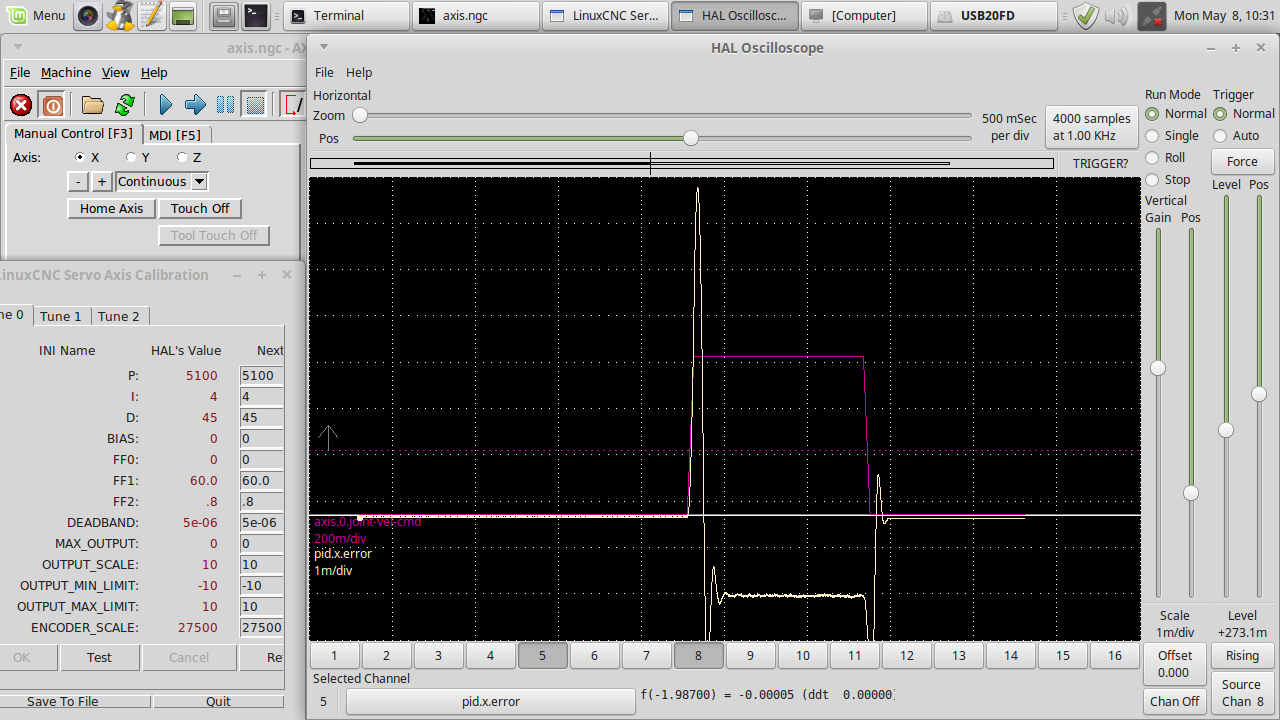

That would be expected behavior. Increasing P will decrease following errror, but will also increasingly become more and more unstable, until at some point it goes completely out of control.
You need to increase D until you only have one small bump of over shoot, instead of the half a dozen (or more) wild oscillations you have now. If you find a point where increasing the D causes the system to become unstable, set D to about 2/3s the value for D that made it unstable and you will have to reduce your P until those oscillations are under control. (The I should be set to 0 while doing all this.)
Then use FF1 to get the cruising following error as close to 0 as you can.
Then use FF2 to try to smooth out the error during acceleration as best you can.

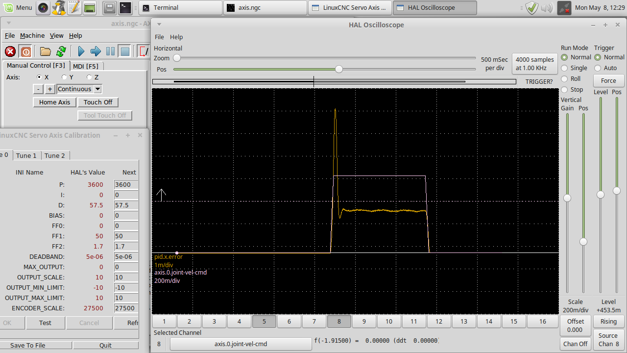

08 May 2017 15:53 #92829

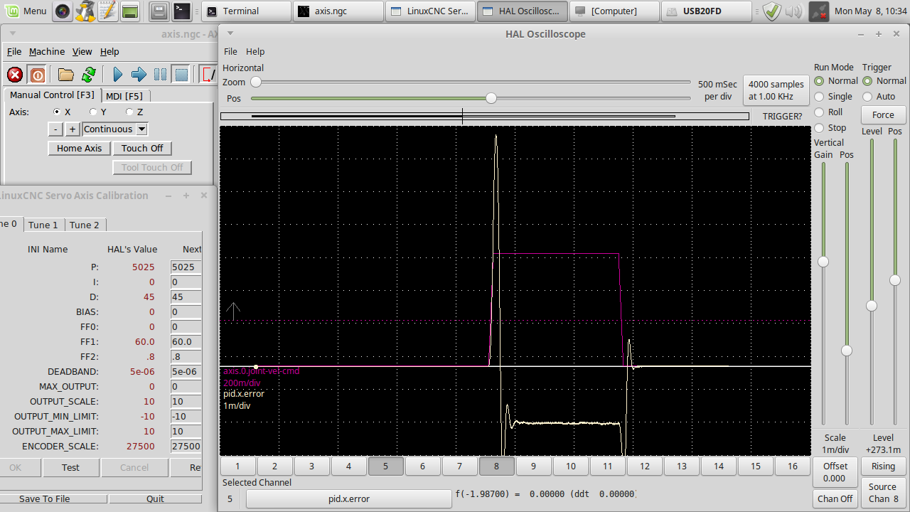

Too much FF1. (causing you to have a negative following error while cruising.)
Does more FF2 reduce the following error on acceleration further?
(I think there is still too much over shoot, so more D and/or less P. it will be hard to tune the FF2 until you get the overshoot under control.)

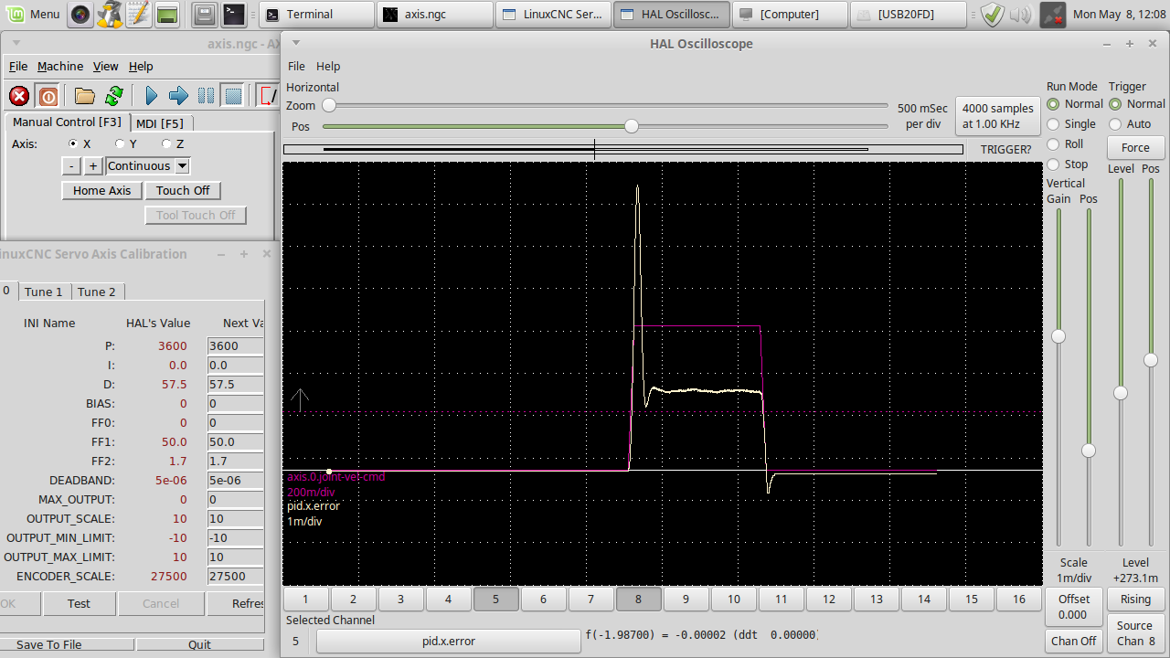

08 May 2017 16:02 #92830
It is also possible your your max acceleration could still be a hair too high, causing a big following error during acceleration because the motor just can't quite catch up to the commanded position.

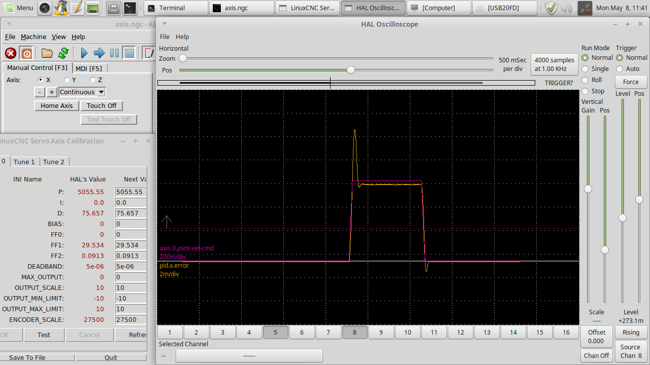

08 May 2017 17:49 - 08 May 2017 17:55 #92843
by new2linux
Replied by new2linux on topic Prototrak Plus Retrofit with Mesa 7i77 & 5i25 cards
Many thanks!
This is screenshot going max acceleration (in the .ini file) from 17.0 to 16.5.
I need to look at these to ponder some myself.
Many, many thanks!
Edit: Compare the bottom pic of this to top pic of prior post, all settings the same except ini file. I believe the prior setting (17.0) is best, less f.error.
Many, many thanks!
Last edit: 08 May 2017 17:55 by new2linux. Reason: after review

I might be tempted to try 8. See if that makes the machine seem sluggish. Unless you plan on doing a lot of 3D-profiling work you might not need to be hard against the machine physical limits. And even then you could probably limit the fierce acceleration to the (light?) Z axis.
Replied by andypugh on topic Prototrak Plus Retrofit with Mesa 7i77 & 5i25 cards

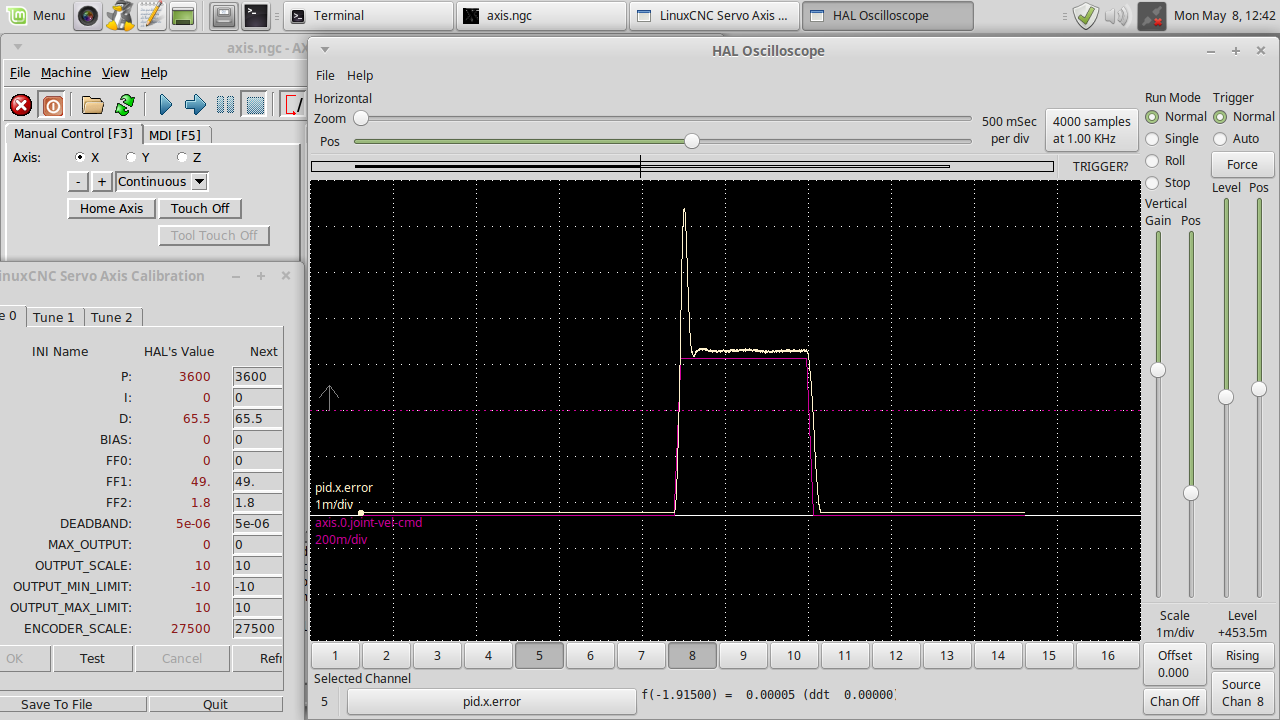

Can you go back to having the hm2_5i25.0.encoder.00.velocity shown on the trace as well, so we can see how well the actual velocity matches up with the commanded.
(Remember you are trying to make the following error trace be as close to a flat line on zero as you can, not make it follow the the velocity command trace.)
In the last copy of your ini file that you posted on May 5. You still have the Max_acceleration for X set to 30 (you have Y set to 17)
These last halscope traces you posted were done on the X axis and they seem to imply that the X axis acceleration is still too high.
It is showing nearly a 1 inch following error during the acceleration phase of the move.
# Axis X
[AXIS_0]

08 May 2017 18:21 - 08 May 2017 18:22 #92854
Isn't that 6 milli-inches? Or am I misunderstanding?
(I had been interpreting it as microns, and thinking it looked quite good)
Last edit: 08 May 2017 18:22 by andypugh.

Todd, thanks for your kind advise! Yes the ini file was edited and saved.
andypugh, thanks for your thoughts, this is just 2 axes machine, currently. The rapid travel seems just a little slow, but I can live with it.
many thanks!!
