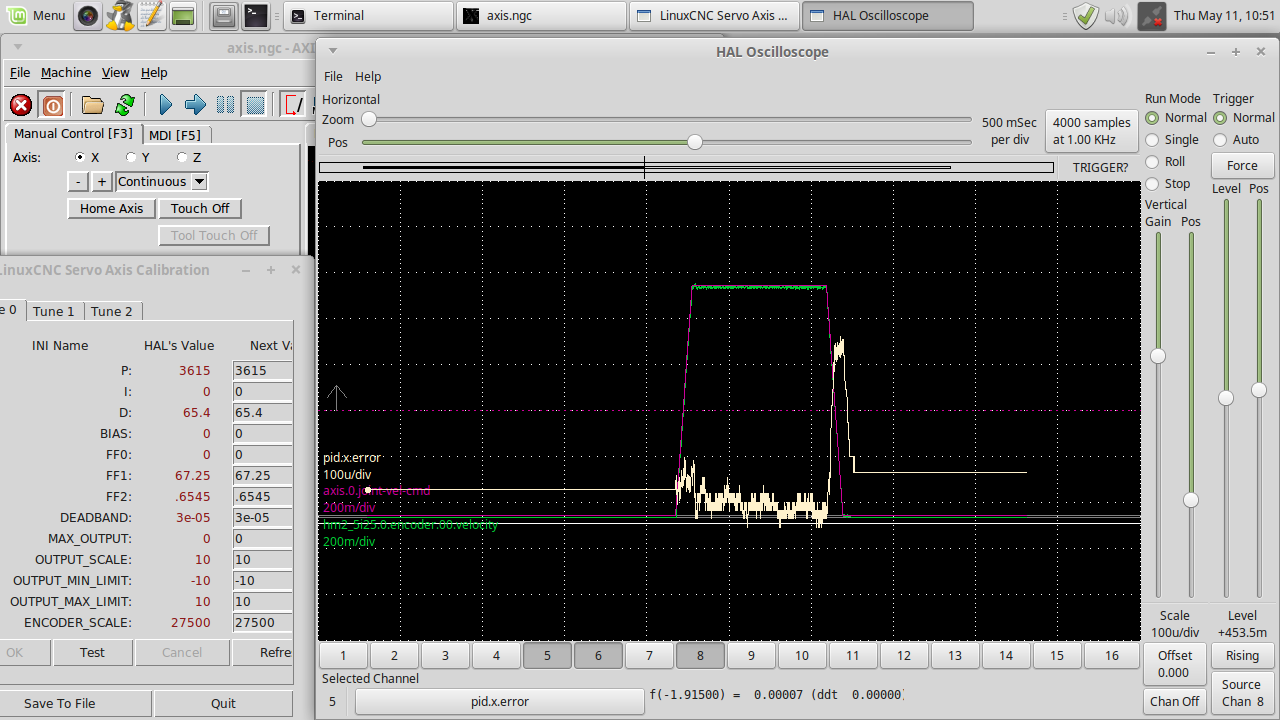

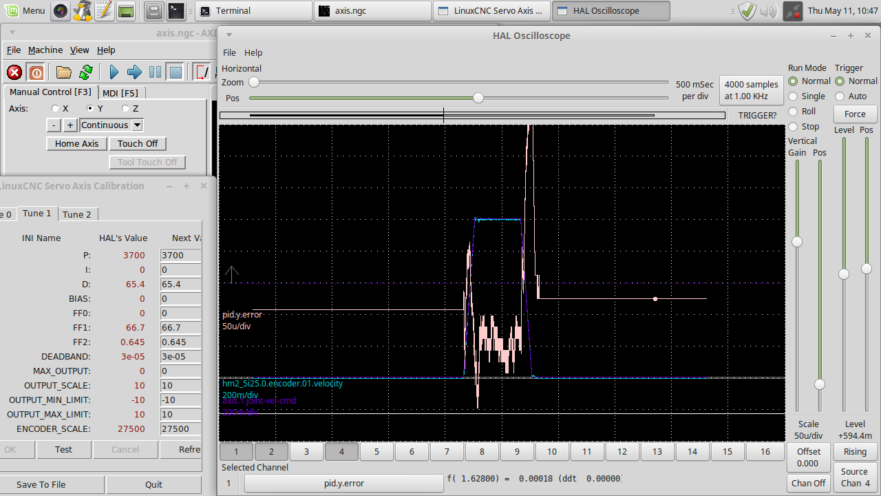

11 May 2017 16:55 - 11 May 2017 18:16 #93034
by new2linux
Replied by new2linux on topic Prototrak Plus Retrofit with Mesa 7i77 & 5i25 cards
Todd, Thank you!!! Could not of tuned it w/o your advise.
The z is not necessary just now. I think I will try the demo soon.
Thanks!
Edit: I change the "ferror" and "max ferror" (i think this was the .ini files edited to 1.0 each) and that fixed "joint 2 following error".
My question is how to make program stop for manual "z" setting? It runs the sample program, just wont stop for manual setting.
Thanks!
