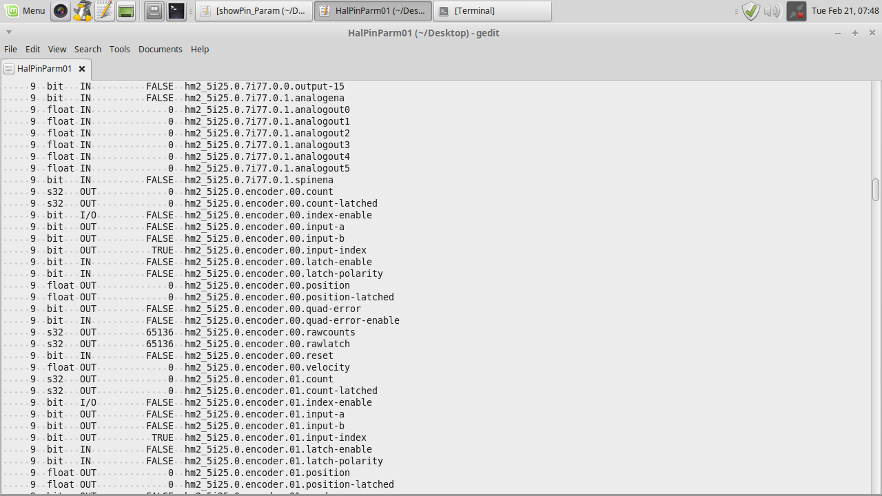

21 Feb 2017 14:19 #88426
by new2linux
Replied by new2linux on topic Prototrak Plus Retrofit with Mesa 7i77 & 5i25 cards
andypugh, many, many thanks! for the correct way to test encoders, the encoders show motion in both of the configurations of (TB3 & TB4) ENCODER 2 & ENCODER 3 with (TB5) DRV 2 & DRV 3; and the preferred 00 and 01 for "x" "y".
This screen shot is of the "show pin and parm" set of files.
If you look at the top you can see the files in question:
hm2. analogout0 etc. to analogout5
I am not completely shore if using "halrun" to gain access to the "setp"? Do I "copy" or "key in" the files as shown, starting with the "hm2", preceded with the "setp" command? Then use the "start" command to "setp" and then measure with multimeter, where the voltage to drives. or low voltage at the TB5 connections? Just a bit shy about not having more confidence in this area, and the need to get it correct.
Many Thanks to each of you, for being so very, very helpful!
