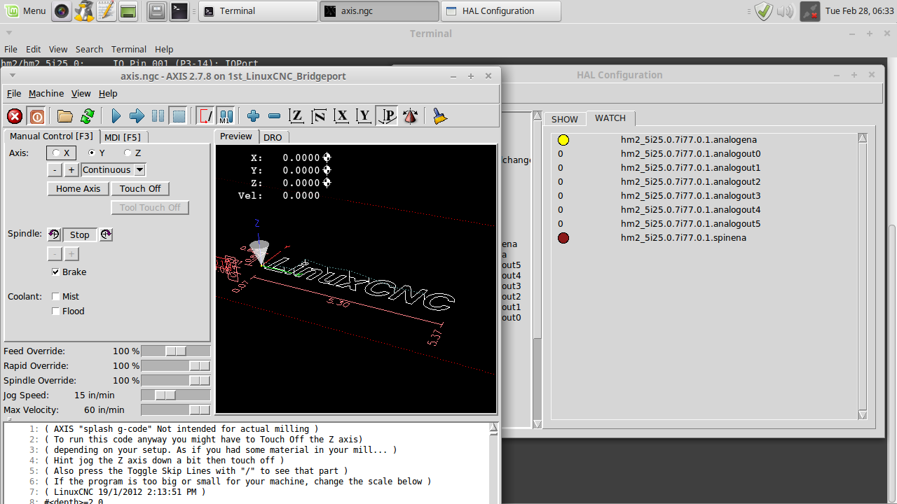

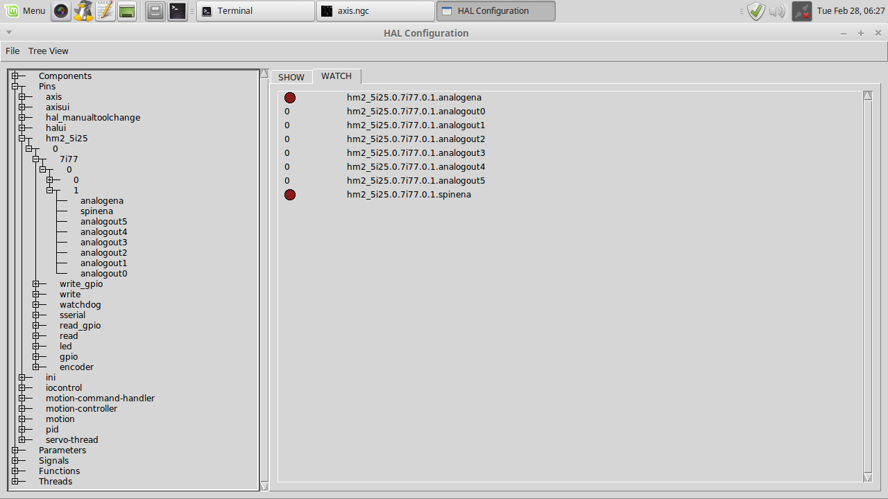

28 Feb 2017 13:25 - 28 Feb 2017 13:34 #88725
by new2linux
Replied by new2linux on topic Prototrak Plus Retrofit with Mesa 7i77 & 5i25 cards
Many thanks again to tommylight for an outstanding "forum.linuxcnc.org/10-advanced-configura...ning-detailed-how-to" Servo Tuning how to! Just a great job, many thanks!
Many thanks to andypugh, Todd Zuercher, and lakeweb for all your great help!
I have carefully followed tommylight's direction, I was not able to jog (this is the "-" "+" buttons, then a "continuous" flyout tab) ether servo. If you apply 1.4 to 1.5 v (must be in this range, started low and went until servo moved) to servo amplifier coming from TB5; DRV 0 & DRV 1, each servo will turn at low speed. When you turn and see "DRO & HAL Conf" change value, until error in AXIS "joint 1 following error" and then the DRO stops working.
Attached are the screen shots at the point I stopped.
The tree structure is not exactly the same as the example.
Any suggestions would be warmly welcomed.
Many, many thanks!
Many, many thanks!
