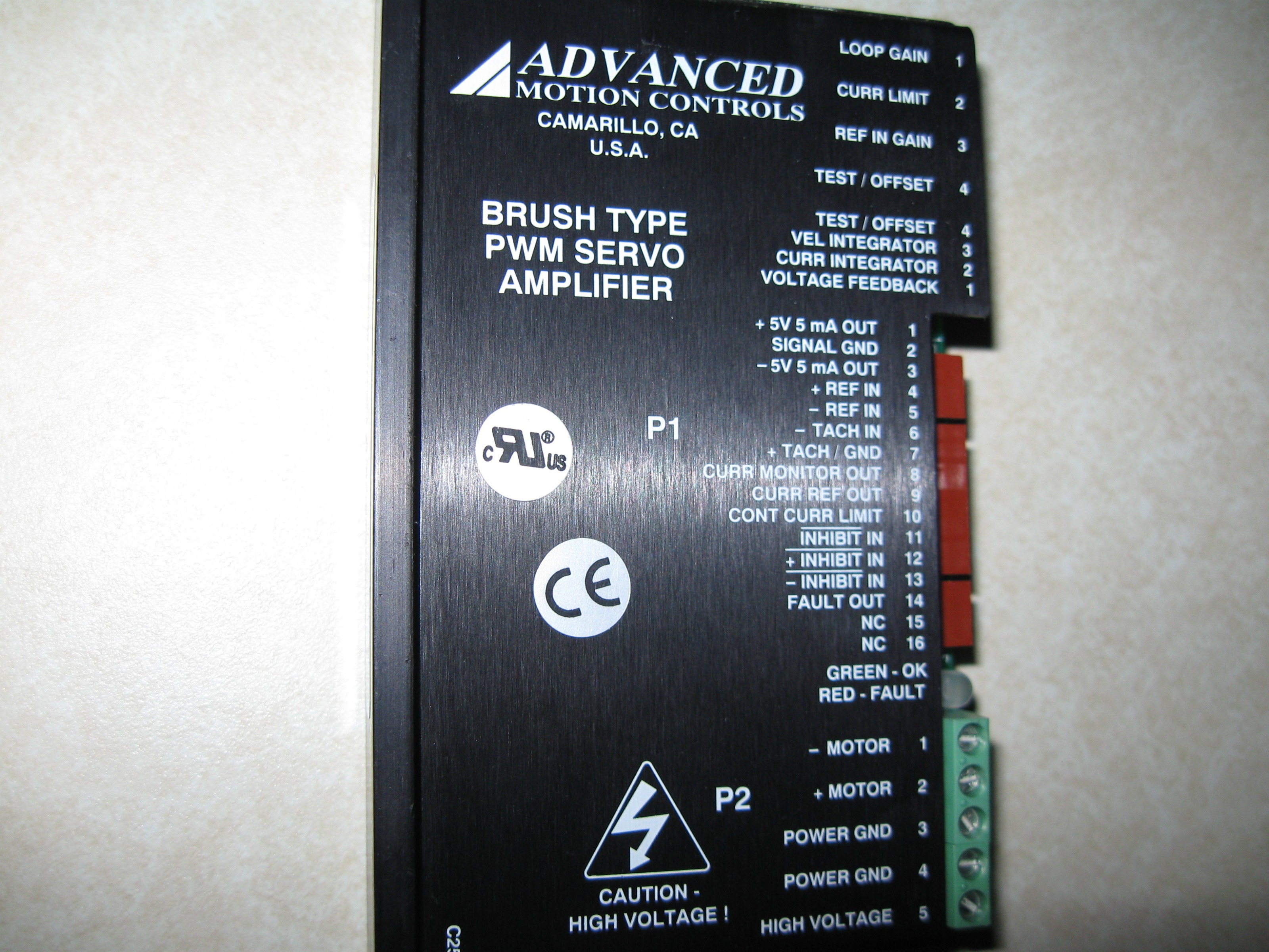

I have received the AMC (Advanced Motion Control) servo amplifier today, they look "like new". Reading parts of the manual leads from the large DC transformer (power supply) will go to each amp. These leads should be separate to each drive, short, heavy and twisted to reduce inductance.
Will I need to mount the capacitor (the big blue one) with its PSB, and go from there to the amps? Should the fan be mounted in the encloser like the ptrak?
The + REF IN & -REF IN (pin 4 and 5) are the leads from DRV O & DRV 1. This are the only leads (control low 1.5v) that will be used, is this correct?
The power supply leads connect to the green terminal block at the bottom, the heavy twisted ones. Is there something else I should be thinking about getting organized?
Many thanks to all who have given support!

Replied by andypugh on topic Prototrak Plus Retrofit with Mesa 7i77 & 5i25 cards
Can you explain what you mean by DRV0 ? On which board is that?
I would rather expect +REF IN and -REF IN to connect to only one 7i77 output.
Do you have tachometers on your motors? I can't remember (I struggle to separate all the threads here in my head)

andypugh, thank you! I should clarify, DRV 0 & DRV 1 ( TB5 ) on 7i77, the question about the tachometers, I have never seen or come across any reference to that.
forum.linuxcnc.org/media/kunena/attachme...21712/IMG_0816_1.JPG
If you look to the center and see the blue and white leads (with the small wire tie) attach to a PCB (printed circuit board) attached to the top of the large blue capacitor (this is a unit); the other end of these leads go to a square devise (a rectifier. I think) and then to the transformer. All of this needs to be used as an assembly, just checking. And the brown and white leads are the leads to the respective new (AMC) amplifier on the (HIGH VOLTAGE 5) & (POWER GND 4) position. The leads going to the drives are the (-motor 1) & (+motor 2) the green block at bottom. Just trying to understand all that needs to be attached.
Many, many thanks to all!!
