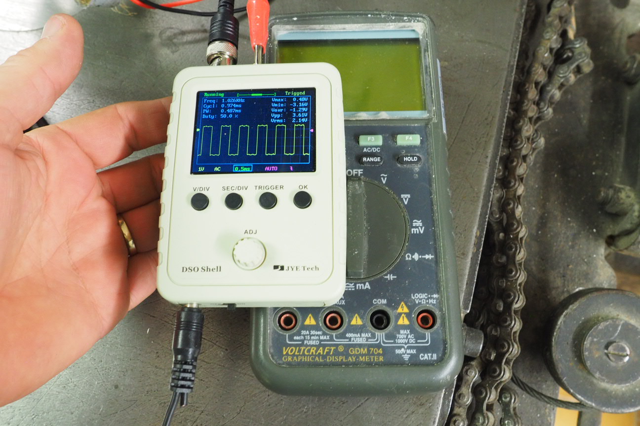

Not if your oscilloscope is a cheap chinese toy.

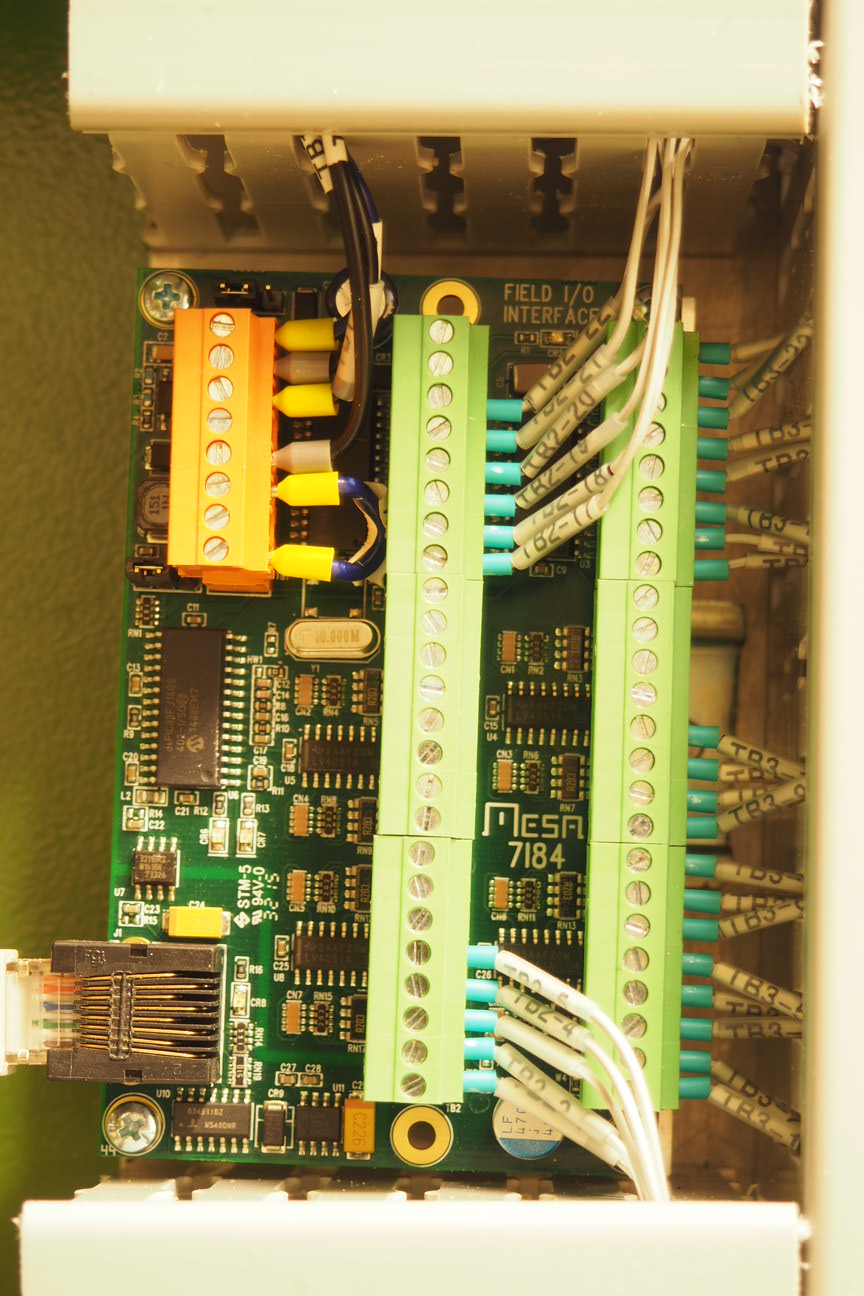

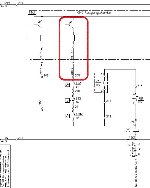

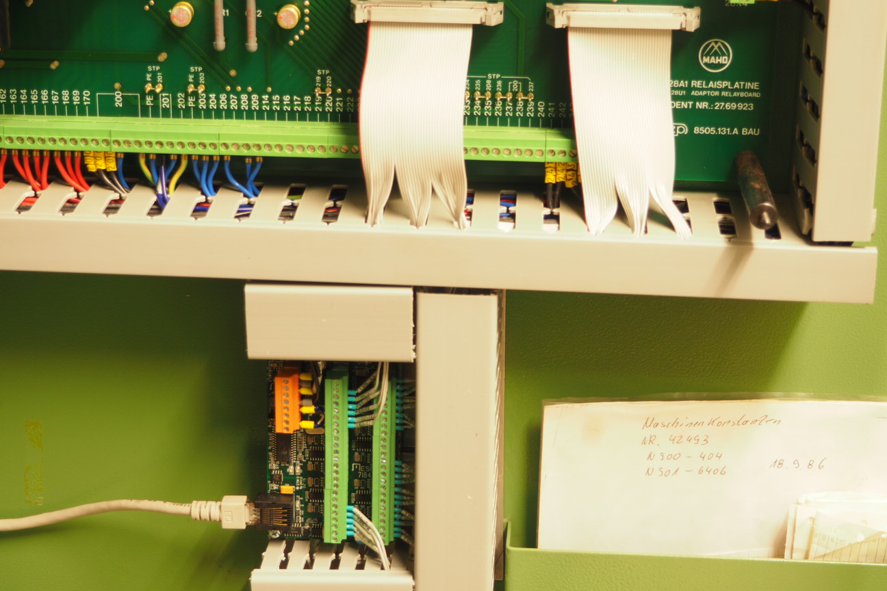

I took a quick look at the 19K1 latching today.
I did this test a couple of weeks ago, jumpering between +24V on terminal 200 and terminal 209 and it worked fine...
It is weird, I have 24V output from the 7i84 for this pin, and it is activated correctly by LinuxCNC, into 28x1-2 / OPC1-2 cabe, but the relay is not closing. Checked the resistance between 209 and OPC1-2 and there is no continuaity.
We know that the Phillips standard installation wouldn't latch i if the lube oil system was low, so I am picking that the signal is passed across a couple of other relays on the 28A1 relay board on it's way in from OPC 1-2 to terminal 209. Unfortunately this is not shown on the wiring diagram, so I'd have to search for this somehow. However, to short cut the process, I wired the MESA 7i84 pin directly into the 209 terminal. Still doesn't work. I suspect the the separate 24V rails do not share a common ground.

For start you can use multimeter, the oscilloscope is better but bulky.
John

I pull my cover off the cover off the exe, and it seems I had the correct wiring to 0V and +5V. This voltage is also okay on the EXE test points.
My osci couldn't find any TTL output signals, or any signals at all when I moved the axis though. According to the modern EXE board connector wiring the A/B/Z signals should be on the three pins 4/5/6 (grey/blue/green).

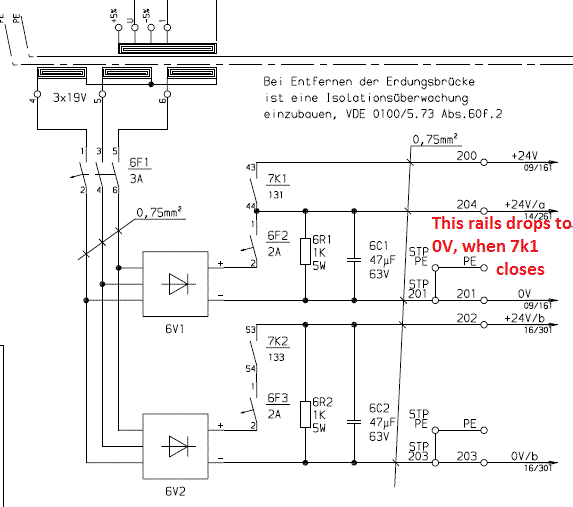

Something I have done has changed the DC power behavior to the relay panel. The panel receives power from all three 24V DC rails, Ignoring the third rail which is only for gearbox shifting, with terminals 201-204 energised immediately, and 201-200 energised once the estop circuit closes.
201 is the common ground between the always on rail to terminal 204, and the second rail to 201. I just measured, and the always on rail drops to 0V, as soon as the E-Stop circuit closes. I can't yet see what I screwed up to create that behavior, but am pretty sure this is causing the non-latching start problem.

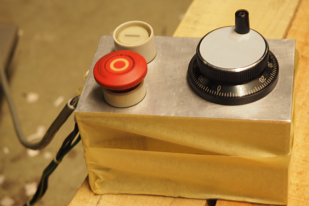

14 Nov 2017 15:40 - 14 Nov 2017 17:30 #101786
by RotarySMP
Last edit: 14 Nov 2017 17:30 by RotarySMP. Reason: Better photos
- Posts: 20531
- Thank you received: 6987
14 Nov 2017 21:57 #101801
Replied by tommylight on topic Retrofitting a 1986 Maho MH400E
Looks awesome for sure!
