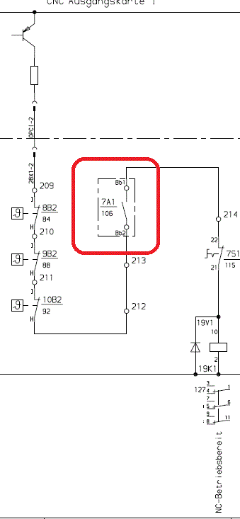

You _could_ add a relay to bypass the e-stop and powered by logic around the axis.N.is-homing HAL pins.
Whether you _should_ is for you to decide
Replied by andypugh on topic Retrofitting a 1986 Maho MH400E
The problem is that the limit snitches are hard wired to the estop circuit, so when they activate, they power off everything.n

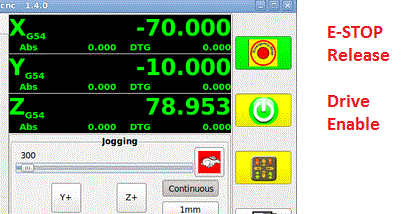

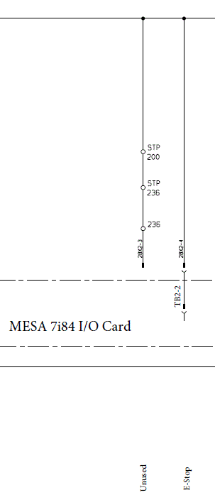

08 Nov 2017 18:27 - 08 Nov 2017 21:10 #101528
by RotarySMP
Darn, I've run out of 0.14mm² ferrules, so I wont be able to permanently wire up the ribbon cable signals from the Maho 28A1 relay boards I/O to the 7i84 yet.
I am trying to get my head around the HAL. I was going to ask for help about three hours ago, but the process of writing the question, clarified it for me. Sort of...
I am trying to get the Maho to latch on under LinuxCNC control.
I have a physical 2 pole "MACHINE START" momentary switch, with one pole (NO) to close the physical E-Stop chain, which won't latch until the NC-Ready signal from the linux CNC closes the 19K1 latching relay.
With the E-Stop circuit temporarily closed, I thought that I could pick up an E-Stop.Ext signal from the MAHO relay boards output.
So I finally cut a MAHO cable. Chopped ribbon cable, no going back now. Wired it up, added the net, looked at it in the HALshow. Nothing. Checked the ribbon cable. Oops, I'd wired up the 5th strand, instead of the 4th. Tried again, still no signal. Came up to write this, pasted the wiring diagram, noticed, oops again, I'd wired up 28X1-4 (MAHO input ribbon cable) instead of 28X2-4 (MAHO output ribbon cable). I'll try that again.
net estop-ext <= hm2_5i25.0.7i84.0.2.input-17
Okay that works. Pushing the start switch closes the physical E-stop chain, LinuxCNC detects that and releases the E-Stop button at the top of the screen.
Now to latch it. That second pole of my start switch, which is (NC) and will need inverting, gets fed into LinuxCNC to pin hm2_5i25.0.7i77.0.0.input-04-not
Tested in HALshow okay.
This button will physically be my top RH softkey.
net gmoccapy.v-button-0 <= hm2_5i25.0.7i77.0.0.input-04-not
Question - Shouldn't this be in the postgui.hal?
What I didn't realise is that gmoccapy.v-button-0 is a predefined pin. My net above creates a second gmoccapy.v-button-0 as a signal, which follows the input, but is of course not connected to the gmoccapy functionality. What is wrong with my syntax there? Can you even net pins directly to pins? So far LinuxCNC is detecting the change in E-Etop state, but not yet reacting to the direct machine start command.

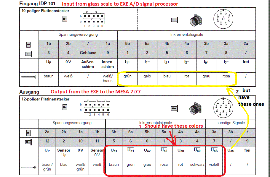

09 Nov 2017 21:14 - 09 Nov 2017 21:19 #101581
by RotarySMP
Thanks for the info Andy. That signals are only created in the HAL is helpful to know. I think my latching problem is in the MAHO relay board. The On button on the MAHO starts the Hydraulics, so I need to physically make that circuit, and see if that enables the latching logic.
While thinking over the latching relay, I decided to wire up the Y encoder and see if I could get progress there.
First thing I found when I started preparing the EXE output cable, is that the wiring colors don't match to MAHO wiring diagram.
According to MAHO, the EXE output cable should have two browns, green red and white. That would have agreed with the modern version of the EXE datasheet
Unfortunatly, the cable is exactly the same as the analog wiring between the scale and EXE per the data sheet. four twisted pairs - White/brown, Green/yellow, Pink/grey, red/blue.
I connected the Y axis encoder, as it is easy to reach and move that motor pulley. White / Brown to (0v / +5V). As long as they are correct, all the other wires such have signals, even if the wrong ones.
This is hm2.5i25.0.0.encoder-01. The HAL for this was generated by the PNCconf. Absolutely nothing can be seen in Linuxcnc or HAL Show. Any troublehooting recommendations would be appreciated.
I already checked that the 7i77 is outputing +5V and 0V on its power pins. I guess my next step will be to put an Osci on the A and B channel pins and see if anything is there. One weird thing is that the EXE circuit board has test points for both 5V and 12V, but in this implementation, 12V is not applied per the MAHO wiring diagram. I can also check that the 5V is correct nthe EXE board.
Mark
