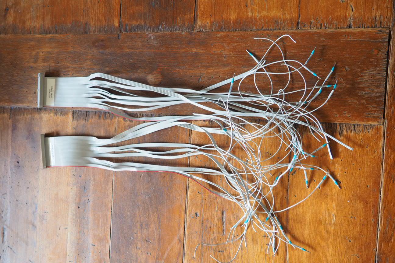

I reterminated the two ribbon cables. Need to take a break and recheck all my work before I install them. Is there an industry standard way to terminate the unsed wire ends? I'd just neaten them up and bundle them with heatshrink.
Attached are the two pin maps I have so far.
Mark
Mark

20 Nov 2017 17:48 #102079
Too late now, but to connect screw terminals to box-headers I use M20 individual wire crimp headers.
uk.rs-online.com/web/p/pcb-connector-housings/6812874/ (ignore the picture, the link is to a 2x12 plug)
I don't think that they do them full-width for 50 pin headers, but you can fit them side-by side and/or glue them together.
You need crimps and a crimping tool, but one advantage is easy re-wiring.
Replied by andypugh on topic Retrofitting a 1986 Maho MH400E

20 Nov 2017 22:39 - 21 Nov 2017 13:34 #102111
by RotarySMP
I do have the crimping pliers from Engineer for them, and used them on my 3d printer, but figured the ribbon cables were already here so I'd reuse them.
Many of the pins are also connected to screw terminals on the PCB, so there are probably less than 20 sockets to populate if you went with your suggested connectors.
Mark
Mark

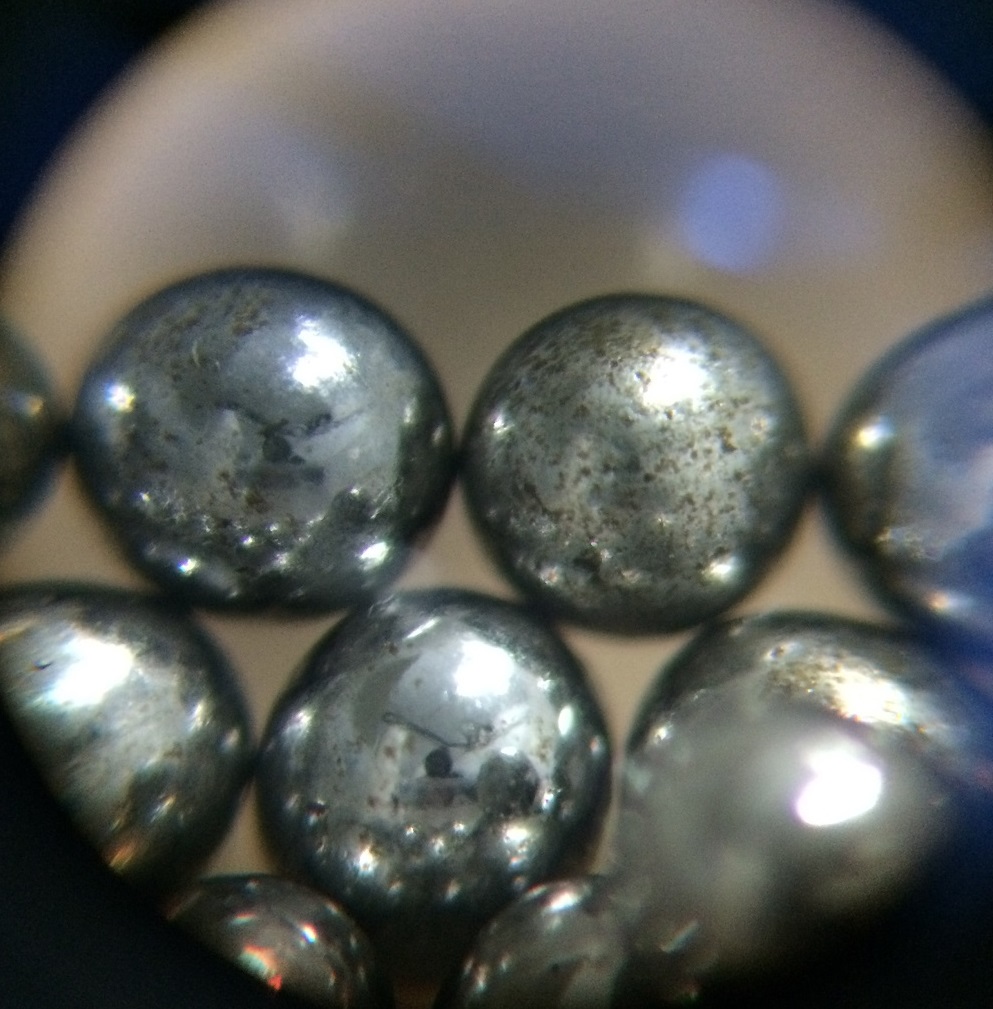

21 Nov 2017 13:39 #102131
by drimaropoylos
- Posts: 17440
- Thank you received: 5087
21 Nov 2017 13:41 #102133
Replied by PCW on topic Retrofitting a 1986 Maho MH400E
Those look like slingshot grade balls...
