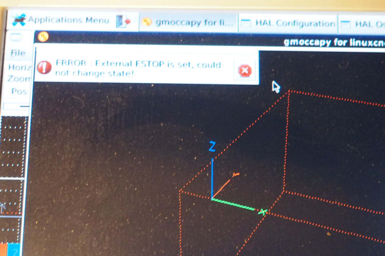

I've noticed two other issues...
When I start LinuxCNC, I get this error message...
I can click it away. The machine starts in physical E-Stop, so I have push the start button to get it out. What setting do I need to set in the HAL or INI so that this message doesn't appear at LinuxCNC start?

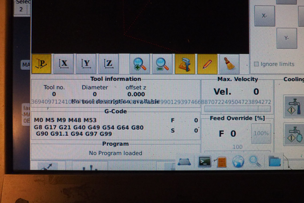

The second issue is that there is garbage written into the tool area...
I thought it was some corrupt data in the tool table (which I haven't set up yet), but that is still empty. Any suggestions what is causing this?

by bevins
Upgrade your gmoccapy. that was a bug a while ago if I remember correctly that has since been fixed. When I start a new system with the live CD I have that also.
Replied by bevins on topic Retrofitting a 1986 Maho MH400E
Mark

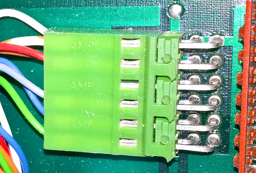

Does anyone have a good tip as to which AMP connector model or series this is?
I have searched the TE.com connector search function, Digikey and Mauser, and couldn't identify it.
It is 2x6, 1/10"(2.54mm) pitch (or maybe 2.5mm).
This is the Heidenhain EXE board output connector. If I can track down some 5x2 twisted pair, double shielded cable, I'd like to rewire the EXE outout to utilise the differntial signals.

Replied by andypugh on topic Retrofitting a 1986 Maho MH400E
If the pins are at 2.54 pitch then I think that almost anything for PCB headers will work but maybe not lock.
This looks like the one you want:
www.digikey.com/products/en?mpart=925370-6&v=17
(Don't forget that you will also need the terminals and the correct crimping tool)
