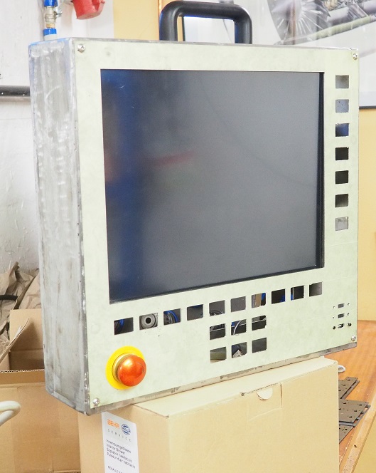

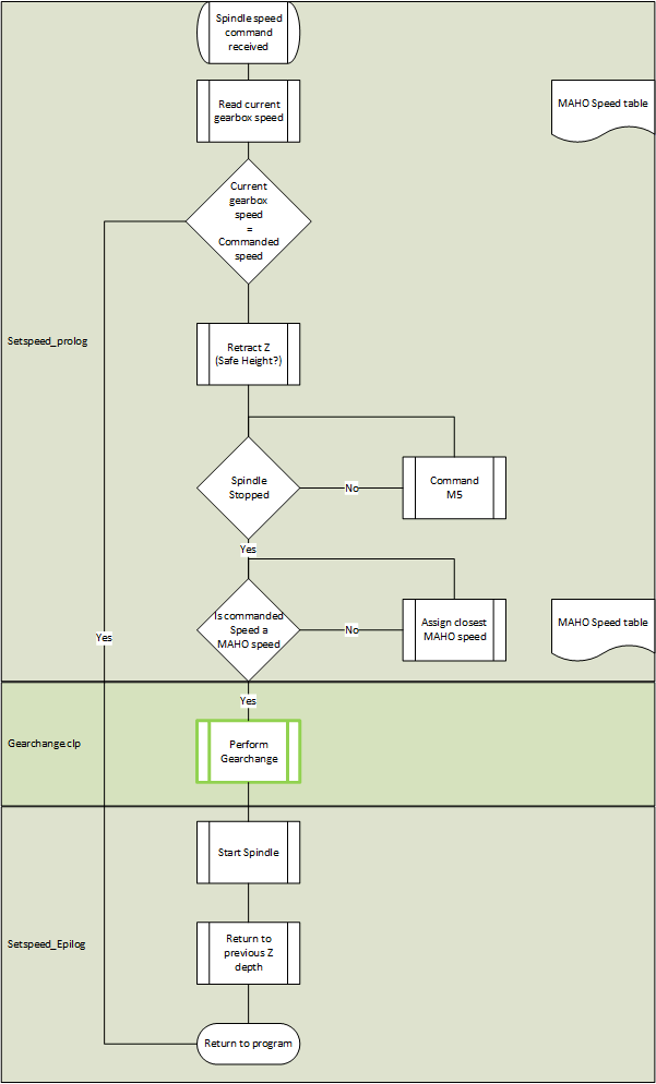

Thanks John, at present, there is currently nothing implemented to call the gearchange.clp is there?
I was looking at remapping S, as the Linuxcnc G code remapping widget uses Python, which I have a little bit of experience with. If I understand correctly, then the setspeed_prolog and setspeed_epilog could be used to call and wrap your ladder logic.
Here is my block diagram for that plan. Any comments and suggestions are appreciated.

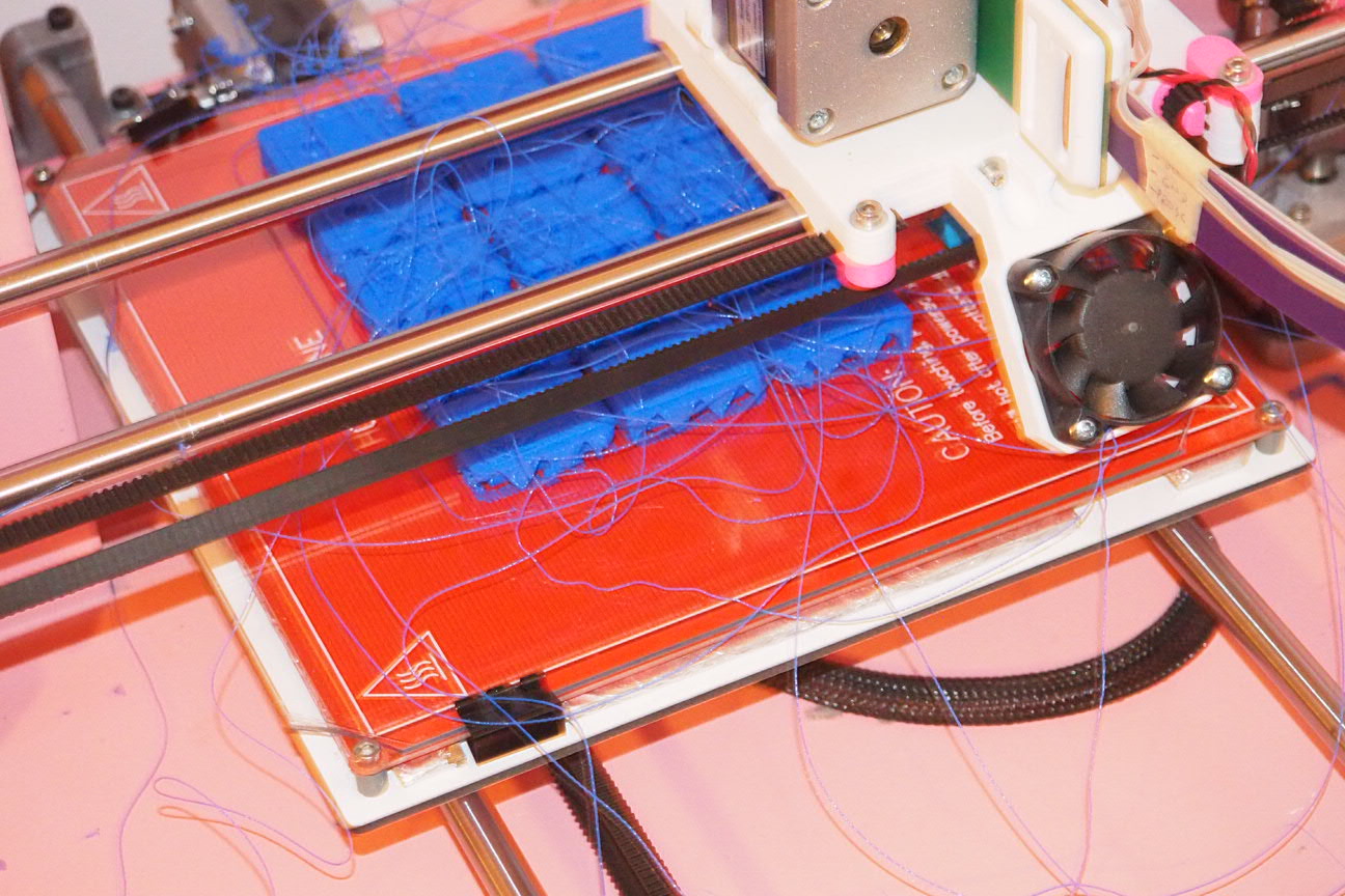

I started bogging the defects on the housing, but didn't use enough hardener, and it's cold in the basement, so I put it by the furnance in the hope that is goes hard.
Also printing the first of the control panel buttons on the 3D printer.

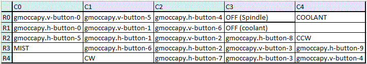

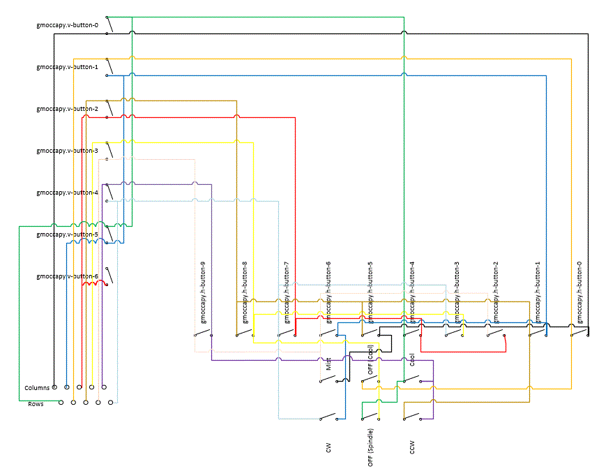

I am working on my control panel,
...and want to use Matrix_KB to interface the 26 keys with a 5x5 matrix.
I am a little unsure of the syntax from the documention, and couldn't find examples in the forum here. Appreciate any feedback on this.
loadrt matrix_kb config=R5C5s names=MAHO_Panel # 5x5 Matrix, in scan generation mode.
addf matrix_kb.MAHO_Panel servo-thread
net matrix_kb.MAHO_Panel.col-1-in hm2_5i25.0.7i77.0.0.output-00 # does the column numbering start at 0 or 1? I am netting a pin to a pin. Don't I need a signal?
net matrix_kb.MAHO_Panel.col-2-in hm2_5i25.0.7i77.0.0.output-01
net matrix_kb.MAHO_Panel.col-3-in hm2_5i25.0.7i77.0.0.output-02
net matrix_kb.MAHO_Panel.col-4-in hm2_5i25.0.7i77.0.0.output-03
net matrix_kb.MAHO_Panel.col-5-in hm2_5i25.0.7i77.0.0.output-04
net gmoccapy.v-button-0 matrix_kb.MAHO_Panel.key.r1c1 # same question as above, does the row numbering begin with 1 or 0?

When I am unsure about a component pins and names I use halcmd to list them:
(this is with linuxcnc running but without the matrix_kb hal file additions )

And yes, all net commands need a signal and the first token after the "net" command
( you can also verify this with halcmd)
This can save a lot of time by quickly testing hal commands and components without re-editing
your hal file over and over (once you have things working you can copy/paste names/commands from your
terminal history into you hal file)

Thanks. That is very helpful. I forgot that hal pins get automatically created by the function, and thought I needed to define them.
Thanks for confirming that the numbering of columns and rows starts with 0.
Now I understand better this line of the documentation.
In the optional scan-generation mode the matrix_kb.N.keycode pin changes to an output pin and a set of output row pins and input column pins are created.
So my HAL entry will be:
loadrt matrix_kb config=5x5s names=MAHO_Panel
When the signal is irrelevant, and is only used as glue bettweens pins, like in this case...
net signal name MAHO_Panel.col-2-in hm2_5i25.0.7i77.0.0.output-01
... is there a convention or standard in the the linuxcnc community for signal naming?
Here is my button matrix
And a rough wiring diagram.
Mark

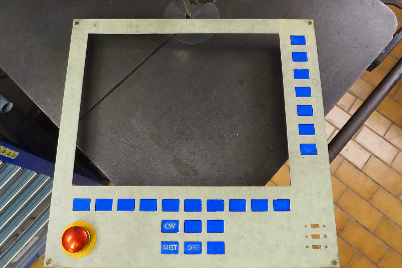

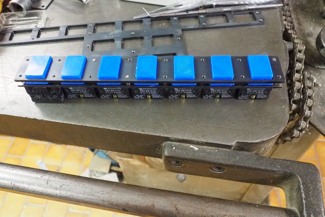

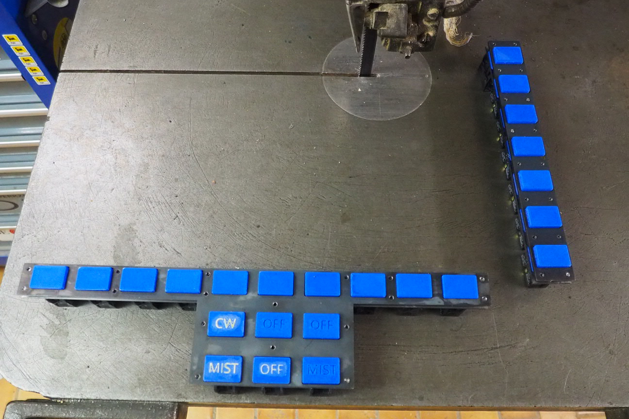

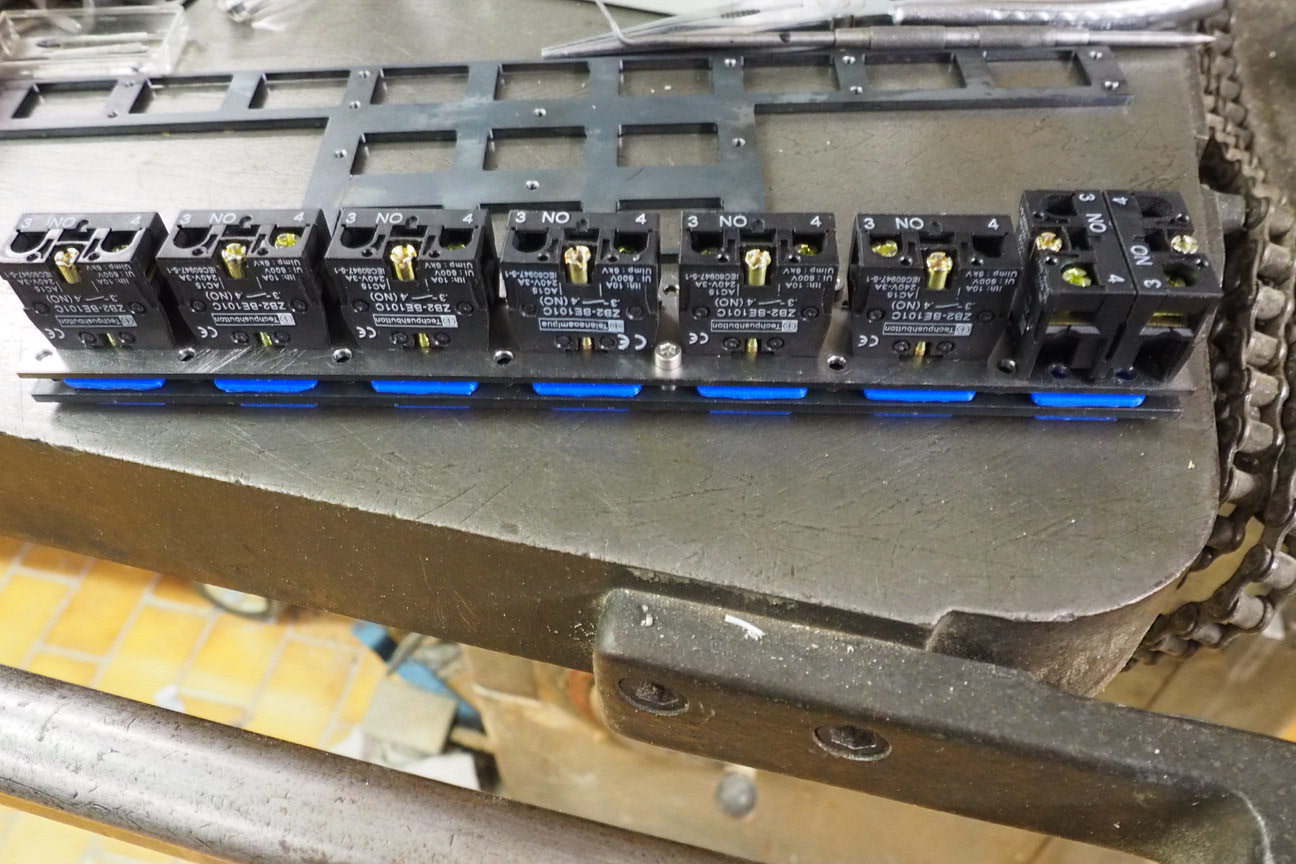

I've been working on the button assemblies.
The top RH button needs two switches, one for 110VAC physical E-Stop release, and the other 24VDC to the 7i77 and Linuxcnc.
When I designed the laser part, I didn't realise that those buttons are stackable. Duh!
I'll need to reprint the entire set of buttons one more time, as they need to be another 2mm thicker to avoid jamming in the the front panel cut outs.
Using my daughters yellow nail polish to bring out the text doesn't really work, as the solvent in the polish attacks the PLA. Next attempt will be with acylic paint.
Mark

Thanks J,Sorry, I have been using analysis paralysis to (so far successfully) procrastinate on that task.
Life got in the way for the last month, so I haven't been working on the MAHO, other than a couple of minor tasks like drilling the face sheet for mounting the button plates. Not sure what grade of stainless that face sheet it, but it was a real bitch to drill. Slightly too slow ->> instant work hardening, followed by broken drill, slightly too fast -->nasty break through, accompanied by broken drill.
I undercoated all the control panel parts last, weekend, so they should be dry enough in the cold basement for some more paint this weekend.
I really need to get a moving dolly designed and made up to move the whole thig from the garage through in the machine shop, as then I will also pull off the main control cabinet and cross slide, to get through the door, which will also expose the Z glass scale encoder, which hasn't given any signs of life.
Mark
