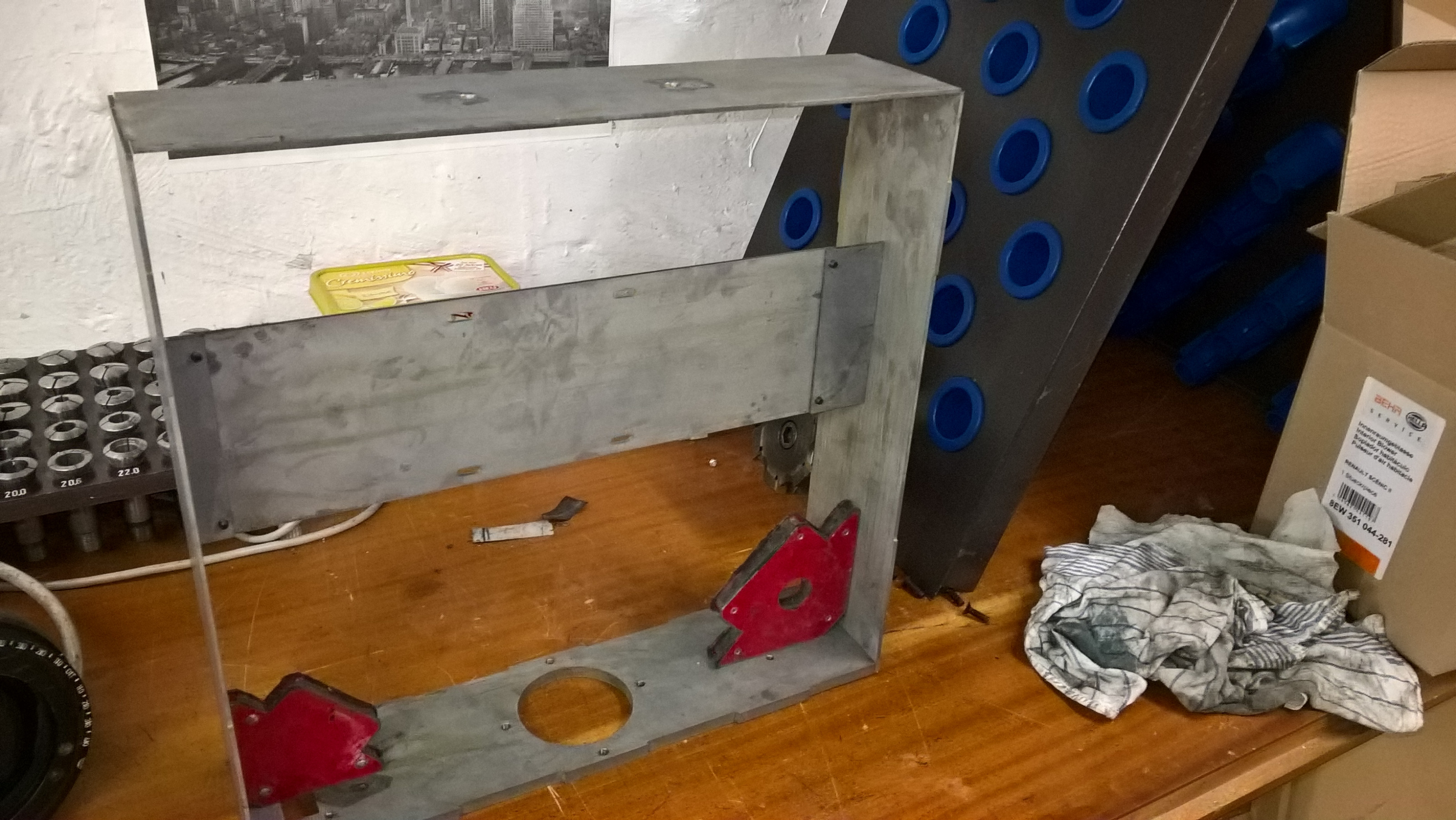

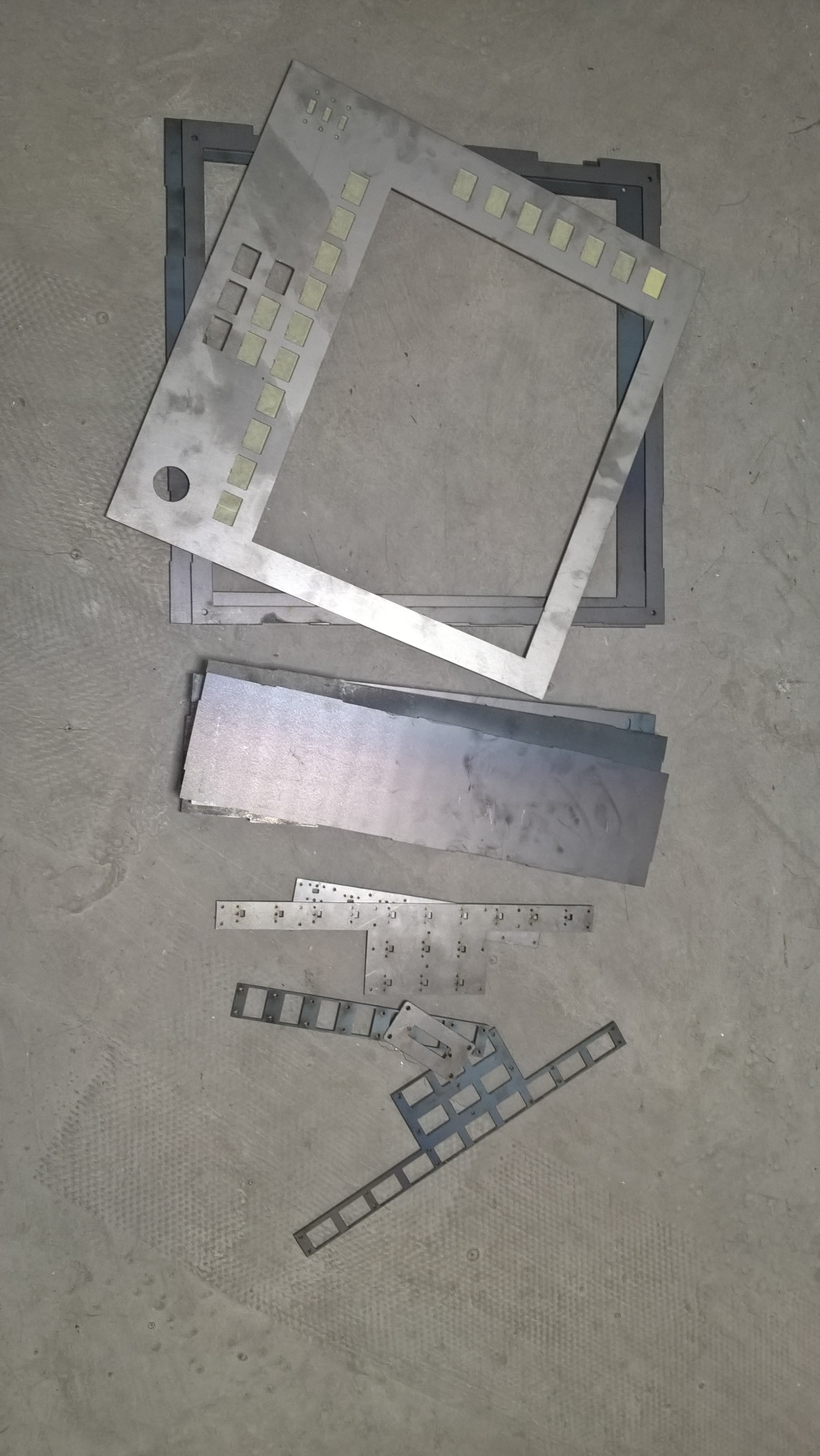

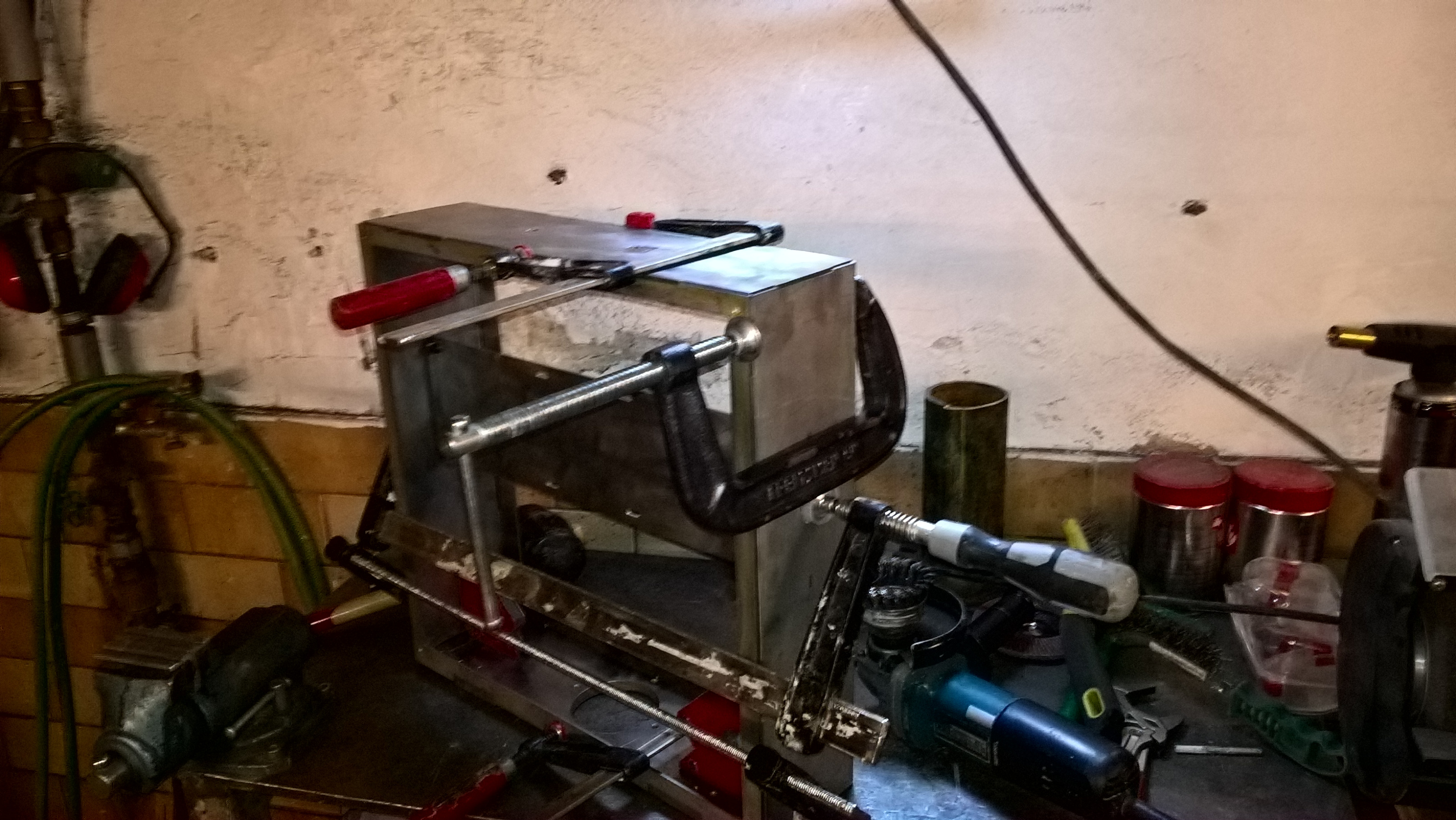

I've been a little too busy with other things lately, so the MAHO hasn't had much attention. My friend dropped off the lasered parts he kindly arranged last weekend,
so today I spent the day working on the new control panel.
I used HCl to removed the mill scale. First I've done that, and it works really well. Way easier than trying to grind it off.
Whoever came up with the idea of self fixturing laser weldment was a genius. I took quite a while to model the sheets in CAD and get them all interlocking properly. When I first put them together with too many clamps, I couldn't get them to fit, but the secret was fewer clamps, and they just snapped together.

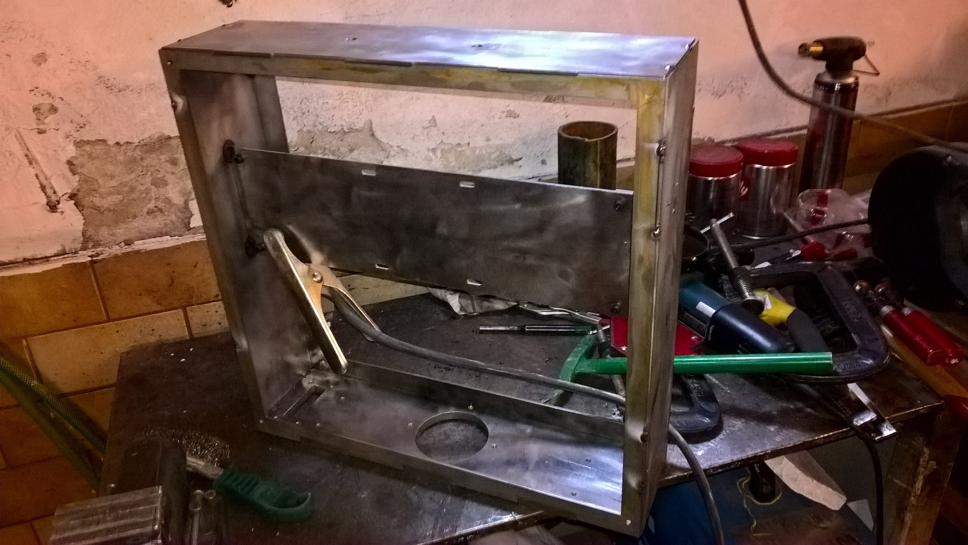

After I tacked it together...

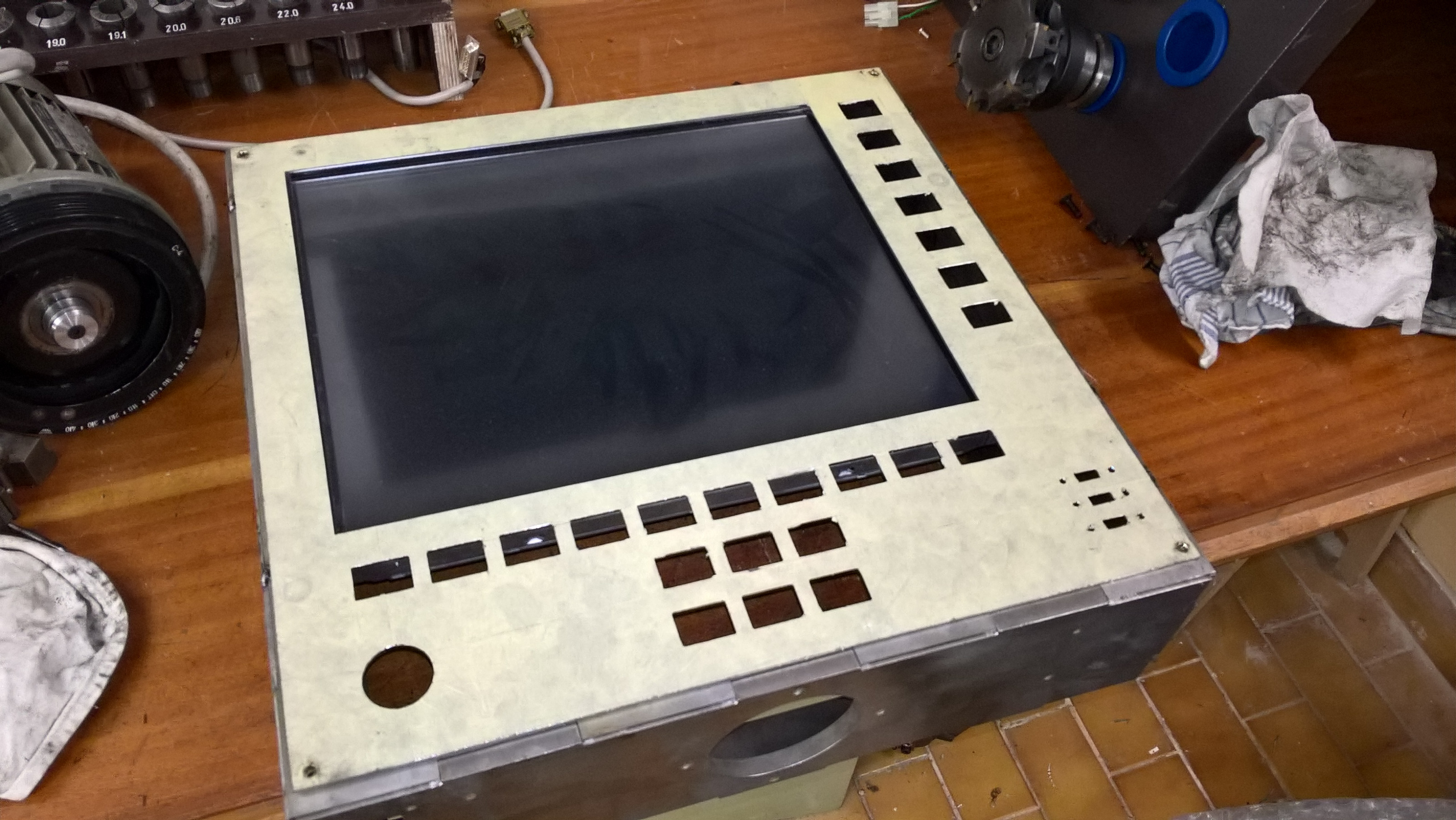

... it was time to check that the monitor mounting was correct.
I am not much of a welder, so there is going to be a fair bit of grinding to get those edges looking nice for painting.
Mark

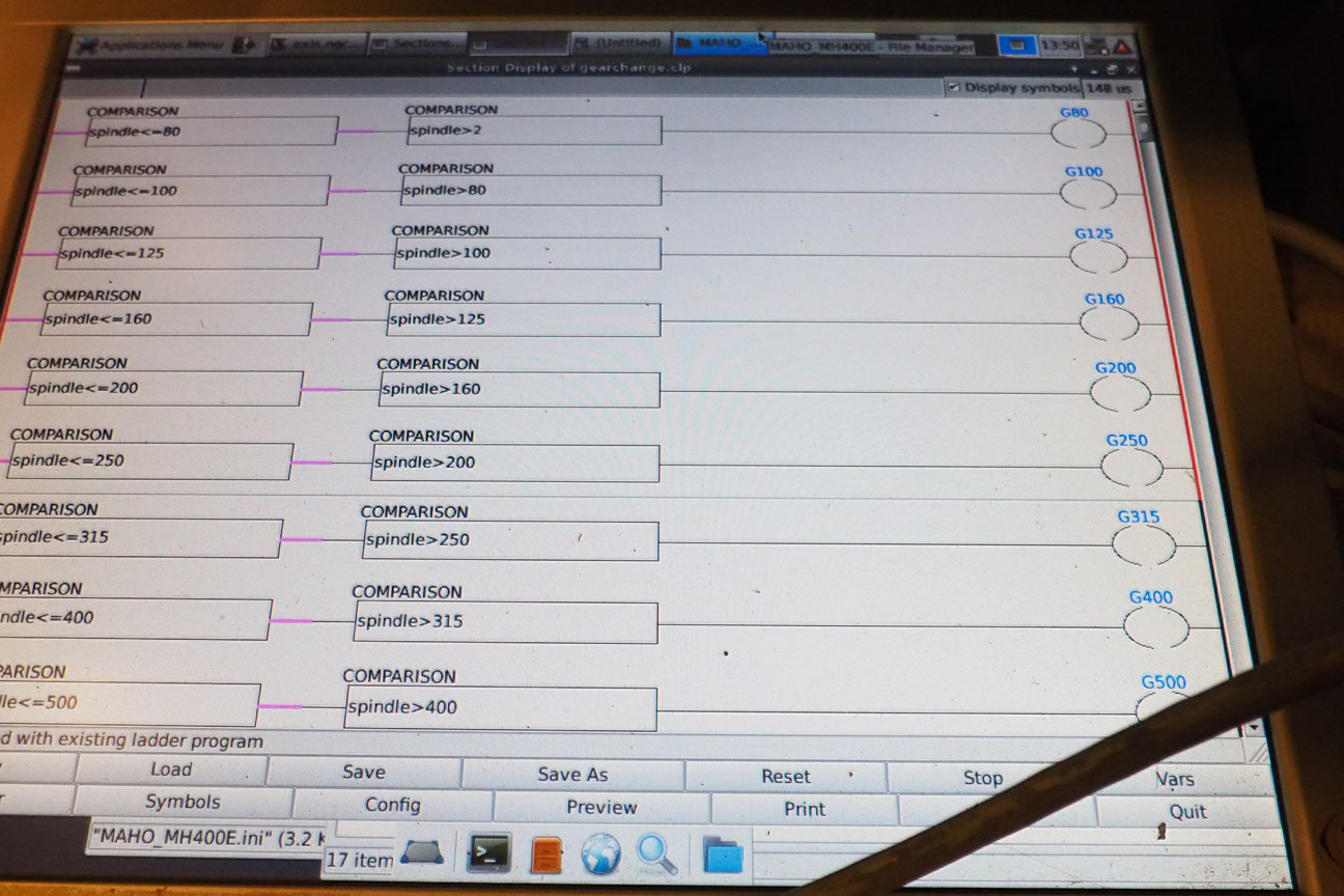

John, sorry it has taken me till today to follow your advice and make a new PNCConf config and then paste in the files you sent me. Like that the Classic ladder files for the gearbox are editable.
Did you make progress on calling the ladder functions when an S word is called? I have started looking at reassigning M (S) codes.
What is the trick for pulling MAHO ball screw pulleys? I read on a german forum that there is a trick, but it didn't say what that is.

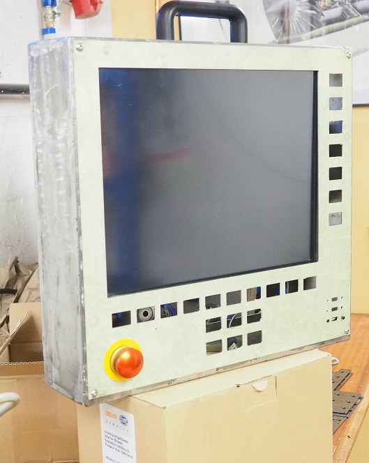

I confirmed that the Y axis is moving ~130mm on a 100 mm command.
The new control panel housing is progressing. A lot of grinding, and some more welding to fix slag inclusions, more grinding and I couldnt resist mocking it up again.
It undercoated now, to stop it rusting, then I'll bog it to hide the divets from grinding and other eyesores.

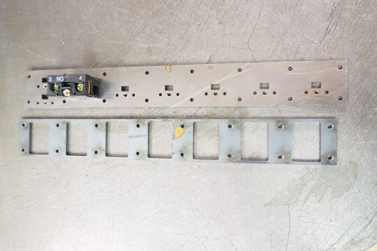

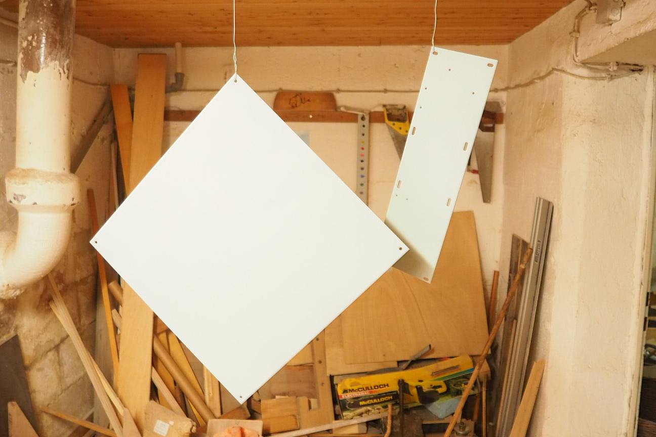

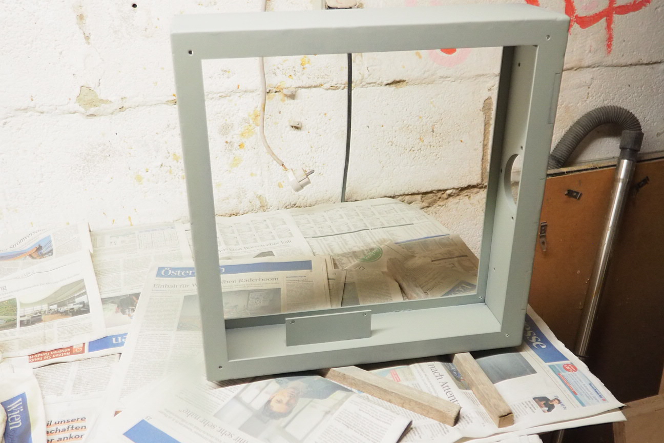

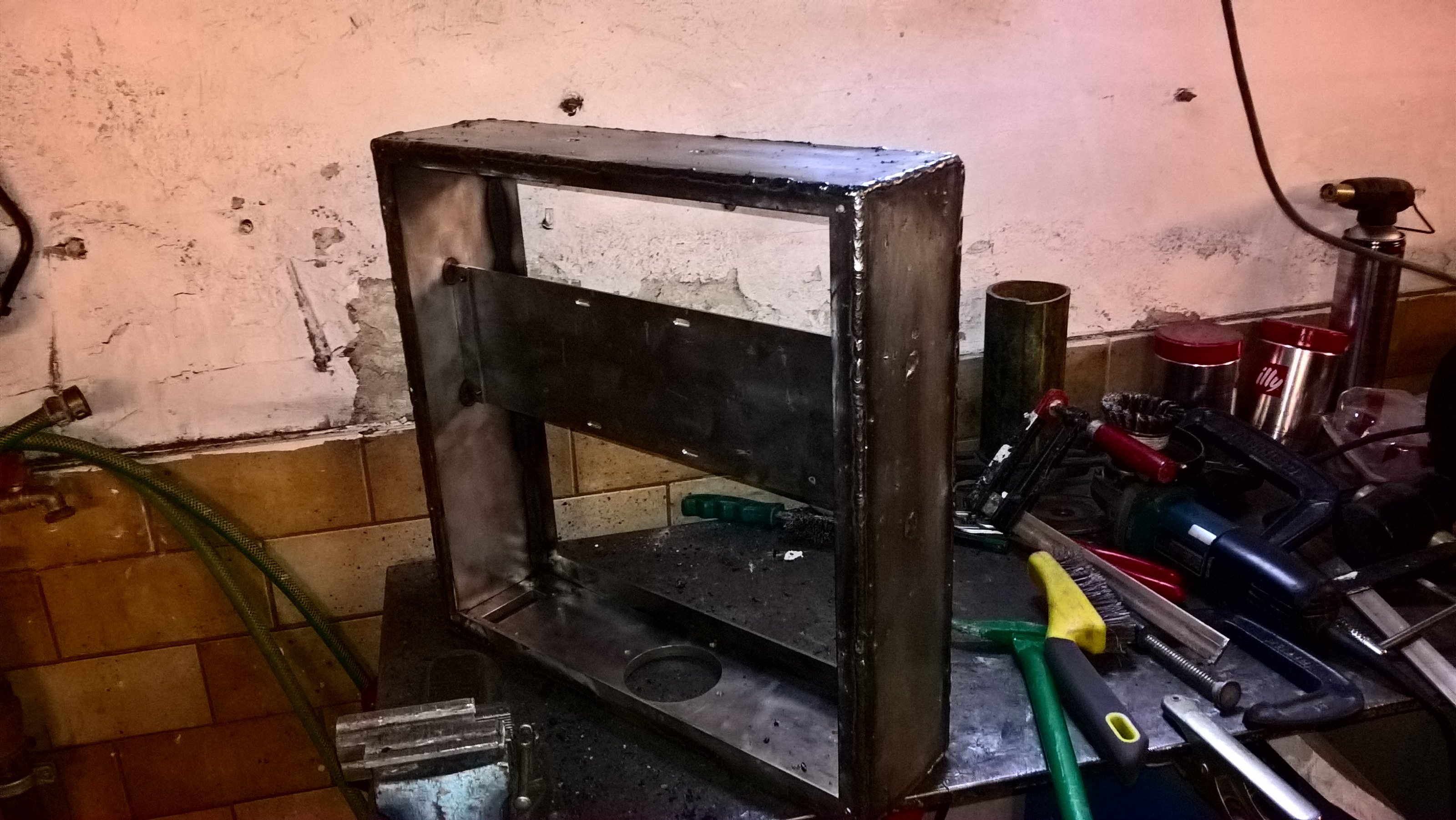

To mount the buttons and associated switches, some fiddly bits were also lasered.
Mark
