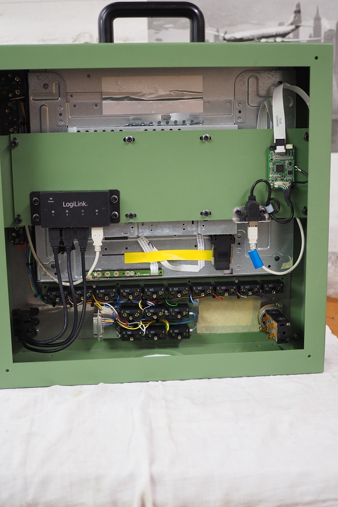

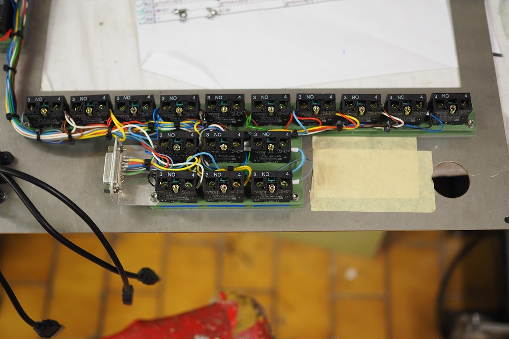

Yesterday I finished wiring up the buttons. Ended up with a bit of a ratsnest in the middle, and still need to test that all the circuits are correct.
Next step is installing and wiring the two PEC-15 encoders on the user module, which will be Feedoverride, and maybe spindle speed override, or rapid override. I am pretty sceptical of implementing speed override, as having the machine pause, and change gear in the middle of a cut sounds like a recipe for scrap to me.
Mark
Mark

Considering I designed it, this control panel is going together quite well.
Normally by now I would have discovered that assembly requires a cyclotron to provide the strong magnetic field to levitate the critical screw while six, highly dextrous, infant hands similtaneously assembled everything else around it. Hope I am not dooming myself with premature optimism.
Mark
