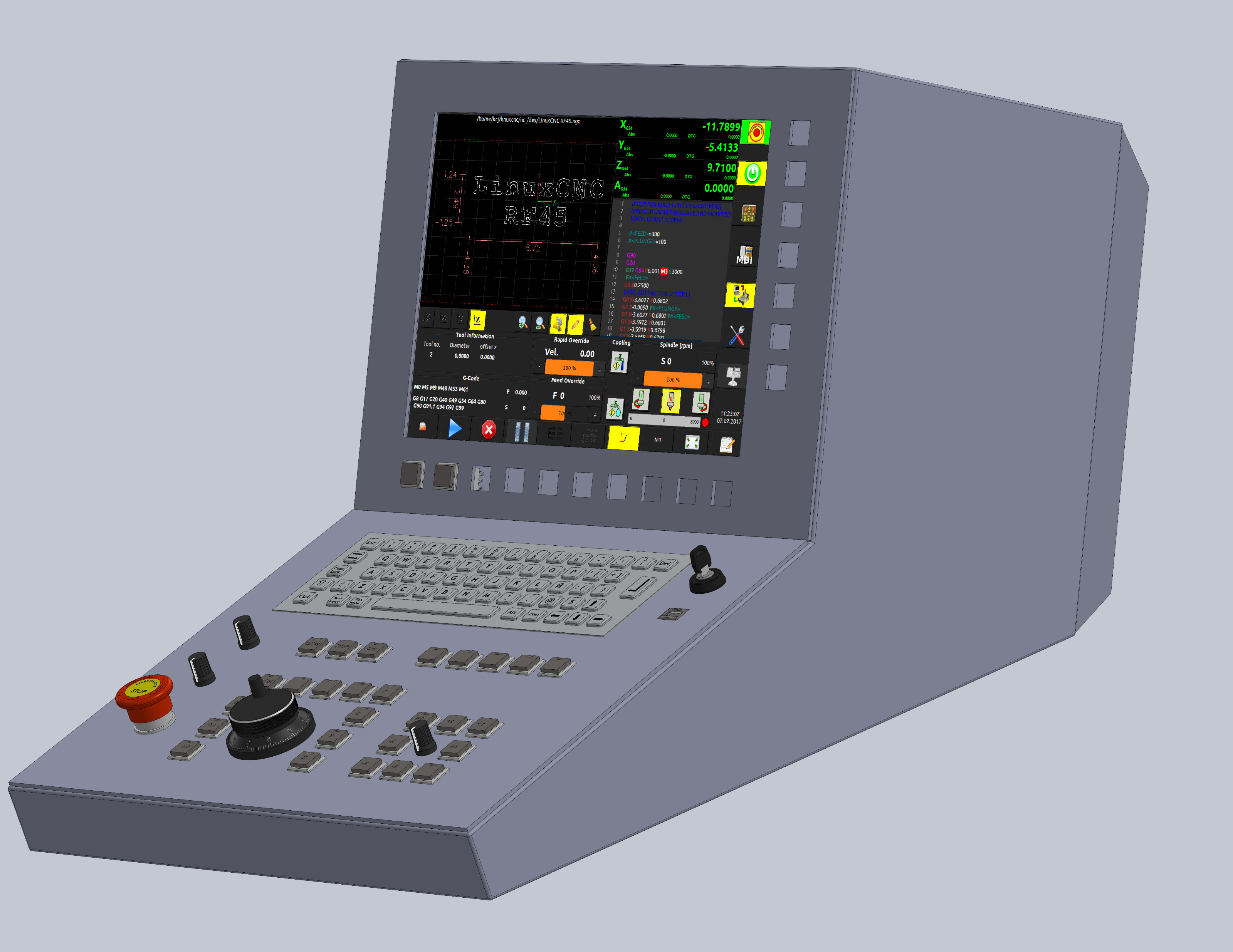

I decided not to get a 7i83, as I have enough spare inputs on the 7i77. I am multiplexing the control panel buttons, so only 10 inputs are used for the 24 switches. I also want to make a pendant, and think I can just squeeze everything into the existing 7i77 and 7i84 I/O.
The switches feel pretty good. The travel is about 1-2mm. There is no positive click, and the 3D printed buttons can hang up if the force is too off axis. I'll see how this works, and if they are a pain in use, I can back them up with some coil springs. The seminar hotel next to my work has pens with the idea spring in them. Our company sometimes has seminars there, so I havest the left over pens just in case. I kind of plan to CNC mill some aluminium buttoms once the MAHO is running. We'll see if that happens.

Hi, i haven’t quite understand how multiplex works on the 7I77. I thought that multiplex can be done only with 7i83 or on some Pokeys style dedicated hardware. The 7I77 card can sense short circuit between the inputs?

Not sure what the question is...
edit:
Oh I think I see, you mean how can you multiplex inputs?
This can be done all in hal with almost any kind of I/O device
to expand the number of inputs though diodes may be needed externally
to prevent "sneak paths"
The LinuxCNC component matrix_kb implements input muliplexing using any kind of I/O device
including parallel ports

When you press a bouton in the matrix keyboard system, a connection from one input to another is made. The 7I77 can sense a connection between inputs?

On a multiplexed kb system there is a matrix of outputs and inputs
so for example a 64 key matrix could have 8 outputs and 8 inputs
with the key switches at the intersections. Typically the 8 outputs are driven
one at a time and the 8 inputs read every time a different output is energized

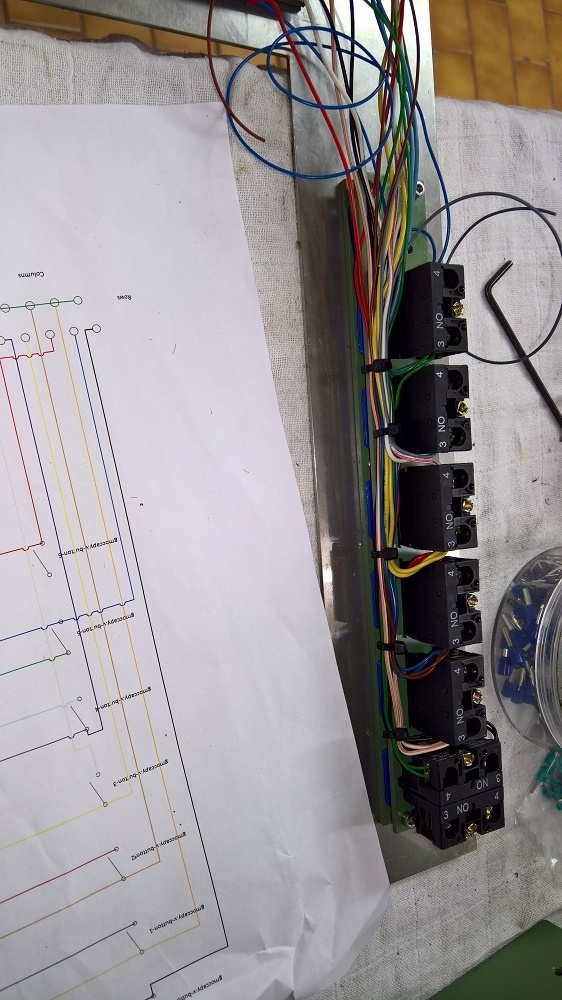

John,
My plan of the MatrixKB in this post...
forum.linuxcnc.org/12-milling/33035-retr...00e?start=310#103928
I finally got the last buttons printed, and could assemble the lower button carriers. Then continued with the button wiring. I'd forgotten how time intensive wiring is.
Sorry about the photo rotation. I rotated this when I cropped it, and all the windows programs show it with the correct orientation, but it the orientation seems to be ignored by the forum software.
