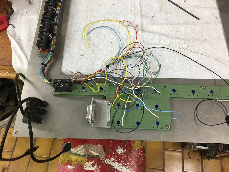

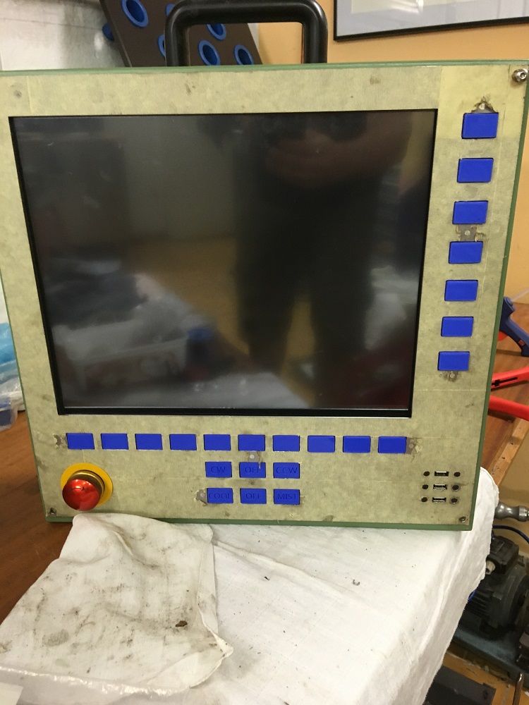

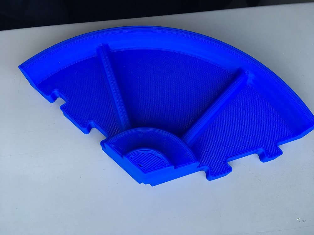

You can just feel it can't you. I get a free weekend, waste invest time in making lifting tongs, and a pouring shank for my new crucible, and also make some progress on my sand muller,
www.alloyavenue.com/vb/showthread.php?13...iewfull=1#post210979
...then yesterday I cranked up the 3D printer and started printing the pattern for the lathe faceplate...
....and BAMM!!! JG is calling me out for my wayward priorities
Now I feel guilty. Cause I knew I needed to use the 3D printer to print out some new MAHO buttons since I rotated the switches, and can then continue with the user panel wiring.
Mark
Mark
