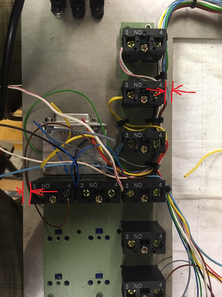

Nice design John. Reusing the existing housing is going to save you a bunch of time.
I screwed up the design of my lower button mount plate. With the switches mounted vertically, there is not enough space above for the monitor, and below for the housing flange, so I will have to remake that plate and rotate the switches.

Replied by andypugh on topic Retrofitting a 1986 Maho MH400E
if those are modular switches you might be able to just move the contact blocks further back. (I don't know if I have seen spacer blocks)

Hi Andy,
I'd need at least inch long standoffs for the switches, and then I couldnt mount the front panel with the switches installed and cabled. Trying to wire them up inside the house would be a nightmare. Easier just to remake the steel mount strip with the switches rotated. I finished it yesterday, and threw some primer on it. I'll paint it green this evening.
Probably should have stuck with the huge MAHO control box like John is doing, but space in my basement is at a premium.
Mark

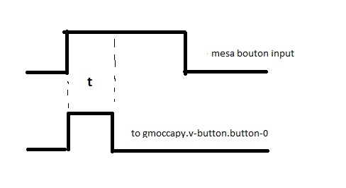

We have a little problem with the e-stop double bouton. Gmoccapy activates only after we release the bouton, so the 24 volt from the Mesa to 209 joint to activate the 19K1 is not going to be present when we press the 3SH1 bouton (the second bouton contact).

04 Jun 2018 08:31 - 04 Jun 2018 08:33 #111578
by drimaropoylos
Never mind, I was wrong, the boutons pin of gmoccapy have different behavior than soft boutons on screen. They activate gmoccapy as soon you press then and not after release them.

04 Jun 2018 11:17 #111589
by RotarySMP
Hi John,
Interesting observation. I hadn't notice that behavior. For testing I have the Physical start button from the the MAHO connected to close the EStop through one set of poles, and to signal V.button.0 through it's second poles. While pushing and holding that, I have been clicking the on screen V.button 1, and it has latched fine.
