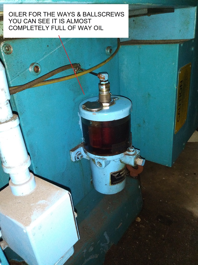

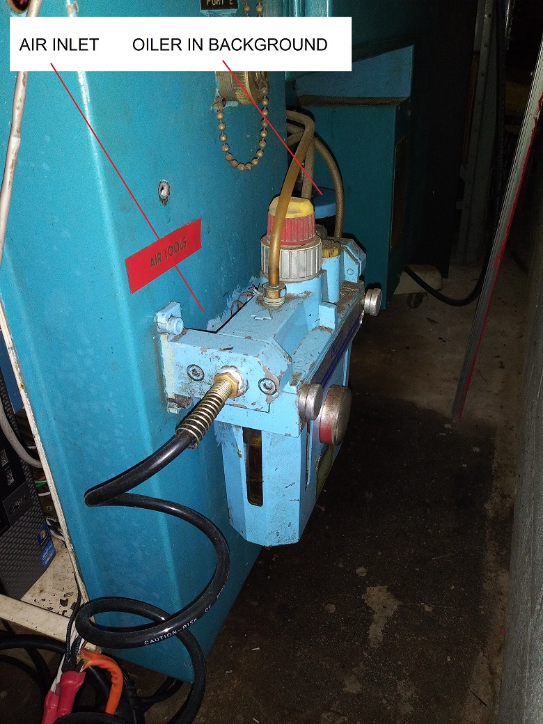

Was wondering about the compressed air. The input port looks a little munged.
For some reason the oiler is detached and in a separate box. Hopefully it works or can be easily repaired.

I will get some pics of my oiler and you can compare to see if it is the same. I have the manual for it and will find it also. The inlet should be a standard 1/4" or 3/8" pipe thread (NPT). Depending on how bad it is you may be able to simply re-chase the threads. If I remember correctly it is aluminum, so yeah if someone hit with a forklift or etc, then it could be in bad shape and need to replace.

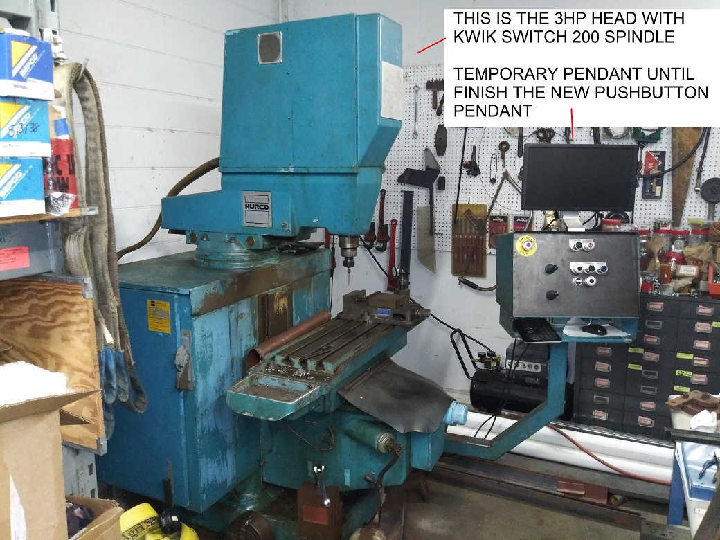

01 Aug 2020 03:45 #176743
by CORBETT
Replied by CORBETT on topic Hurco KMB-IS CNC update
- CORBETT
- Posts: 286
- Thank you received: 113

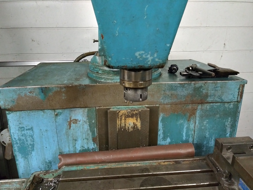

01 Aug 2020 04:06 #176745
by CORBETT
- CORBETT
- Posts: 286
01 Aug 2020 04:32 #176748
by CORBETT
Leith,
Attached at the bottom is the PDF manual for the oiler, hopefully the same as yours.
Also some models also came with a Bijur Oiler on the bottom left side of the knee as you are facing the machine. I will try and find a pic of one I have.
Robert

- CORBETT
- Posts: 286

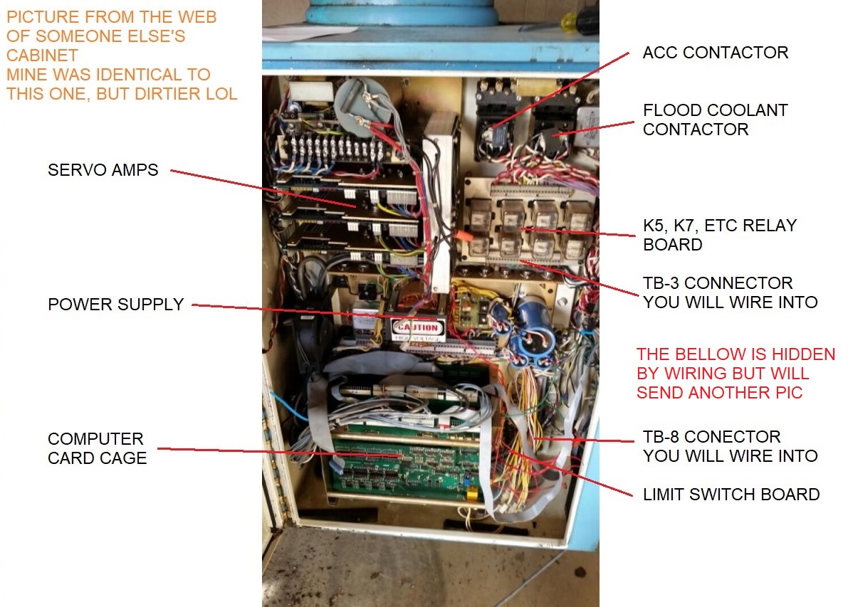

01 Aug 2020 17:48 - 01 Aug 2020 18:02 #176803
by CORBETT
Leith,
Here is a pic of a cabinet like mine. Mine was much dirtier, and I would have to find the pics from 2 years ago before tearing out the computer cage and power supply. But this pic on the web was much cleaner inside.
I am going to go try and make a few parts for my Dad and his projects. I will be back along and along to try and upload some more pics and info.
Later tonight I will send you a copy of my manual for the machine.
Will be back later,
Robert
The below pics were taken last night of my cabinet. Excuse my wiring as I am going to clean everything up, I simply needed to get it back working asap.
Leith,
Will be back later,
Robert
Last edit: 01 Aug 2020 18:02 by CORBETT. Reason: To clarify my post for bottom pics

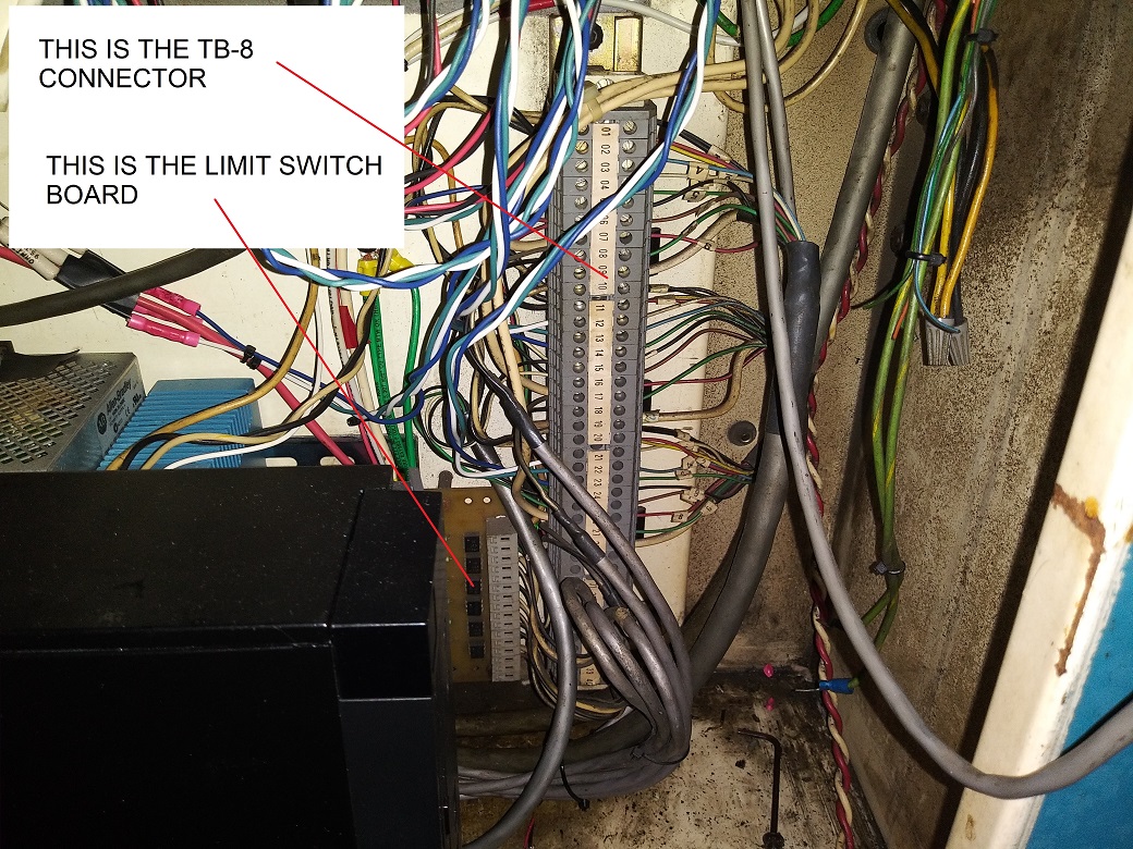

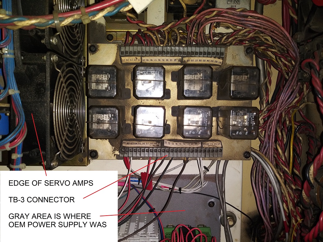

01 Aug 2020 19:27 #176808
by CORBETT
Leith,
One other thing I did not mention is that you don't want to tear out any wiring and definitely not the relay board with wring coming off the TB-3 connector until I can send you schematics to understand everything.
Hurco put a lot of safety loops in by using the relays and that is why I wired directly into the TB-2 connector as it kept all of the downstream safety blocks in place so that it was mechanically safe. Most all people when retrofitting tear out all of the wiring and relays, but at the same time you loose the safety. I have an external Emergency Stop switch wired not only to LCNC but to the machine keeping the original emergency stop loop that Hurco implemented. This way if LCNC did flake out for some reason, I am still wired directly to the machine and can kill the servo amps, spindle, and everything else without worry that it will not stop. Plus this will enact the spindle brake just incase it's something bad happening at the spindle.
There is a ton of wiring that comes from the computer cage to multiple places in the machine, but most all connections are at the TB-3 and TB-8 that you will need to do. Most all of the other wiring is removed as it is simply wiring passing between the different computer cards and power supply.
Will be back later,
Robert
Leith,
Will be back later,
Robert
